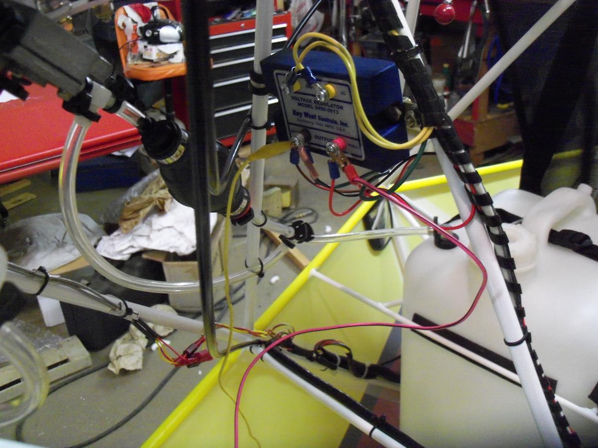

My kit came with the bulb and some tee-'s.
The bulb goes in the main fuel line and you put a tee in before and one
after the bulb. Then run a short piece of hose between the tee's.
In this configuration you have to pinch the bypass line when using the
primer.
The idea was that if the check valve failed and blocked flow through the
bulb the engine could still pull through fuel through the loop.
I was told that there was at least one occurrence of an engine out
caused by an internal failure of the bulb. Maybe more.
There wasn't any discussion of the bulb failing on the outside, but
considering they look like off the shelf primers for boats it wouldn't
surprise me.
The push/pull primers would certainly work but would require using tee's
and pinching the main line while priming as they shut off the flow when
closed and locked. I don't think you could rely on passing fuel through
them for regular flight.
Here is a picture of how it is set up. The original hose was just plain
clear plastic but it was getting hard after a few months so I went to
the snowmobile shop and got some urethane hose which is not clear but
you can still see the fuel inside. It will last a year of two before
needing replacement.
Another option is just plain automotive black rubber fuel hose. Lasts a
lot longer but you can't see the fuel through it.
Stuart
