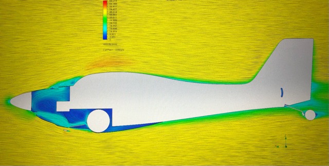

Attached is a rudimentary cross section of free stream air through the forward fuselage voids at 100kt without lower cowl ducting.
From experience flying in a mono with wheel fairing fitted; with ANR switched on at the time there was no detectible change in cabin noise volume compared to flying in 181. However the degree off air flow through the cockpit was greatly multiplied due to the wheel well being mostly sealed off during flight; not fitting the rear portion of the fairing will greatly diminish this ventilation feature.

PostPosted: Mon Mar 27, 2023 12:56 am    Post subject: Considering a few mods. Opinions? Reply with quote
Lower the wheel such that it’s 45-50% exposed. Its too high in your sim. (And would love to see an 8.00 tire)

PostPosted: Mon Mar 27, 2023 2:49 am    Post subject: Re: Considering a few mods. Opinions? Reply with quote
Already reset it to correct position and sizing ages ago; just haven't updated to the latest solution; its going be an arduous procedure with all the fine details now in the mix... i did mention the above sample is rudimentary... 🤷🏼‍♂️

PostPosted: Mon Mar 27, 2023 11:57 am    Post subject: Re: Considering a few mods. Opinions? Reply with quote
Air spilled from the intake duct looks terrible.
I also have the duct open on the lower starboard side of the cowling. I guess that is there for the 914 but I kept it open because it seems to provide some cool air to the oil tank area and rear of the engine. I dare to say it may even augment the flow through the exit a little. My cooling system is working very well so afraid to change anything at this point.
I am planning to remove the gills on the top cowling and make that area smooth. I have them closed right now and it seems to me they probably just add turbulence to the air going over them.
