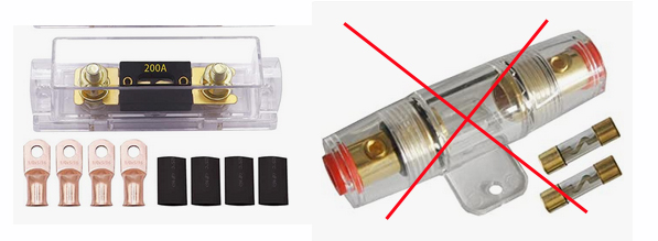

Short answer: No. Any interconnection technology that
depends on threaded devices for CONDUCTION pathway
integrity is to be carefully evaluated for suitability
to task . . . when in doubt . . . don't. But when your
flat surfaces are inseparably forced into gas-tight
togetherness, thread size is not part of the electrical
equation. Note the thread size on this 200A fuse holder.
