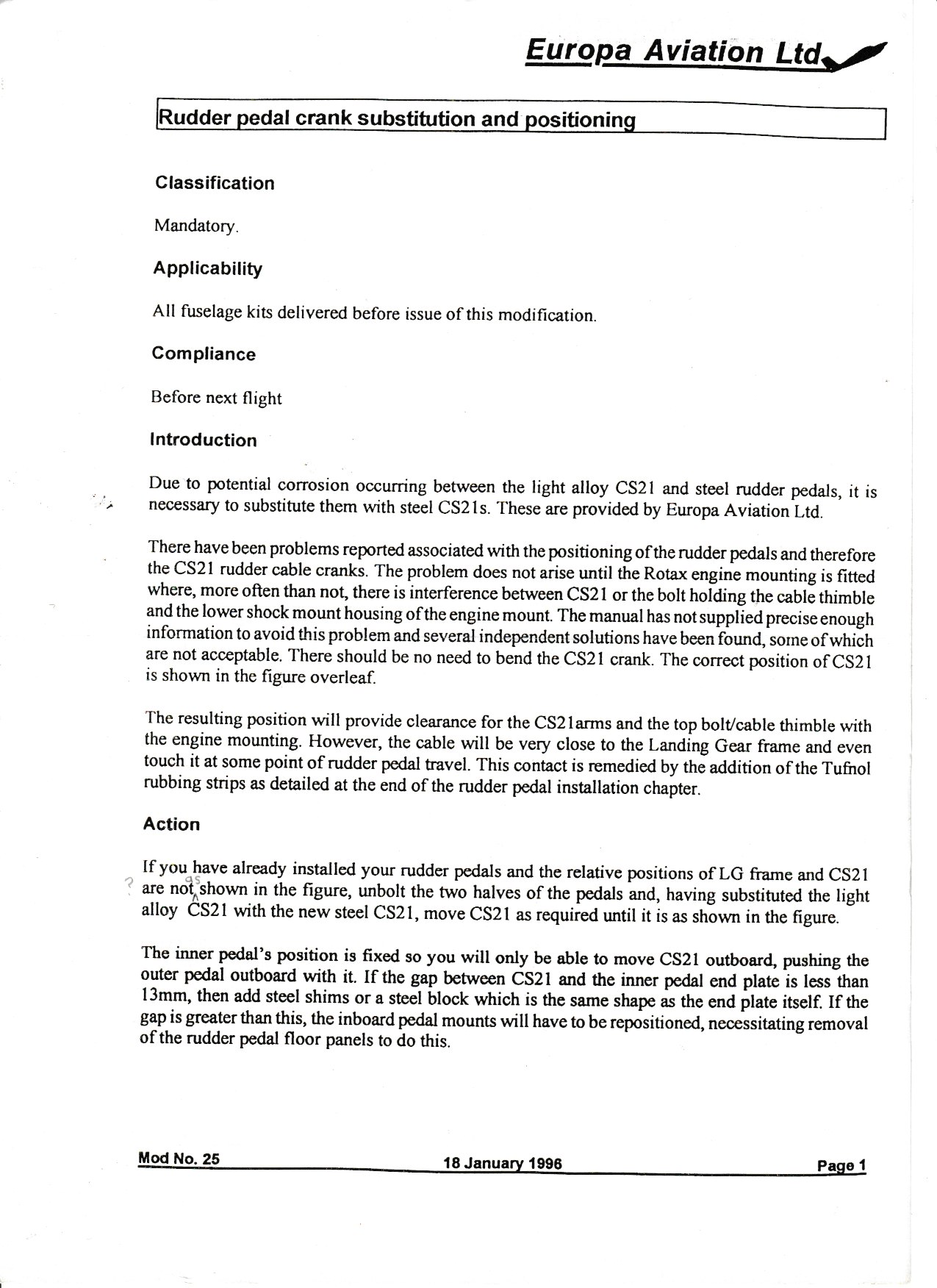

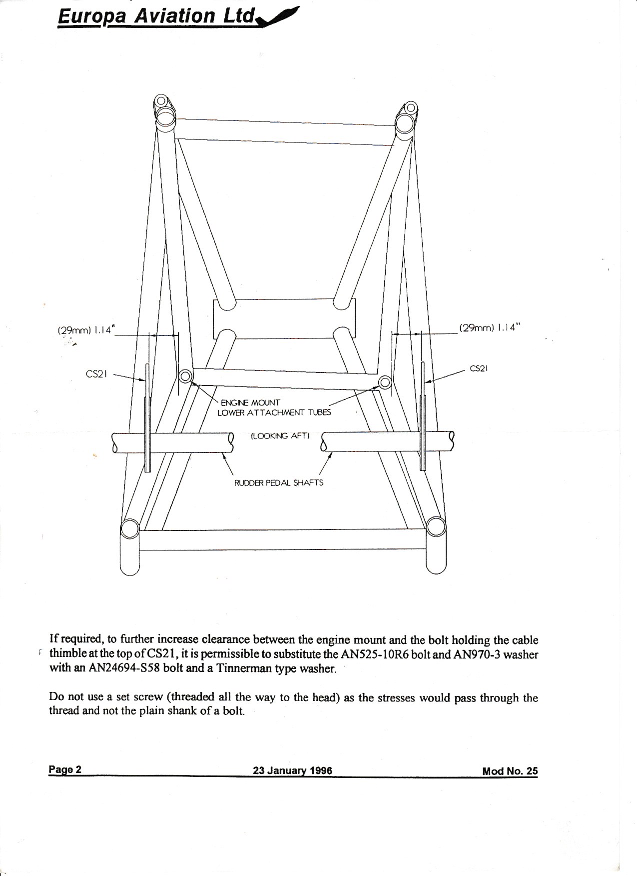

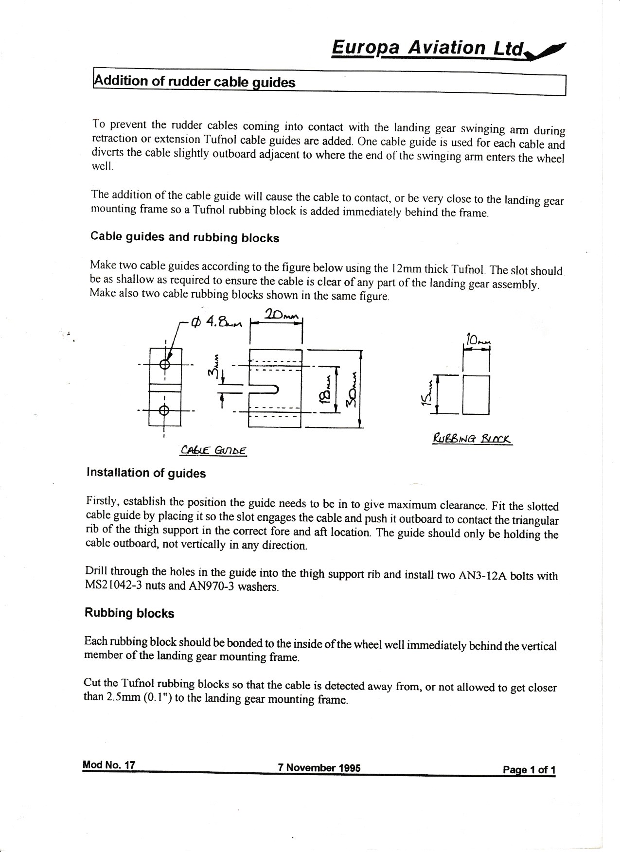

JonathanMilbank
Joined: 14 Apr 2012
Posts: 397
Location: Aberdeen area
PostPosted: Wed Jan 18, 2023 12:21 pm    Post subject: Re: Mod help please Reply with quote
Mods 17 and 25 attached.
 Filesize:  192.82 KB
 Viewed:  8991 Time(s)
 Filesize:  346.52 KB
 Filesize:  302.39 KB
daaza22
Joined: 09 Sep 2020
Posts: 33
PostPosted: Wed Jan 18, 2023 1:02 pm    Post subject: Re: Mod help please Reply with quote
thanks Jonathan thats what I needed ..
What a great response from the Europa group .
Cheers Darren
JonathanMilbank
Joined: 14 Apr 2012
Posts: 397
PostPosted: Wed Jan 18, 2023 1:55 pm    Post subject: Re: Mod help please Reply with quote
The rubbing block ends should be well chamfered, to prevent the cables from snagging beyond the ends of the blocks. This can easily happen when the cables occasionally go slack; most likely on the ground.
daaza22
Joined: 09 Sep 2020
Posts: 33
PostPosted: Wed Jan 18, 2023 2:02 pm    Post subject: Re: Mod help please Reply with quote
good advise ..cheers
