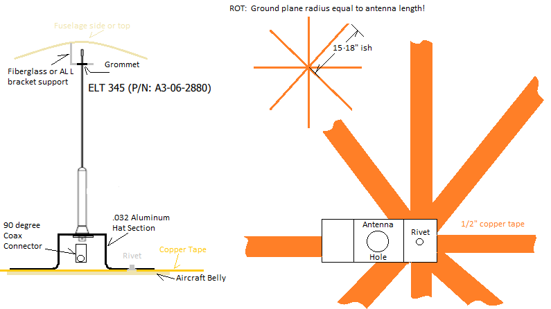

I've installed the ELT antenna a number of ways.
I've installed an AAE carbon fiber antenna with a splitter for a handheld antenna to also connect to for better backup com options. VHF only
I've simply installed the whip antenna with a radial ground plane equal to the antenna length in the rear floor and a small support for the antenna tip to prevent it from making noise.
I've installed a tail mounted dipole unit onto a tail post before finishing (no com antenna near it).
Normally the Artex or now discontinued AmeriKing were mostly installed below the baggage bay for ease of service. It was simple to run a coax to the whip antenna supplied or an AAE carbon antenna. The new 406/121.5 dual frequency whip antenna Artex uses is supposedly good for both frequencies. For VHF 121.5 the ground plane for a quarter wave is 33-36 inches but some do a half 1/4 wave so about 8.5 inches diameter, but I find the signal weak using a handheld vhf on 121.5 using an 8 inch circle alone. Since the Artex 345 is a 15 inch whip antenna a simple 15 inch radius ground plane of 4-8 radials works fine.
I always had to laugh at myself when explaining to a customer that placing the ELT antenna and the com also in the mid fuselage was interesting. As the ELT only works when you crash so who cares about spacing the antennas except for reflection, then if separated by 36 inches, reflection is not an issue. Heck in our composite aircraft I wonder if we could just use the gear leg as part of the dipole. Some smart guy needs to look into that.
Just run a couple of tapes about 30 inches long out from the hat section in the drawing I've attached, and it works. Normally I tack the legs with superglue then lay a thin bit of glass over the fragile copper tape. Some use a copper braid and some just run aluminum strips using aluminum tape but if using tape make sure you remove the glue at the contact points to assure a good ground. If near the side of the fuselage just run the spider web out one side. It still works but is a bit directional. I won't run a radius up the fuselage wall vertically where it can reflect back at the antenna.
We don't know what direction the fuselage will end up in a crash but install the antenna within 20 degrees of vertical and near the fuselage centerline or the inspector will die of a heart attack.

My ELT is an EBC 302 121.5 and 243.0 VHF/UHF Easy to install but the alkaline battery is expensive and can corrode destroying the unit. Replacement for a 406 model is prohibitively expensive.

I once read why these ELT manufacturers tell you you must use their antenna or else. It's just that the ELT was certified to meet TSO when tested with their antenna so if you want it to remain TSO then it is required that you use their antenna. But I am with the camp that any antenna of the correct frequency is OK.

Will,
The radiation pattern of a vertical antenna is omni-directional. That is why they specify vertical. Satellites will "see" the ELT as the satellite comes over the horizon. Of course, this all assumes the wreckage comes to rest with the antenna still vertical!

…and its still attached……or the elt has a second internal antenna, like the Kanada.
