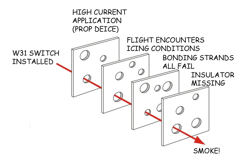

There was a HUGE kerfuffle at Beech during my tenure
there concerning failures of W31 series switch-breakers
in Bonanzas and Barons. These ships used W31 switch
breakers for ALL of pilot operated switches.
It seems that SOMETIME during the Beech incorporation
of these breakers, a change was made that removed
a tiny bit of insulating material from under a
spring.
This was a new layer of 'swiss cheese' in the
potential for generating a hazardous condition.
Here are documents I've saved from the work
product I generated for the failure investigation.
https://tinyurl.com/2zttqpqt
I thought I had a copy of the failure analysis
narrative but that seems not to be in the library.
Nonetheless, it seems that failure of all the jumper
'cable' strands preceded loading the spring with
the current being carried in the switch. For light
loads, this didn't seem to generate an alarming
event. ONE of these switches in the Bonanza carried
prop de-ice current. This switch would not be a
high duty cycle device . . . none the less, one
fielded aircraft suffered a failure of jumper
strands followed by a catastrophic heating event
in the spring that resulted in much smoke and
bad smells in the cockpit.
So . . . lots of slices of cheese had to line up
to bring this difficulty to the forefront. But given
that there were probably 80,000 switches out there
in Beech products (Not to mention Cessnas too), This
was not a trivial concern . . . ESPECIALLY since
the existence of the insulator could not be
verified by inspection.
So, the short answer to your question is: "Probably
no big deal. All new switches have the insulator."
HOWEVER, keep in mind that when the pilot control
device is combined with the fault protection for that
branch, ship's BUS structure is extended to the
hot side of each control . . . not unlike the special
hat dance we do for the 5A crowbar breaker in fuseblock
fitted airplanes.
  fitted airplanes.
