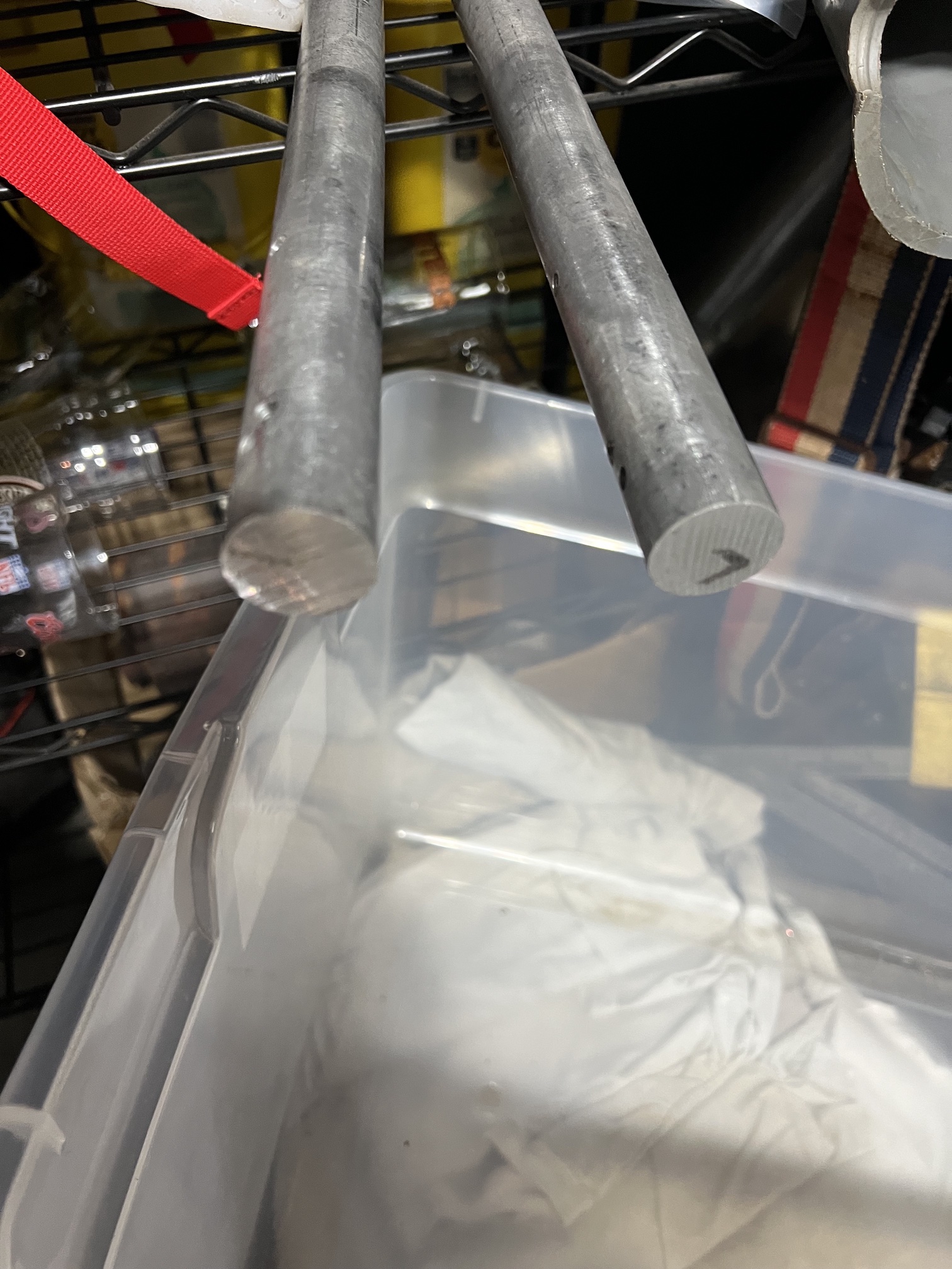

I've been on the phone for about an hour with Kolb, trying to validate that I have a KXP based on gear leg diameter. They have confirmed the model, ut think my gear legs are sleeved.

My Firestar ll had sleeved gear legs. Although I think that the sleeve
wasn't very thick. Why don't you use a set of calipers and measure the
inside dia.

Original Firestar legs were 1" solid 7075 aluminum rod with a aluminum sleeve, probably .65.
The original Twinstar used 1 1/8" solid rod, no sleeve.

Need to correct .65 to .065".

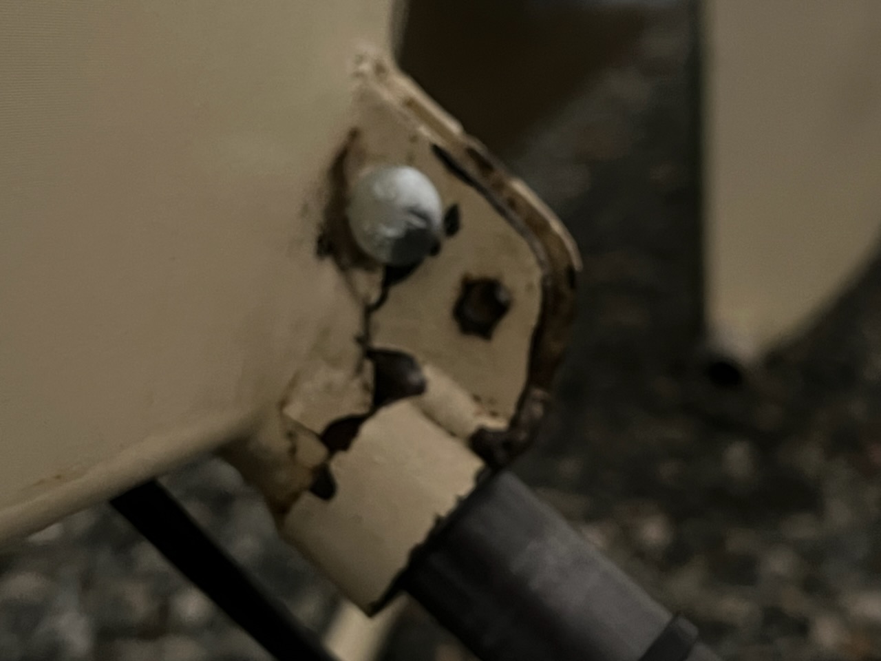

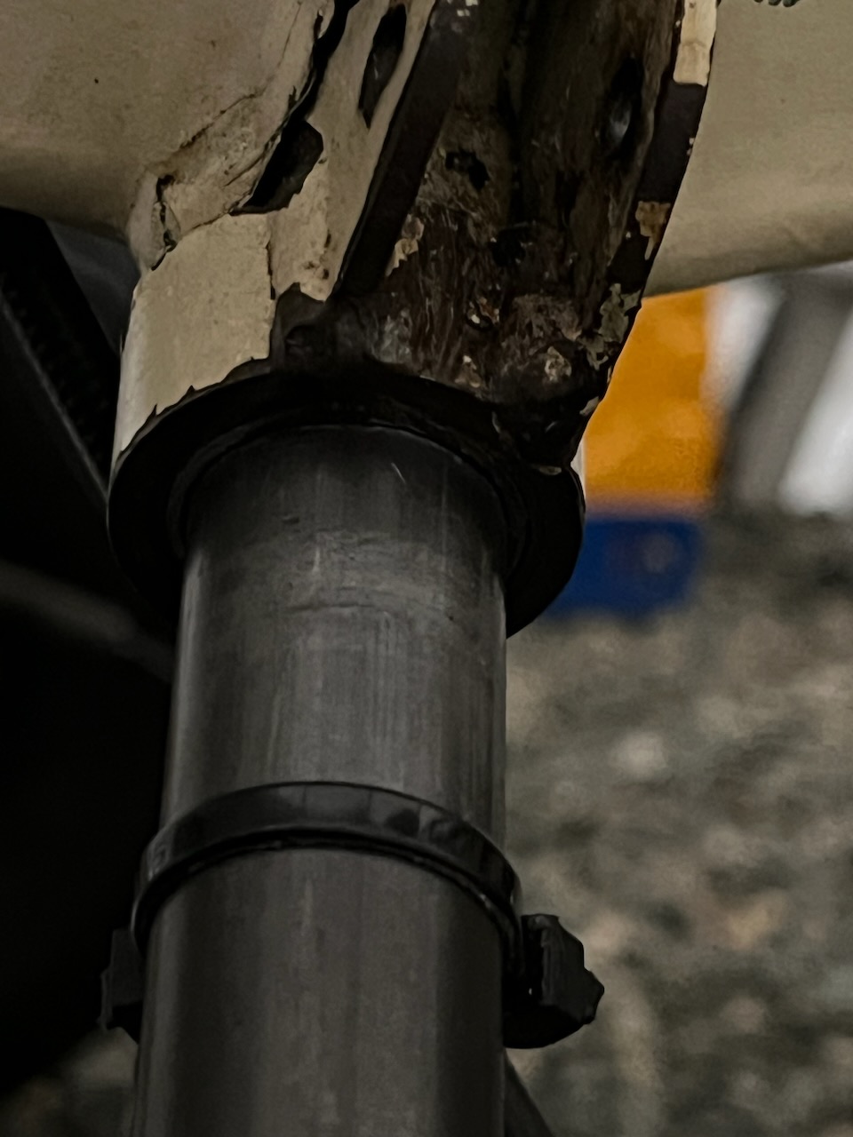

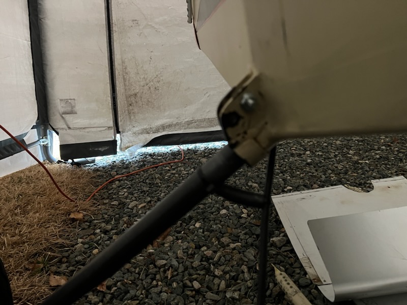

here are some pictures that I took today. the attached gear are solid chromoly custom made ones and the fuselage side looks like there is a clamp system, but its not. the picture is of the original aluminum legs and also 1" dia...same as the chromoly ones.
