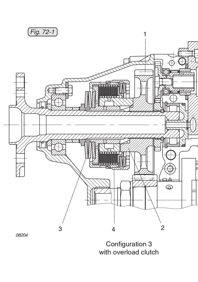

Which preload spring set are we talking about here? set 3 or 4? image attached...
To be honest this is a subject matter that appears to have been hotly debated for ever; its just not worth waisting any more valuable time upon.
"parts require periodic replacement when beyond manufacturer specified serviceable limits, period"...
Just replace the part and enjoy flying the aircraft... cheaper to replace dog or slipper clutch than an entire engine... couldn't care less if and when it requires replacement.
Would rather use my time to grow a fresh pumpkin than redesign a perfectly functioning wheel...

peterz(at)zutrasoft.com
PostPosted: Mon Dec 26, 2022 4:02 pm    Post subject: What did you do with your europa this week - 22/12/22 Reply with quote
Set 3 is for the dogs to set the (resonance damping) friction and to define the ramp torque and is in-play in flight. Set 4 is for the overload clutch to set its breakaway torque and never comes into play in flight, but rather only when the dogs have hit their compression stops to save the splines from deformation (which can occur with heavy props at start and stop or kickback).

Indeed, once resonance does take hold, the energy which must be dissipated quickly destroys rubber donuts. This is the reason that rotax only got away with them on two strokes which have trivial reverse torque pulses. Automotive applications are a different paradigm altogether as the ground presents an infinite damping load reducing the frequencies involved vs a free air propellor although the analogue does still exist: the situation when a student manual transmission driver pops the clutch at idle and the car lurches back and forth with increasing amplitude until it either stalls (a good thing) or something breaks.
In aircraft applications, the lightly loaded and under damped (in air) propellor mass can quickly increase the positive feedback resonance amplitude and thus power in the system until things break or the mechanical wear (dogs for example) becomes destructive (creating exasperating dog-pockets for example). All at low power input settings by definition. Give full power and the air provides sufficient damping load to avoid positive feedback resonance - and why this phenomenon is not seen in marine drives (water is a terrific damping medium). The very efficient slippery europa design feeds into this problem vs those draggy bush plane applications.
Auto conversions with simplistic rubber dampers (read: viking) are inadequate imho…and time will tell as fleet time builds. The sprague solution in the yamaha/teal world are already seeing excessive low time field failures - as predicted by that website i had quoted.
Fwiw,
Cheers,
PeteZ
On Dec 27, 2022, at 8:27 AM, JohnFrance <77alembert(at)gmail.com> wrote:
I agree about the donuts, my triumph GT6 Mk2 had them on the drive shafts.
I also know someone who used them on his ultralight which used a car diesel engine. When it failed he lost drive to the prop and the forced landing totalled the aircraft. That may be why Rotax didn’t use them in the gearbox.
A very interesting thread this one all the same.

Thanks Peter great explanation there; and yes donuts are great but when they break and when they do everything shakes to pieces real fast. So in an aircraft not a great idea for prop drive; it would require some variant which i will try out when a dead gearbox gets donated.
