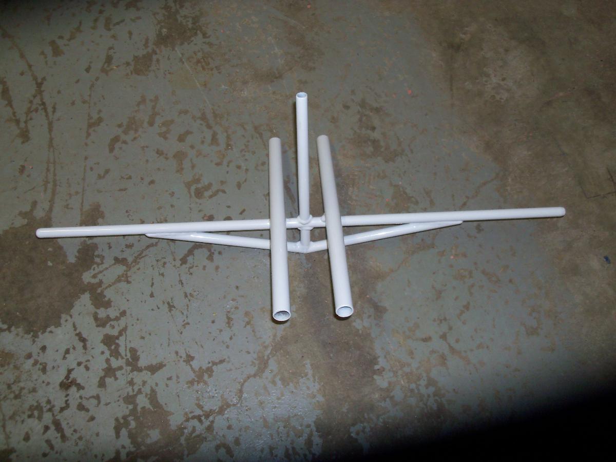

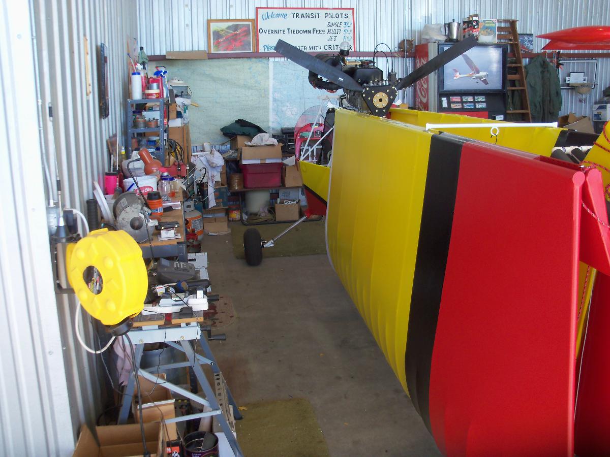

On the Firefly, for folded condition there is a support bracket that goes into a hole through the tail boom. This bracket has rods that stick out to the side and there is a whole in the wing with internal support. You slide the wing onto the bracket when folded. There is another bracket that goes in the rear spar that holds the wings together while on the support bracket. I usually run a bungee between these brackets just to make sure it doesn't bounce off while folded.
The first picture is the boom bracket. It is upside down on the floor. The vertical pin goes all the way through the tail boom.
