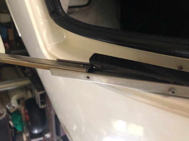

Hi Ron, thanks for your request regarding door warping... to be straight up its not an issue i have time to sit and examine; my time is constantly truly limited.
The CAD testing calls for a non dynamic testing algorithm which will not be accurate enough to be useful to anybody due to so many variables; and that is the b&w of what you are asking.
Cardboard is your best friend (and a pencil and some basic map charting tools) ; draw your solution and proof it on paper first using a pencil and circles; i think thats how your passive pin system works? (See attached basic sketch)... its going to be a solution of two arcs; the swing of the door frame and shape of the pin and its parking gate. If you can get it to work with paper stencils then it will work in situ. CAD will not provide you any better result or magic solution. All CAD will provide you is the ability to record and replicate; that's the only magic CAD will ever provide anybody. Personally from my quick sketch i don't think it is a practical solution but more of a band aid for a greater upstream affect; i could be totally wrong and often am.
The issue is not really safety related, which is my focus. It does hold some aerodynamic qualities there, and the simple solution "is" strengthen the door frame sufficiently at the time of production.

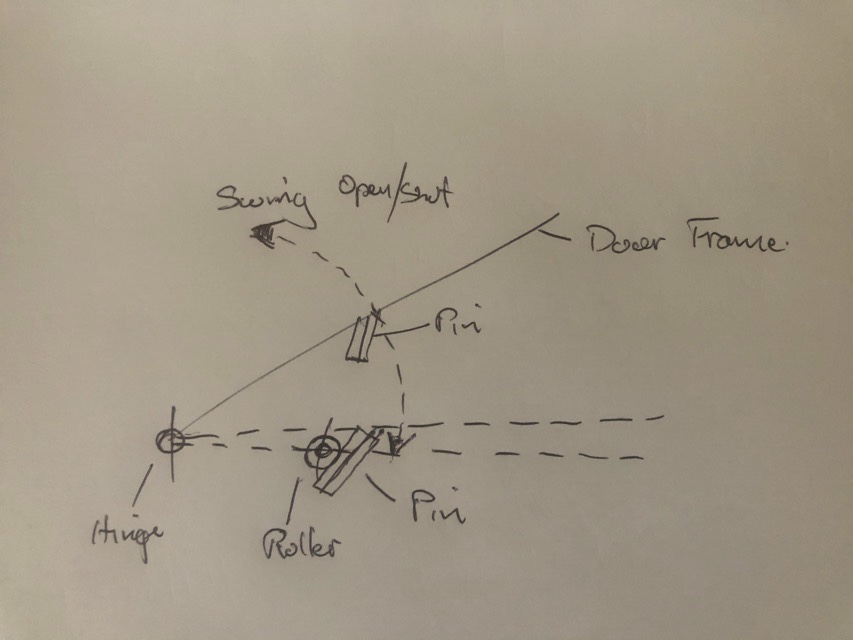

Thanks for that suggestion A51.
My passive pin attempt had too much friction but the roller idea is a great one that I might try.

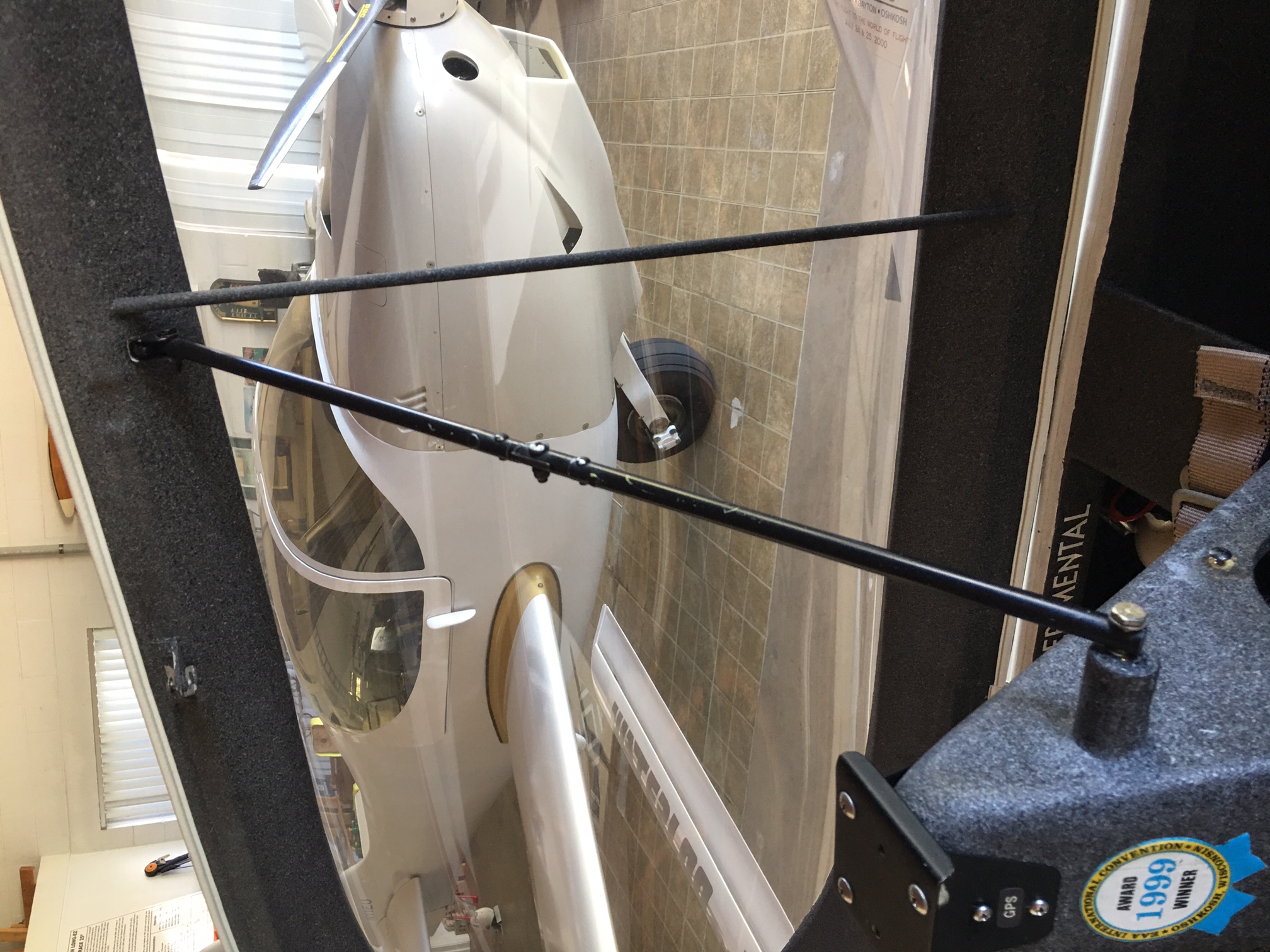

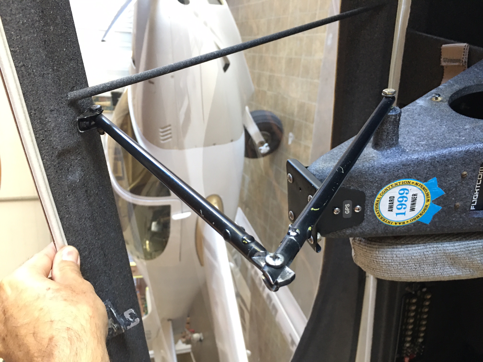

Interesting thread.
My LongEZ has a simple scissor type with over-center locking bar to keep the canopy open. In the LEZ case the latch only moves 90° were in ours it needs to go 180° but it should not be too hard to modify.
Simple and works well. The canopy doesn't slam down on your head as it happens on my EU once in awhile (I actually taxi with the door partially closed held open with a small foam block).
