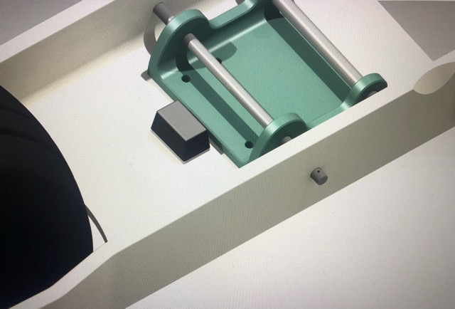

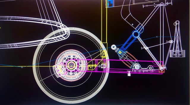

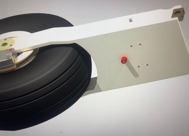

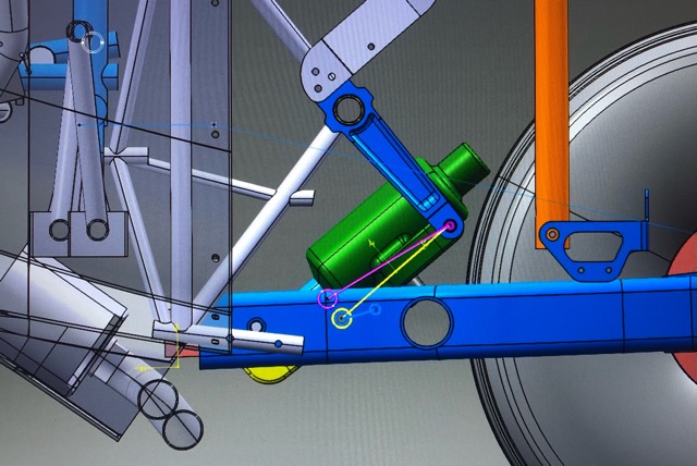

PostPosted: Sat Dec 03, 2022 6:49 am    Post subject: The Obsidian File - Mono Undercarriage Reply with quote

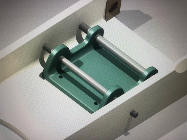

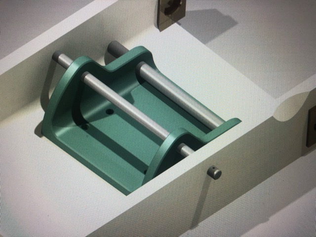

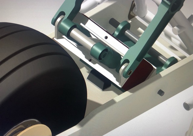

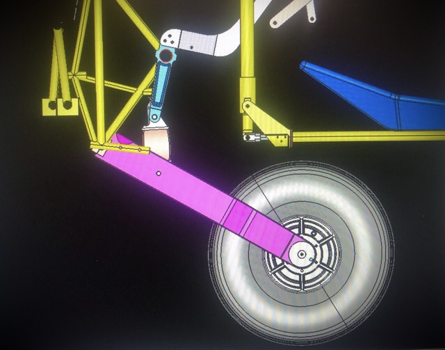

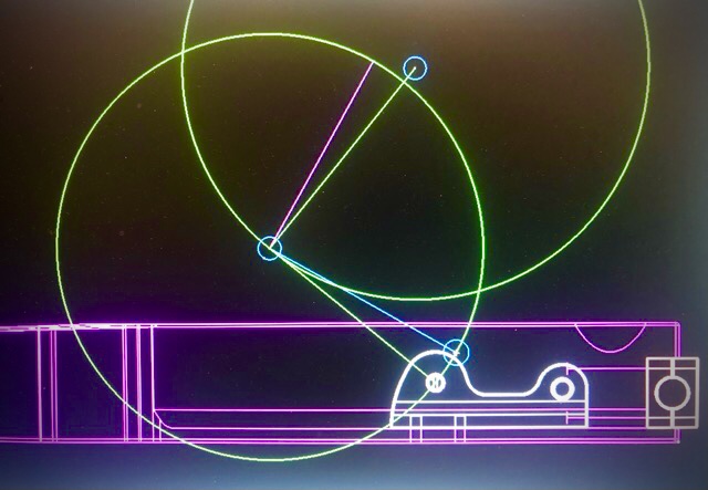

With the 3D aero model now complete its onto a new chapter as mechanical and ancillaries come into the fore; and fruit has arrived straight off the get go.
After reading and hearing about so many issues regarding the mono retract the first thing that has been focused upon is the undercarriage. Having the model available now provides the ability to try things out and get answers almost instantly. So that's exactly what happened as soon as the remaining components of the assembly were drafted and imported into the picture today.
The first goto was undercarriage action; why does it jam closed on some aircraft? Why is it so difficult to retract when throwing that final bit of the lever forward? It was interesting what showed up! An initial earlier solution drafted last year was quickly thrown in the bin but it was this study that revealed where the issue actually now resided.
Having the 3D CAD components assembled allowed a study of the geometry of the retractable assembly, and sure enough it was so very possible to jam the undercarriage in the retracted position; and was remarkably easy to affect; literally just a mm or two beyond the gate stop on the console did it and the wheel was stuck fast in the tunnel void.
It was instantly apparent that the only way this could geometrically be possible is if one of the mechanical arms has moved passed a point to rest within a 90deg quadrant. So that's where the focus went to and thats what was quickly flushed out... the rubber block assembly had crossed over and was resting at 80deg to the swing of its upstream link. And there it was, with the only thing preventing jamming in situ now being the weight of the main wheel overcoming the tension of the bungee spring... Its the very same reason causing that last bit of retract throw on the cockpit lever being difficult; and perhaps the very same reason some owners simply tighten up the bungee spring to get things to park up. (The attached geometry image shows the factory positioning at the blue circles, the magenta line being the 90deg quadrant marker relative to pin LG04's position, the blue line represents the rubber block assembly, and the relative green line LG08).
So gee what to do? ?? Well what if things get realigned to their respective 90deg quadrant? The numbers indicate nothing will alter at the cockpit lever position... worth a go; what's required? Rotate a single pivot point on its radius 10deg and revision of LG02A... So that's what got drafted out and presto, problem instantly gone away to the graveyard of great ideas... Amazing!!! Took all of five minutes to solve on the 2D and another 10 to draft up a new 3D functional component and check for clashing and binding.
With pin LG04's position at LG02A now rotated 10deg on the spring blocks arc it is now geometrically impossible to jam the undercarriage; even if the main wheel somehow finds its way up through the tunnel ceiling to the instrument panel facia; which it now can do if the lever is moved beyond its gated travel, which has remained unchanged.
So that's it, MOD-XX... Done!
Fitting of LG02A-XX and reboring of LG02 for LG04's amended position, being 150mm horizontal and 7mm vertical from the datum centre bore of LG03.
The other attached images show the difference between LG02A and LG02A-XX; the position of the bungee pin on LG02-XX has also been raised a few mm for better operational clearance... LG08 also received a slight mod to become one manufactured component instead of two.
So can somebody please explain what the bungee spring actually does??? I cannot find or identify a practical mechanical reason for it at all other than to overcome the existing geometry error; unless this perceived error is intentional?
Thanks for reading everything; well done!

PostPosted: Sat Dec 03, 2022 8:45 am    Post subject: The Obsidian File - Mono Undercarriage Reply with quote
Fwiw, my experience:
1- difficulty in getting the gear into to and out of the up-gate (regardless of bungy tension) was due to the flap rod adjustment being too short, causing the flaps to top-out, restricting the gear up travel.
2- general binding of the swing-arm was due to a bent gear/engine frame pivot tube. Bent due to having been side loaded when the gear was in the down position, an angle where that tube is totally unbraced/supported. I suspect many frames in the field are bent. The builder of my bird had actually shimmed the arm bushing to accommodate and reduce the binding (band aid solution). When repairing my frame, i added a truss to the frame at the correct angle to support the tube and prevent any future bending.
3- the bungee is simply to assist the pilot in raising the gear. I tensioned mine such that it pulls the gear up about 60% when doing the gear swing test. I find that with this tension my gear takes minimal effort over its entire swing range in flight.
PeteZ

PostPosted: Sat Dec 03, 2022 7:06 pm    Post subject: Re: The Obsidian File - Mono Undercarriage Reply with quote
Nice solution Peter; what gauge tubing has been used there?

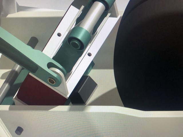

Area-51
Joined: 03 May 2021
Posts: 439

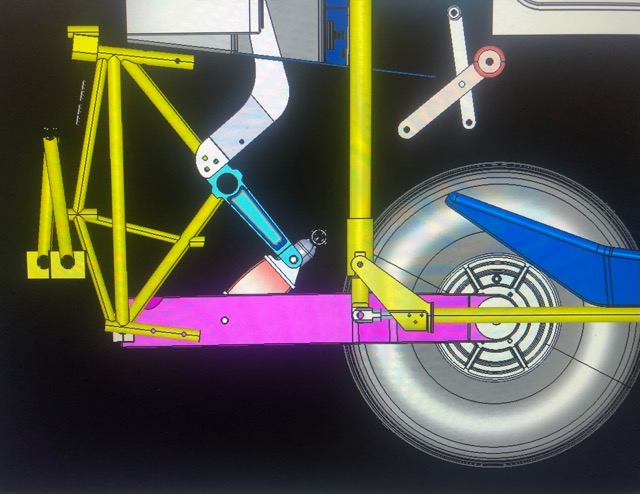

PostPosted: Sat Dec 03, 2022 9:26 pm    Post subject: Re: The Obsidian File - Mono Undercarriage Reply with quote
Some further thoughts today upon this.
With a focus toward keeping things as simple as possible a fast solution to more easily employ was brought in after a discussion with another Europian... The latest mod employs a buffer stop mounted on LG02 to prevent the undercarriage raising too far up into the tunnel and the rubber block assembly reaching the geometric locking position. The height of the buffer can be altered by placing washers under its base thus adjusting the parking position of LG02.
The nut fixing the buffer to LG02 has been given the function of a jacking pin for security and safety purposes.
Some photos included.

PostPosted: Sun Dec 04, 2022 2:51 am    Post subject: Re: The Obsidian File - Mono Undercarriage Reply with quote
This is an interesting subject.
The question is asked what the bungee actually does. I replaced my bungee a couple of years ago and did some retractions without it (aircraft jacked in the hangar so no aerodynamic assistance). It was bloody hard work to retract without the bungee. When I installed the new bungee it had 1 extra loop and was tensioned a lot more than the one I removed. The gear is now really easy to operate both in the air and in the hangar!
I'm not quite sure I agree with your overcentre analysis. I am one of the few who have done a wheel up landing (not because I forgot, but don't ask how it happened). After the landing the gear was really easy to lower despite the fact that it had gone right up into the tunnel with the wheel contacting the throttle lever and the brake caliper severing a rudder cable. With the wheel going this far up, wouldn't your overcentre case be realised?
On another topic, I really like your 3D modelling. I have produced a Solidworks 3D model for the fuselage frame by taking measurements and reverse engineering it. I'm doing this for a new conventional gear design I'm working on. I would love to compare my model with yours, what software are you using for your modelling and how are you going about it?

PostPosted: Sun Dec 04, 2022 4:25 am    Post subject: The Obsidian File - Mono Undercarriage Reply with quote
5/8x0.035”
On Dec 3, 2022, at 10:13 PM, Area-51 <goldsteinindustrial(at)gmail.com> wrote:

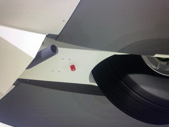

PostPosted: Sun Dec 04, 2022 7:20 am    Post subject: Re: The Obsidian File - Mono Undercarriage Reply with quote
Today repositioning of the brake caliper was given a quick review after string lining in the rudder cables; and it revealed that John had indeed flipped the classic tailwheel block upside down to gain better cable alignment... a moment force study was also commenced on yesterday's mod to LG02A to determine the affect at the operator handle end of the situation; will have to run the same test again on the current setup to compare.

My thoughts about altering the retraction geometry; If I’ve got it right, your proposal is to move the bottom pivot (the LG8 pin) forward a bit, albeit on an arc. My uneducated opinion is that may well reduce the amount of over-centre of the down-lock geometry to a critically small amount that could lead to the undercarriage unlocking and collapsing. The amount of over-centre is quite small anyway; the centre pivot should be 1/16” to 1/8” forward of a line between the top & bottom pivots. If it’s less than 1/16”the over-centre lock will be dangerously weak and at risk of unlocking whereas if it’s any more than 1/8” too much load will be put on the frame, running the risk of frame damage. IMHO the original design was developed for very good reasons and does not need messing around with! If it’s built correctly and if it’s then maintained correctly it should not fail.
G-TERN
Area-51
Joined: 03 May 2021
Posts: 439
PostPosted: Sun Dec 04, 2022 3:52 pm    Post subject: Re: The Obsidian File - Mono Undercarriage Reply with quote
Jon, thanks for your thoughts there however needs correcting..
Position of LG08 components are not altered; the over center locking affect on extension is actually marginally improved.
Pin LG04 is moved slightly rearward and down upon its arc, relative to the opposite pivot point at LG08. This keeps the rubber spring block assembly outside of a 90deg arc from LG08 when retracted. If things here cross over less than 90deg they can jam in the retracted position if the bungee is too tight.
Apart for preventing a possible lock up in the retracted position the operation of the landing gear is otherwise unchanged. Moving the position of LG04 adds mechanical advantage at the final end of retraction; which the bungee currently provides.
The addition of a sacrificial $1.75 buffer prevents retracting of the undercarriage too far into a possible lock up position. The above repositioning of pin LG04 is helpful but not required... with washer and nylock nut the $1.75 buffer is now probably $2.30. The shortened and filed tube nut for the jacking pin probably brings things to $2.50 but i could be wrong...

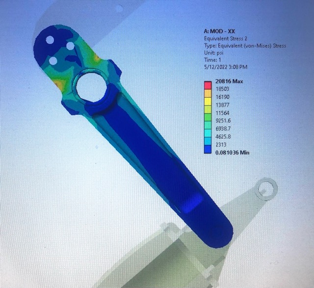

Area-51
Joined: 03 May 2021
Posts: 439

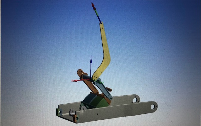

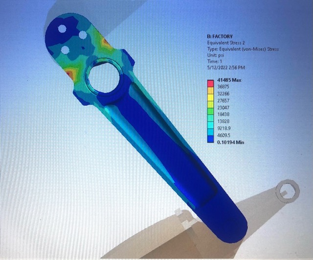

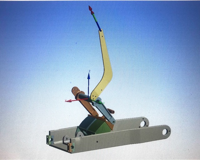

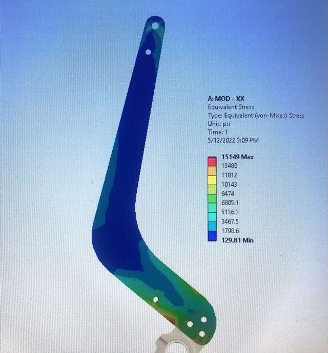

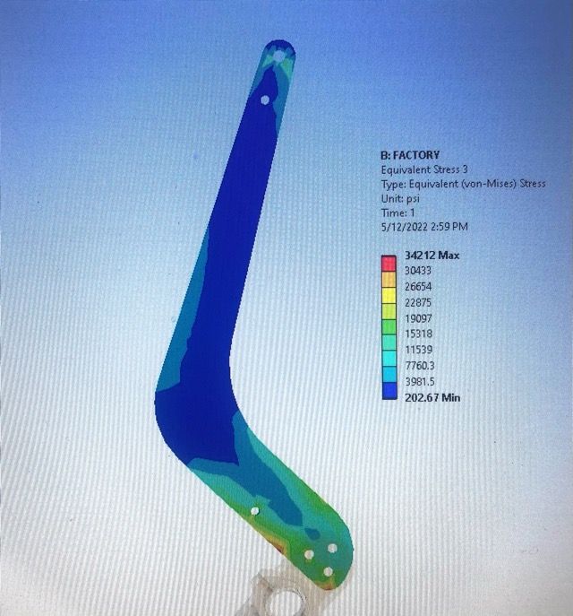

PostPosted: Sun Dec 04, 2022 10:54 pm    Post subject: Re: The Obsidian File - Mono Undercarriage Reply with quote
Today the numbers on mod-xx were run through the trap. Short story 50% reduction in component stress and force required at the operator end.
Both factory and mod-xx had the same parameters applied along with a gravity to factor in the torque of the swing arm's mass. LG12 undercarriage lever has been modelled using 4.0mm 1020 sheet steel. LG02 and LG08 have been supplemented with 6061-T6; the rubber spring block has also been supplemented with 6061-T6 for simplification of the model and approximation of mass factor.
At close out of the undercarriage retraction (the final point of retraction) the factory setup delivered a 30200 Nm moment from LG08's axis to the operator handle while mod-xx delivered 13600 Nm.
Force required in the X direction (forward moving) at the operator handle for the factory setup was 700 N while mod-xx required 320 N.
Tension force required at the bungee to reach zero mass balance of the LG02 undercarriage arm assembly upon its swing axis was 860 N.
The assembly model received a vertical force of 100 N at the main wheel axle line along with a gravity factor of 1.. bungee tension was not added to either test model.
Altering the position of LG04 10deg upon its radius centroid to its opposite axis at LG08 was causal to the change in measured affects.
This concludes this part of this Obsidian File chapter to further discussion.
Images included for the technically minded.

Any aircraft undercarriage or mechanical item for that matter will fail if impacted with enough force; damage to the mono undercarriage from excessive side loaded touchdowns can be mitigated by several ways; one being thought about this afternoon may find its way into the chapter shortly... or be relegated to the graveyard of great ideas.
Keep in mind the undercarriage will not lock up if the bungee tension is less than required to hold the undercarriage above its parked position; the weight of the wheel and gravity is what brings the assembly out of this scenario each time, however the force needed to close out the undercarriage remains constant. The force required to action the undercarriage through the retraction stage is not the same.
The concepts being presented are failsafe engineered to prevent certain situational scenarios occurring.
Somebody mentioned about the operational over center specification; this is an adjustable setting that needs to be maintained regardless.
Dave upstream there asked about how I go about doing this and what software is used... great to hear you are building a model; wishing you well with that! Regarding software; they all provide the same result; buttons are often in different places, same as politicians and beer... I use a few very special ancient tools that few these days know exactly what they each do... A piece of string is the most highly valued, next is a plumb bob, a spirit level but i have been known to use a glass of water during desperate moments, cardboard (cardboard is your best friend), protractor, calipers, a roll of masking tape, good even lighting, a clean floor, a sharp pencil, a blunt pencil, a white board marker, a rheem of plain A4 paper, an adhoc laser pointer on an adjustable tripod, a ruler and tape measure, lots and lots and lots and then some more time, lots of coffee hamburgers, about 30,000 hrs playing CAD, and about 45years of analytical experience.
The model here has taken about 300 hours to measure and a further 1100 to accurately model from the data collected.

PostPosted: Fri Jan 24, 2025 5:12 am    Post subject: Re: The Obsidian File - Mono Undercarriage Reply with quote
An additional image explaining the "over centre" aspect of the factory undercarriage retraction geometry and why it is a challenge to get the last bit of retraction achieved.
The purple indicates the lower factory pivot position of the spring block. The yellow indicates the revised pivot position that prevents an undercarriage lockup scenario and achieves full mechanical advantage of the retraction mechanism.

Nice work Area-51.
Here’s my take on the purpose of the bungee; to assist both the retract and extension of the swing arm. I am still flying with the original bungee some 25 years after first installing it. I have re-tensioned it a couple of times over the years. The issue I am currently experiencing, which is driving me to the change out the bungee this year, is the gear extension. Once the gear retraction lever is free of the up gate I have to be very careful not to let the gear free fall and slam into the down gate. Now, my flaps are decoupled from the outriggers, so I don’t have the airloads to deal with.
As noted by you and others, the last bit of up travel requires the most effort. My technique is to pitch the plane forward just as I approach the up gate. The pitching moment really helps get the landing gear retraction lever into the gate. To lower the gear I perform the same action. A slight push on the stick and the lever advances forward rising off of the up gate stop, making it easy to deflect the lever out of the gate to lower the gear. I just need to keep a firm grip on the lever to keep the gear from free falling.

Thanks Erich; thats some useful information as you have disconnected your flaps from the circuit; i am still using the original factory setup on 181 which is still working fine.... nice job on the oil tank heater mod too!

Erich,
On first flying the mono wheel we found the last bit of up travel required a great effort and it also took a firm push to unlock. On suspending the aircraft so that we could check out the operation, we found the flaps were pressing hard against the sides of the fuselage as they reached the up position. Trimming each flap root by 1/8 in / 3 mm removed this interference and allowed easy operation of the gear both up and down.
I regard stiff operation of the gear as a distraction in flight and therefore a safety hazard, so I urge anyone experiencing this problem to carry out a retraction test to search for the cause – it may not be the flap interference, but whatever the reason it should be possible to work on the system so that it operates smoothly without difficulty. If the action appears stiffer with the wings on than when they are off this provides a good clue as to where the problem lies. So
