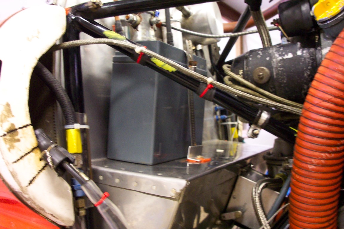

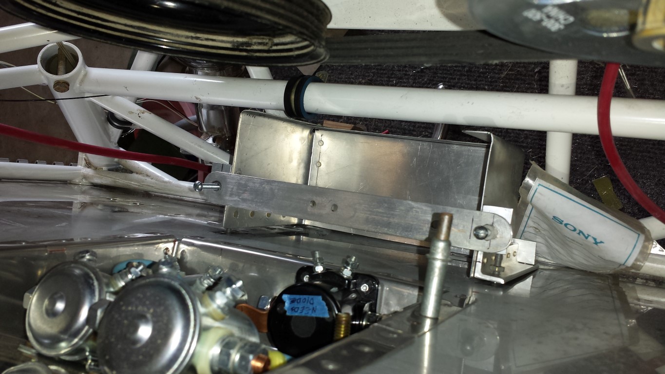

I'd start in my scrap aluminum bin. Wink Here's what I did for a firewall mount on my RV7 project. There's a 3/4x3/4x1/8 angle running under the bottom of the tray. The other pic shows my previous RV4's battery installation. Since its firewall has a 'step', I simply set the battery on the conveniently provided shelf and used a long stainless hose clamp to hold it down. Note that the -4 spent quite a bit of time in, shall we say, unusual attitudes. Because these batteries only vent when horribly abused, if yours is inside the fuselage all that should be required is at most something around the base to keep it from shifting sideways (can be short sections of light weight angle) and a strap over the top to hold it down.
