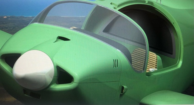

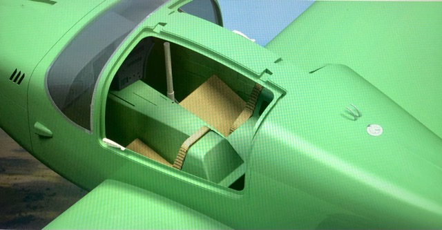

More flight time in the digital tube... door frames are finally done and installed; starting to look like a finished aircraft... Doors should be a fairly fast process now with all the root surfaces having been drafted... enough modelled data now to run some aero analysis on a twin departed door scenario. So far this task has been the most challenging to resolve and has been almost 100% sequential spline and surface development all the way through eight complete rebuild iterations. In comparison the instrument panel took just three complete iterations to resolve and was in itself an epic journey.
