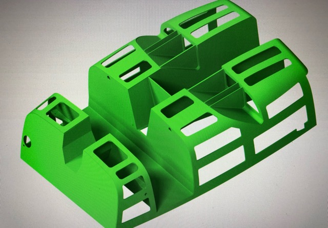

PostPosted: Tue Nov 08, 2022 6:38 pm    Post subject: What did you do with your Europa this week - 08/11/22 Reply with quote
Very exciting and intense sessions at the design table all week... finished off modelling the instrument panel and interior cabin environment; adding takeoffs for fixings and control lever slots... the sticks and pedals are in along with the spaceframe... next up are the doors... the Rotax 912, 914, and 915 are all sitting there waiting to be popped in when the time comes... will move onto the rear section shortly to add the control surface mechanicals... its hours and hours of arduous and rewarding work.... learning a lot about the aircraft through the process.
 Filesize:  86.56 KB
 Viewed:  5124 Time(s)

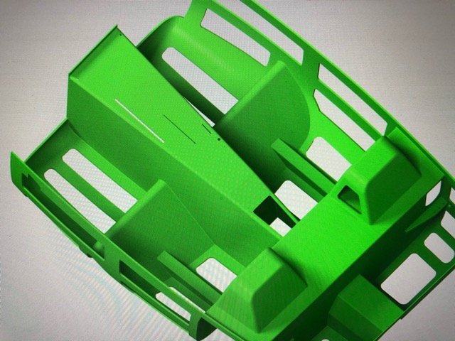

PostPosted: Wed Nov 09, 2022 6:47 am    Post subject: Re: What did you do with your Europa this week - 08/11/22 Reply with quote
Agree; there are better options available offering more power with less mass up front.
Some fun for a change today, getting creative adding a few hundred grams of rigidity with an upgrade to the cockpit interface.... with the empennage shelling completed shortly will very quickly be able to re-assess the airframe in carbon construction.
 Filesize:  99.73 KB
 Viewed:  5101 Time(s)
 Filesize:  85.58 KB
 Viewed:  5099 Time(s)

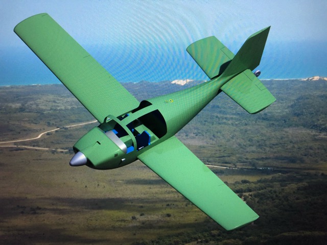

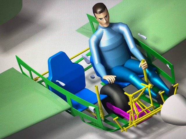

PostPosted: Wed Nov 09, 2022 8:30 am    Post subject: Re: What did you do with your Europa this week - 08/11/22 Reply with quote
Meet Lars... he is a software analyst from Hölstebro and will soon be certified to operate the undercarriage lever on his own and receive a retract rated endorsement!
Lars has only recently taken up flying on weekends, and also likes fishing for trout and going for romantic walks on the northern ice shelf to watch the pretty lights.
Being still quite new to flying Lars has a very low degree of situational awareness and prefers watching the blue dot on his ipad screen...
 Filesize:  94.32 KB
 Viewed:  5094 Time(s)
