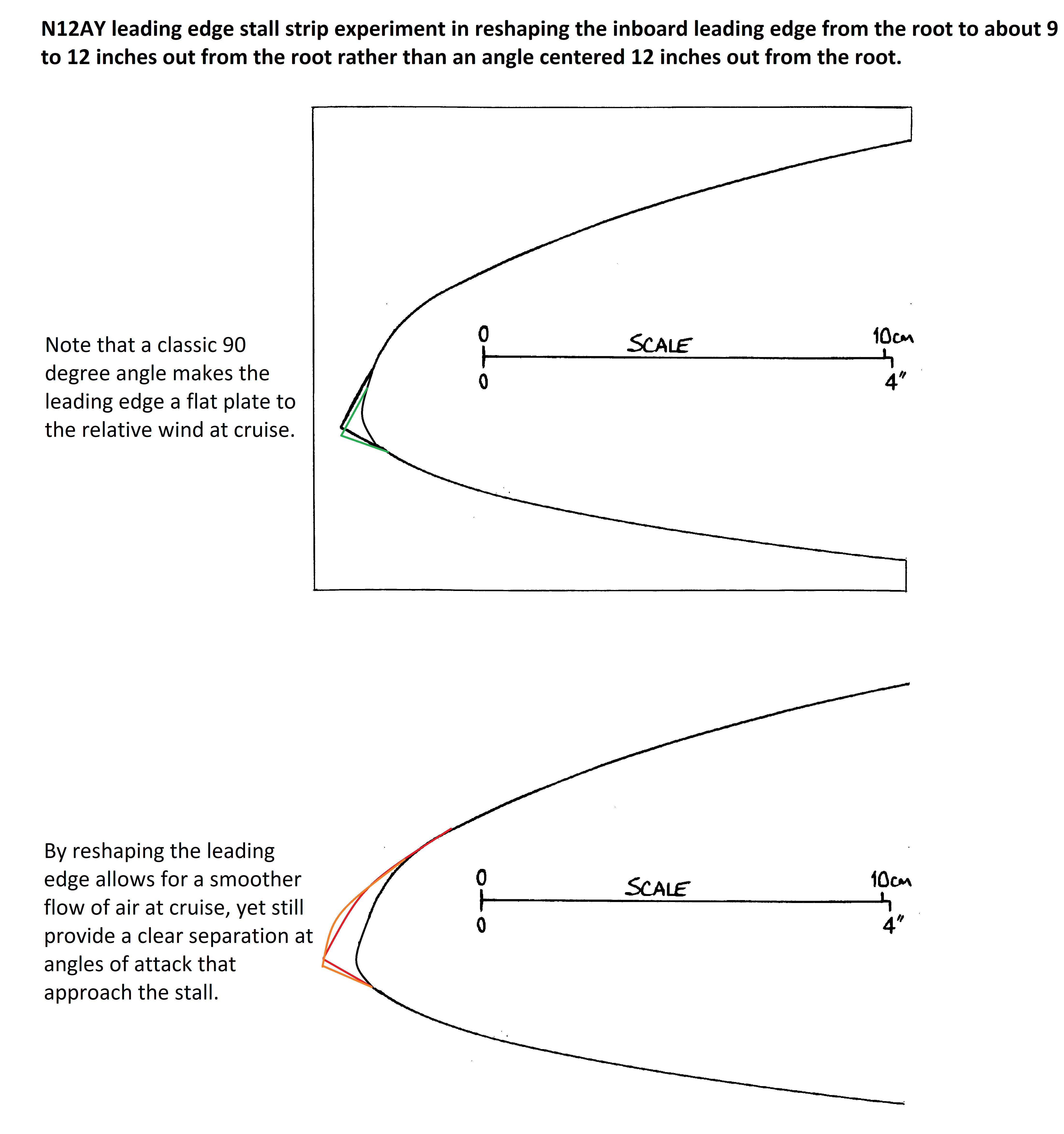

I've attached a paper I did on my Classic N12AY but never published it "Stall Warning types for the Europa". Because the wings on a Classic can be a bit out of shape, some aircraft have a bit of a wing drop. Some don't. Even the XS wings may exhibit a wing drop due to rig and or incidence differences. Initially I only toyed with leading edge stall strips once I flew N12AY as it flew very well and stalls were OK but wing drop was not uncommon. The stall strips made the aircraft stall warning more pronounced but it took me a few flights to get them tuned. I found my stall break became more predictable. See the addendum added on my stall strip work paper at the bottom of "Stall Warning types for the Europa".
I have installed a stall warning system similar to the Mod 61 (same basic components but different install yet similar) and it works perfectly which cost me about $50 USD. I added a silence button for slow flight noise reduction/distraction and now I am modifying it (as I always do) to now include an intercom voice warning from the Airbus and a self test for a lot of research time and about $50 more of cheap Chinese components. I find that I can't hear the horn with my headset on in flight. I can't help but to tinker. I've attached another pdf of what I've done so far for my Classic (Stall Warning System Upgrade 2022) on that. Great fun, fairly cheap, but tedious time-consuming work.
Finally, I'll attach some drawings of how I moved and modified my stall strips in a picture format as well as my Classic plumbing of it.

In this thread we discuss stall strips. These stall strips are simply an aerodynamic gimmick that when properly installed will give airframe warning and perhaps correct wing drop or other aerodynamic nuisance for the pilot that is inattentive or otherwise distracted. The stall strip is virtually free, requires no electricity, should not diminish performance, should be easy to install and position. Anyone flying the aircraft would note the airframe buffet, and normally would take preventative action to avoid a stall, especially at low altitude.
Electric warning devices are great today, they can be fine tuned and are relatively inexpensive. They do require setup, construction, wire running, and can fail, but they give another visual or audio warning of approaching the stall. Today our EFIS has warning indicators built into the display (for those who aren’t looking outside the cockpit) and an audio warning into the headset and or a warning horn for those inattentively looking outside.
I personally like an aural warning of low speed and high angle if maneuvering while looking outside the aircraft. Unfortunately, with the advent of ANR and superior soundproofing of headsets, it is difficult to hear some warning horns (even the reed type squeakers like in a Cessna 150/162/172/etc. are often missed by pilots). In that case we add a warning light, but the sun angle can make that difficult to see. So, we put the warning horn, voice, beeper into the intercom headset to assure the pilot gets the message: you’re approaching a critical AoA (stall). The nonelectrical simple stall strip adds a comfortable rumble about 5 knots above the stall. Almost all pilots are in tune to the feel of the aircraft. If it starts to buffet and shake, one should unload, recover, and glance in the cockpit and find out what the problem is. I don't know a pilot that is not in tune to aircraft vibration.
Finally, not all aircraft have a comfortable stall. Rig, build issues, and incidence angles can cause a slight roll or even a loss of lateral control approaching the stall. Stall strips applied properly can adjust the stall break.
Usually, I frown on doing stall strips to correct a stall. I prefer to fix the wing. However, the reason for the Europa POH stall strip is there to give an aerodynamic warning to the pilot. It is cheap, requires no electrics, but is a bit time consuming to install and test. I find the stall strip enjoyable for a warning to pilots checking out that have a tendency to round out high and attempt to try to catch the aircraft as it sinks (what I called the falling leaf approach to landing in other papers). Without the stall strips I have to send them around. I also find them useful when doing an extremely minimum roll approach and landing over an obstacle in gusty conditions. As I cross the threshold, I find I can arrest the rate of descent and adjust power simply by feel of the aircraft rumble just beginning whereas without the stall strips I’m watching the airspeed and frankly landing a bit faster lengthening the float and rollout. (I do admit I can land slower without the stall strip by a couple of knots with practice.)

That is why I made my stall strips, tested them and then painted and removed them. It only takes a minute and some tape to put them on but like you and most others, we get used to our aircraft and don't install them as it is just more testing. I like tinkering and I prefer an airplane with a pre-stall rumble warning so I took the time to make them.  Other pilots flying with me like the rumble and stall warner combo to use as a point to recover/slow flight at.
On some Europa's with a forward CG and built light I can do a full aft stick (deep) stall without the stall strips but it is rare.  With stall strips, I can coax a full aft stick stall in many of them. But there is no need to do a full aft stick stall in reality. It is a confidence maneuver in some aircraft to demonstrate coordination, rudder control, and aircraft capability. There is no need for doing that in a light aircraft, but some Europa's can do it. There is no need to ever do it beyond flight test again unless trying to ascertain if a damage repair is done acceptably. Other than that...It’s a Worthless Maneuver which done improperly can result in an out of control situation. Be at least three mistakes high when doing any stalls or aggressive maneuvering.
Mostly I like the gentle rumble during a clean hard turn, warning me of too much pull (AoA) in an airplane. With the stall strips I find N12AY with full flaps doesn't give me 5 knots of pre-stall warning but three with the stall strips, and the stall speed is 2 knots faster with plenty of warning. It also tends to drop the left wing in the fully configured stall unless I add in a bit more rudder. Without the stall strips the left wing drop is a little more pronounced but with proper rudder control I can make it bobble up and down somewhat violently as I get to full aft stick in a heavy buffet (the buffet without the strips is heavy and is a bit scary). With the stall strips, it simply rumbles lightly, mushes and has a much less pronounced bobble. With the stall strips, 12AY will break before you can achieve full aft stick. Maybe I'll work on that during this winters annual if I get bored. Of course, it is not broke, so why fix it.
