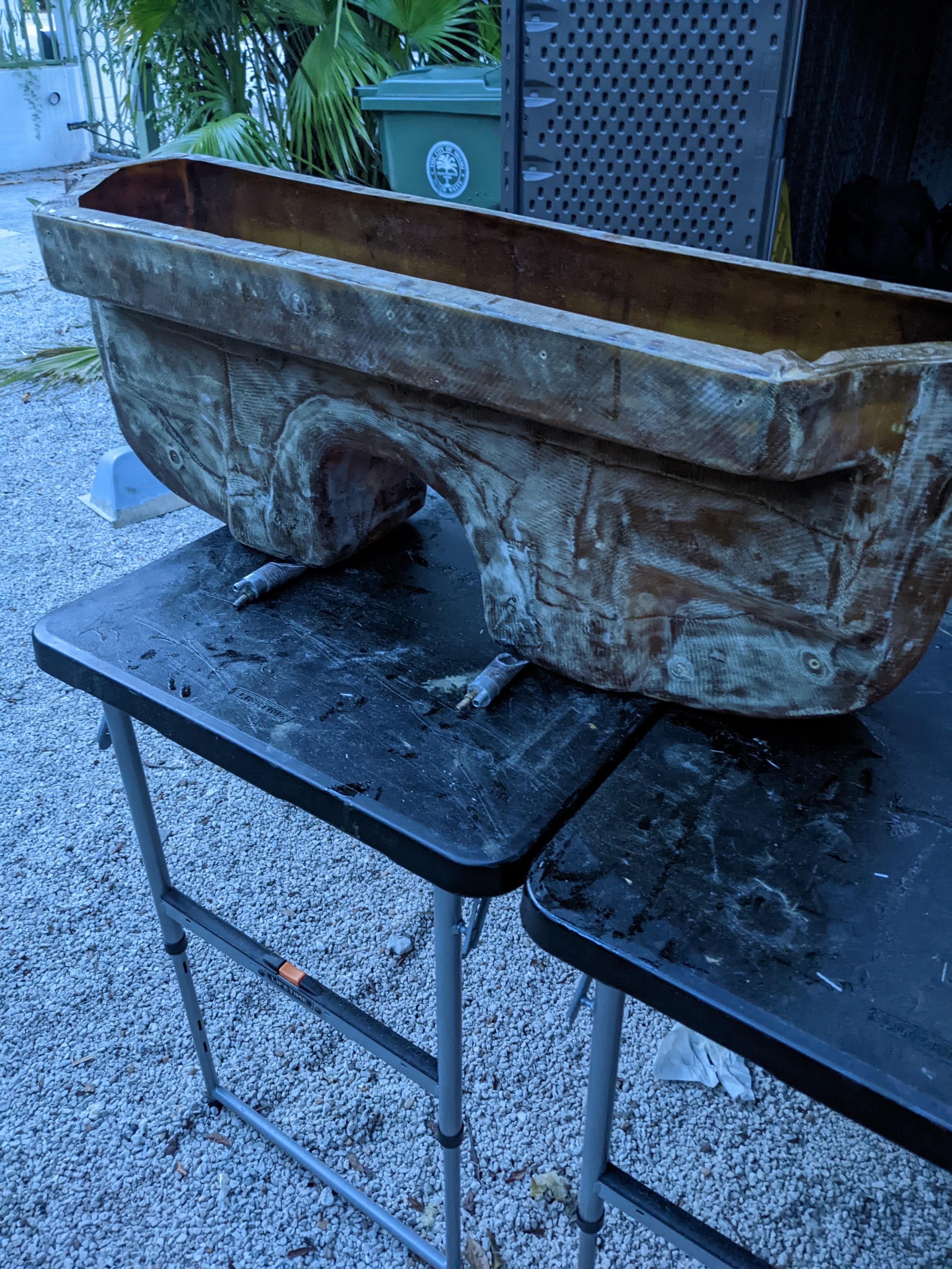

Light at the end of the tunnel.
This is not for the faint of heart.  That said it was made considerably worse by doing it in Florida summer, on a full day's work I lost about 5 lbs.
  1. I originally planned to make front and back and then the base/sides and glue it all together.  This is impossible.
  2. I then did what I should have done in the first place and made a plug of XPS.  Sounds easy when said like that but oh boy.  Getting the plug out was a nightmare despite (supposed) release tape.  lesson learned:  make the plug hollow.  Front and back and then build the sides so that you can break out the plug without effort.
  3. I used EZ Poxy and Rutan cloth.
  4. I glassed the inside with three layers.   It is quite heavy, I am guessing maybe 50% more than the original,   (can anyone send me the weight of a plastic tank ?) but very solid.  However I guess it will crack in the case of a crash.
  5. This tank holds 15 gals.   5 gals up to the top of the "hump",  5 gals up to the bottom of the shelf and 5 gals in the shelf.   I could have made it a bit bigger but it fist in the door sills.
  6. I have decided to go with the original outlet fittings so that I can inspect the finger strainers as part of the annual.  I have heard of fiberglass tanks shedding.  The fiberglass outlets for the fittings will be floxed/glassed in place.  I will use the original 1" hose arrangement to hold the aluminium outlets in place.
  7. Filler is next.
  8. I am putting an inspection hatch in the top.

I will measure my tank's weight this monday.... if you haven't received the number by then.

I just weighed my bare tank, 6.390 Kg or 14.07 pounds.

Wow, that is quite the job Will. The good news is that at the end you will have a tank that will last you a lifetime. Hopefully!
Talking about composite tanks, and just out of coincidence, I asked GAMI about the compatibility of their new G100UL fuel with composite tanks. They replied that they have tested their fuel in the Cirrus and no problem. But who knows if their fuel has similar nasties as auto go-go pee.
For sure it ain't going to have Vodka in it.
Looking forward to hearing about your experience with this. Did you make drawings of the plug to share?
