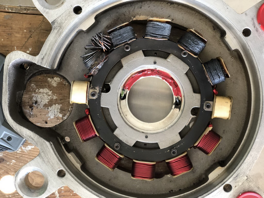

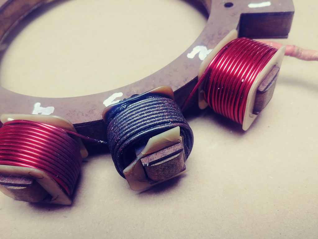

Another noteworthy feature of the failures I've
observed concerns the CONCENTRATION of overstress.
I've never personally encountered failed stator
on a rotating machine that did not present
uniform evidence of destruction over all
stator poles carrying that path of copper. We
see one such example in attached photo.
Some Revmaster alternators have tossed in the towel
after having toasted only one pole winding leaving
pristine poles on either side. But even the
illustration of total winding failure shows
one pole with much more damage than the rest.
I've seen assertions on the 'net describing
any combination of failures from single
pole to all poles.
It would be a real challenge to duplicate
a condition that replicates such a failure.
I'm reasonably certain that NO stress OUTSIDE
the alternator could produce such damage. Hence,
root cause is likely confined to INSIDE the
alternator.

Increasing air flow is job 1, wrt cooling this stator. Impregnating the wiring is an improvement that I advocate but do not have data on it. My direct conversation with the stator wire manufacturer, and their recommendation suggests to me it would be an improvement.
Did they quantify 'improvement'?
To quote a rather intelligent fellow of some years past:
Can you measure it? Can you express it in figures?
Can you make a model of it? If not, your theory
is apt to be based more upon imagination than upon
knowledge. === Lord Kelvin ===

It's evident that the unusual localized heating that
we've seen (and you show in the attachment) is suggestive
of a very unusual heat source.
Precisely
I don't think there is any other power source other than the battery,
available to cause so much damage as we see on some of these stators.
It also might explain a single coil buring up. As you've often brought up,
an open wire will melt at a spot somewhere in the middle.

for copper creates a potential failure
location with heat energy fed from both
directions exacerbated by increase
in resistance.
It may well be that one winding on the
stator is singled out by a temperature
condition much higher than adjacent
poles but given the heat-sinking effect
of the stator iron, a melts-in-the-center
effect seems unlikely.
I'm still fond of the notion that faileded
windings get a thermal boost NOT from
I(squared)R losses in the wire but from
Eddy current losses in the iron on which
the wire is wound.
Has anyone ran a short circuit test on a multi-coil stator
like this? Would it not make some sense that one isolated
coil could go through the rapid rise in resistance and burn
up before the rest?
Not able to wrap my head around this idea.
I'm still thinking root cause is in the
poorly crafted magnetics. External forces
such as system loads and style of regulator
are secondary and much less influential.
out of that stuff?"
