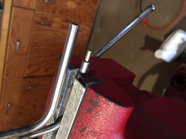

I fixed mine and ready for Saturday breakfast.
In my case I broke the static tip in the hangar and the piece was embedded in my skull so no need to make a new tip (well, just kidding, the piece was in the floor).
The fix was simple, the ID of the tip was exactly 1/8". Just ordered a hobby grade 1/8" OD brass tube, cut a small section and press fit into what is left of the plastic tip inside the pitot tube assembly and then press fit the black tip making sure not to block the holes. I did add a drop of CA glue but probably not doing anything. It is nice and tight though.
I wholeheartedly agree with Bud in that it would be wise to have a spare of some kind or make it easy to vent to the cockpit. One day I experimented with venting inside the cockpit and did not notice a difference with the outside vent.
