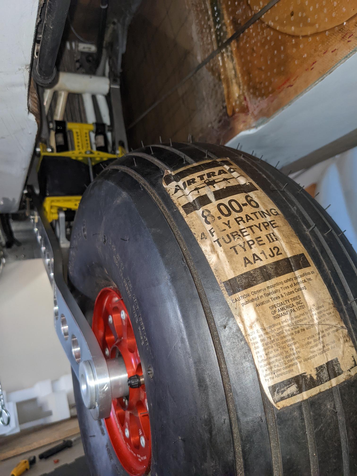

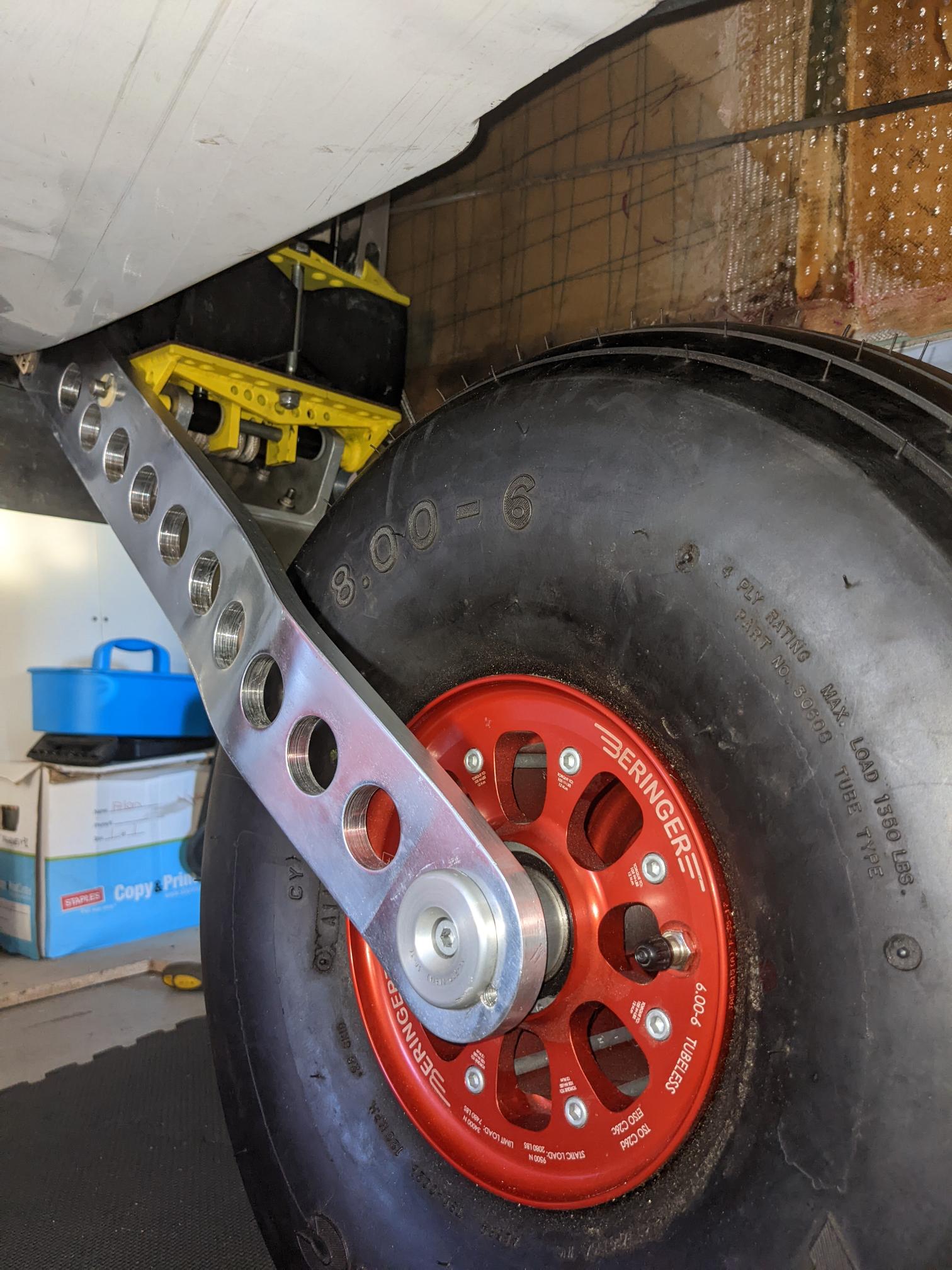

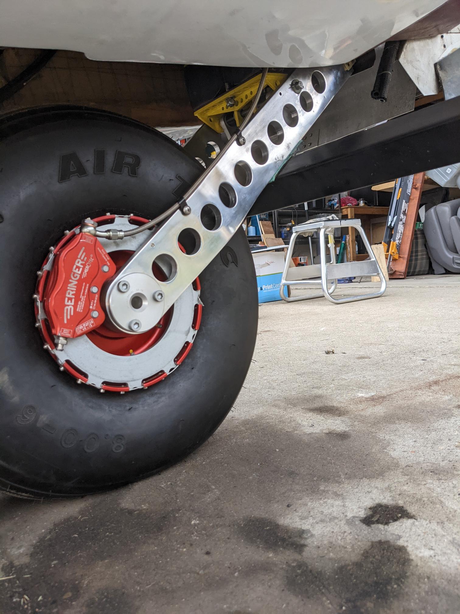

It was Pet Z who asked if the 800-6 Airtrac was a good fit on the Europa. Some said not good but here are a few photos of my installation and clearance looks just fine. 1/2" taller than a 700-6 Airtrac and 1" wider. Note the Beringer brake disk is more than twice as thick as the stock Europa disk, as well two piston caliper. Very nice brake

Looks the goods on the maingear upgrade... did you happen to weigh the new wheel before fitting? The factory europa unit weighs a ton!! Am thinking of fitting this mod...

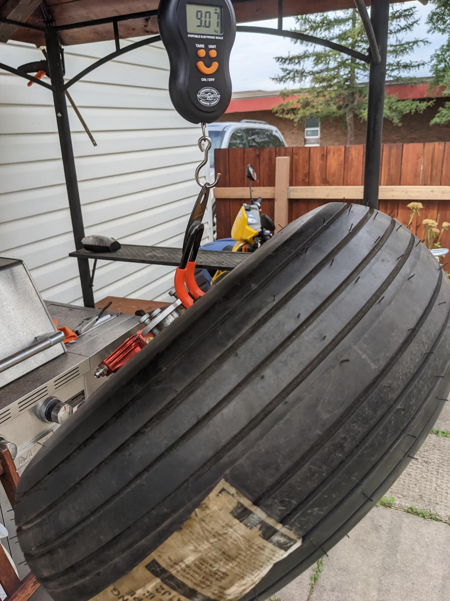

Hello to those who want details of the weight..19.99Lbs. 9.07 Kg. for the wheel tire and all brake parts bolts included. One could save .7 Lbs with a Airtrac 700-6 tire. This weight from this digital luggage scale was double checked with digital bathroom scale and both agree.
The 1 1/4" holes in the swingarm flange saved 1 1/4 lbs. a few holes in the damper bracket saved 1/2 lbs. The new damper pair save .9 lbs. I may go back to the factory damper as mine both work though one seeped a little oil. Will decide if the new dampers please me.
