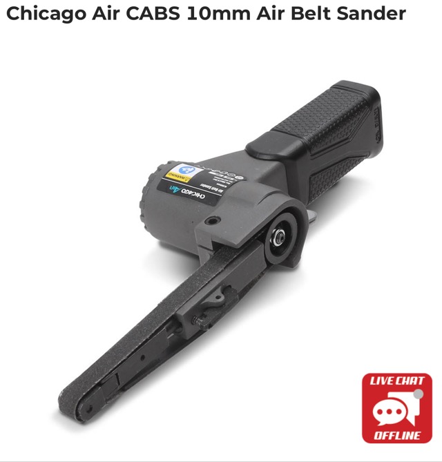

PostPosted: Sat Aug 06, 2022 12:46 am    Post subject: Re: replacing acrylic window Reply with quote
Hi Fred, from experience i would invest in a mini belt sander and practice on some timber until you get the hang of it using one of your hand positions to maintain position and pressure and the other to move the tool in a linear direction (invest in a mid range unit, the bearings are better quality). Depending on how much material you are wanting to remove the belts are available from 80grit down to 800grit... 80grit will tear through panel steel and welds without batting an eyelid... for softer materials like composites 240g to 400g belts will probably be sufficient; if you want a real smooth surface with bonding strength you could finish to 800g... start with the lower grit numbers and really get a good handle on technique; you won't need very much pressure and be aware the belt can sometimes pull into the surface if your attention is distracted, regulate your speed, start slow and as you get more confident you can open up the trigger a bit more. Old surfboard would be good to practice on... And make sure to use a good 3M cartridge respirator.
The other option i might consider is a mini hand held router with a some kind of guide set up on the door frame; this would provide an even depth along the glass recess and you would have a lot more control over cutting depth... not quite sure what would provide a sufficient guide; you'd want at least a 1/4" height guide off the door surface i think; maybe MDF or architect's plywood.
 Filesize:  56.73 KB
 Viewed:  7520 Time(s)
