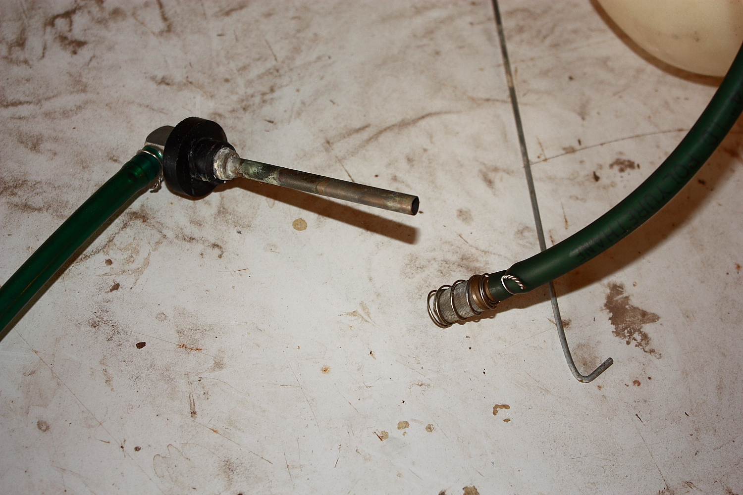

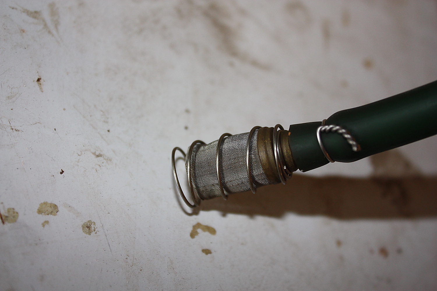

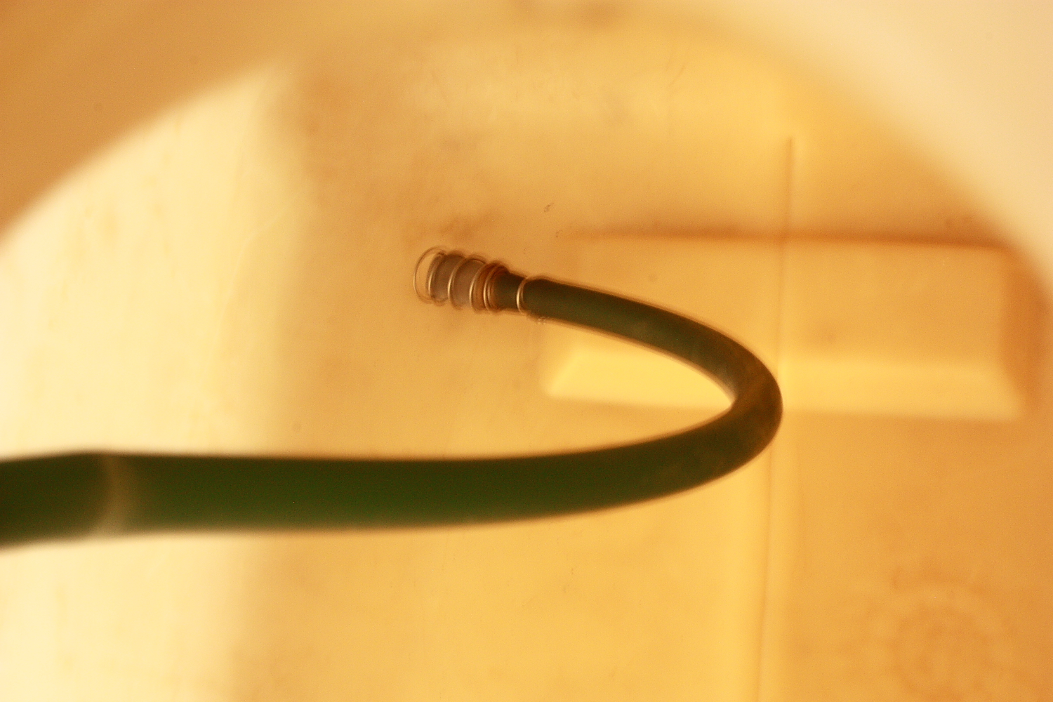

gas pickup tube in tank
This is the set up that I used for my tanks. Rather than have a fixed tube, I choose to use a flexible gas tubing with a filter that could move with the fuel yet keep crud out of it and allow me to get every ounce of fuel out of the tank. Has worked for me since 1996.

One thing I would do different would be to use a high grade automotive rubber fuel line for the flex line that is inside the tank to the pickup.
Back when I first built my MKIII, I modded the fuel tank area so I could use two 6 gallon boat tanks, and used the best available green plastic tubing down to the pickup.
When I built a 15 gallon tank for the center section, I ended up using the two boat tanks to go to the gas station and get/store fuel.
Last spring I noticed that one of the original plastic lines had broken off and was laying in the bottom of the tank. Granted, that original fuel line install was a long time ago, but still - ya can't beat real fuel line.
