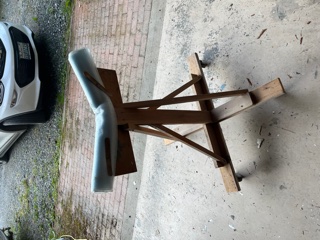

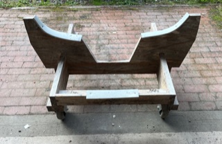

Sorry James…no drawings available…AND…I replacd that particular “fuselage stand” with one where the casters were somewhat further apart (about 30”) for increased stability…my stands were just made up of bits of wood lying around…nothing special except for the curved cradle which matched the lower portion of the firewall…the notch in the center allows the LG to lower and retract. I did spend a few bucks for 4 decent caster-wheels. Here are a couple of pixs of the latter and a little stand to support the tail so fuselage was level.
[img]cid:C299942B-3369-4217-BA84-AFF7E2D3DCF5[/img]
[img]cid:E3AADC7A-33DC-43E3-968D-BFFE29A6AD77[/img]
[img]cid:4EAA543F-9C08-4163-BBBC-707BF732DF08[/img]
[img]cid:72834D62-4AE7-494E-82ED-883F73A3E511[/img]
