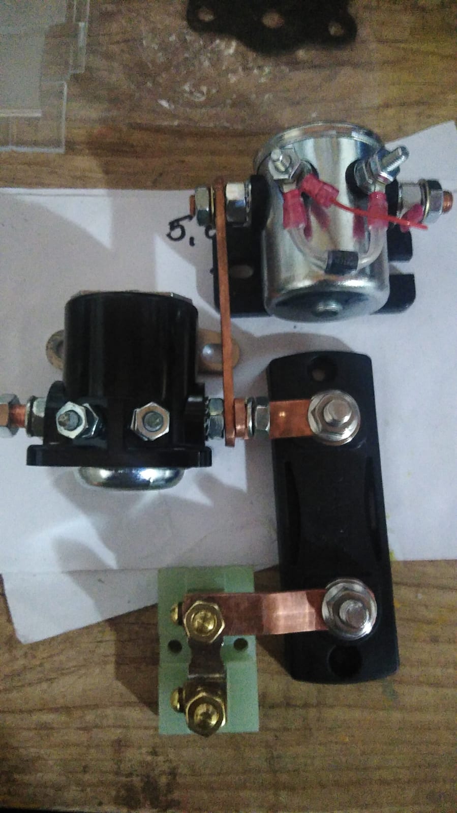

I'm attaching a picture of how it is going to look like.
The Master solenoid wiring has been adjusted to receive the battery on the right terminal (I have moved the red wire from the left to the right terminal and the diode remained untouched).
Bob, I'm not sure if the ACS Stater Solenoid has an internal diode, but I'm already planning on installing an external one. I just don't have one with me right now but I'll install one before powering up the system.
