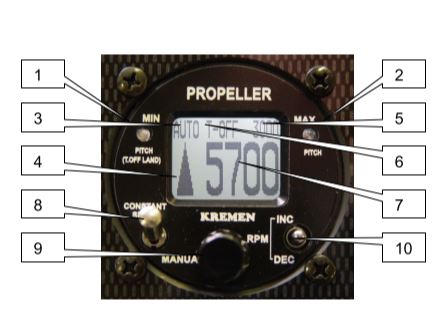

Hello all,
Recently I had a 14 weeks long experience, with waiting for me const. speed prop controller CS-5. He was mainly hanging out on customs with a T/G at Woodcomp for repair.
Finally after installing again, looks like the factory setting are wrong. Having at 4000 RPM for Run-up, the power lever is already by 90% and current engine rpm on the controller shows above 5000 rpm.
Does anyone has the same setup like I do and could help out with his controller settings?
Rotax 914 UL
Woodcomp Prop SR3003
Woodcomp CS-5 controller
Many thanks for support
Best regards from Switzerland,
Marcel
 Filesize:  30.04 KB
 Viewed:  1914 Time(s)
