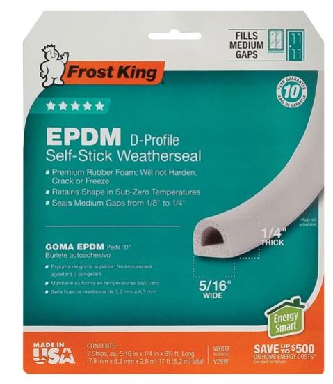

I really like the option offered by Erich. I searched for that Frost-King material and sure enough couldn't find it.
However, I do use the white EPDM seal from Frost-King in my LongEZ with great results.
Here is a picture of one with the dimensions as what Erich used. Comes in black too.
Chris
 Filesize:  45.07 KB
 Viewed:  7294 Time(s)
n7188u
Joined: 15 Nov 2015
Posts: 408
PostPosted: Fri Apr 29, 2022 6:56 am    Post subject: Re: Bowed doors Reply with quote
Apologies to the group. Jumped the gun and didn't realize the material is 5/16" wide, not tall as Erich's. Still looking but the EPDM seal is an option.
Chris
