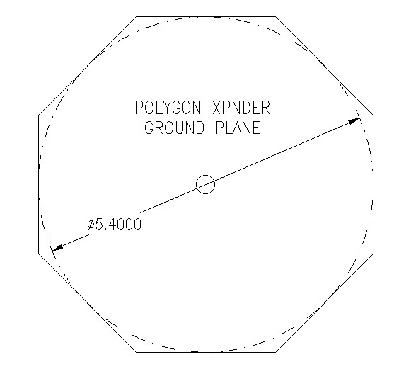

PostPosted: Mon Apr 11, 2022 7:49 am    Post subject: Transponder antenna ground plane Reply with quote
Preparing to install the transponder ground plane in a tube and fabric airplane, and there seems to be a large amount of conflicting information on the size and shape needed. I have seen several references to an octagonal ground plane, and that would work well in my application.  I would be using a Comant CI-105 fin style antenna.
Any details on the dimensions best for the octagonal ground plane, or comments from those who have satisfactory performance from one, would be much appreciated.

PostPosted: Mon Apr 11, 2022 8:11 am    Post subject: Re: Transponder antenna ground plane Reply with quote
5.3" in diameter per:
http://www.matronics.com/forums/viewtopic.php?t=16762861
Round or octagon should not matter.
Joe Gores
PostPosted: Mon Apr 11, 2022 8:15 am    Post subject: Transponder antenna ground plane Reply with quote
The 'ideal' stand alone ground plane takes
two popular forms. Perfectly circular where
radius of the disk is equal to 1/4 wave in free
space at the operating frequency. In the
case of transponders, that's 1090 Mhz.
300/1090 = 0.28 Meters for a full wave,
0.07 Meters for 1/4 wave or 2.7 inches.
So a disk 5.4" in diameter is indicated.
Aluminum is fine.
The 'best' ground plane is an 'infinite' conductor
like lots of aircraft metal skin . . . not an
option in your case.
Now, having described ideal ground planes,
know that overall performance of the antenna
isn't super critical. Ground radars can
sniff out a signal REFLECTED from the metal
of your airframe, it an certainly see a
directly transmitted signal measured in
tens if not over 100 watts.
I'm unaware of any rationale for shapes
other than circular. Would like to see
antenna range test data that supports
the suggestion.

PostPosted: Tue Apr 12, 2022 7:45 am    Post subject: Transponder antenna ground plane Reply with quote
At 01:57 PM 4/11/2022, you wrote:
Forgot to ask – should the ground plane be “grounded” to the fuselage as some suggest, should it be isolated from the fuselage, or does it make any difference?
>The ground plane probably should be grounded to the fuselage for lightning
>protection. But I don't think it matters for performance.
>Joe Gores
Agreed . . . and yeah, making the ground plane from
a hexagon or octagon cut our on a shear makes good
sense labor wise as opposed to cutting out a circle.
I was fixated on demonstrable performance as opposed to
practical convenience!

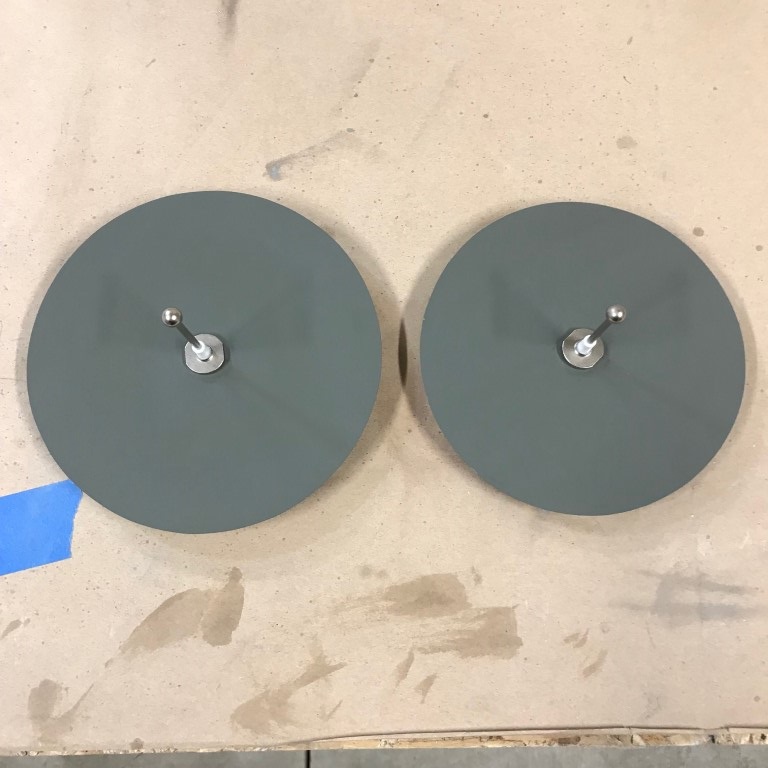

I put transponder and ADS-B antennas inside the wings of my Kitfox. The ground planes were made from a piece of very thin galvanized steel flashing material that I sourced from Home Depot. I drew circles on the material in the required sizes, rough-cut the parts with hand shears, then shaped them to final size in a couple of minutes with a disc sander. The center hole was made with a step drill, then the parts were coated with primer. I removed primer from a small area around the center holes to ensure good electrical contact to the antenna. I think my total investment in the parts was about $4 and one hour of labor. A couple of varnished wood sticks and some structural epoxy mounted them securely inside the wings, well away from the spar tubes.
Finished transponder and ADS-B antennas with DIY ground planes, ready to install.

PostPosted: Tue Apr 12, 2022 2:34 pm    Post subject: Re: Transponder antenna ground plane Reply with quote
Nice work Eric. Is the antenna on the bottom or top of the ground plane?
Does it matter?

PostPosted: Tue Apr 12, 2022 3:59 pm    Post subject: Re: Transponder antenna ground plane Reply with quote
Does it matter?
In flight, the radiating elements (pointing up in the photo) will point down toward the ground, and the BNC connector will face up. Not sure about your second question, but I've only ever seen transponder antennas on the bottom of airplanes, pointing down.

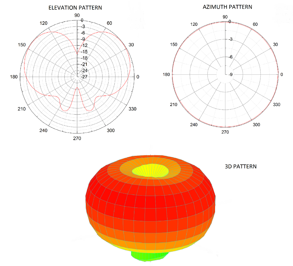

PostPosted: Wed Apr 13, 2022 8:22 am    Post subject: Transponder antenna ground plane Reply with quote
At 09:41 PM 4/12/2022, you wrote:
Next year Canada is going to require aircraft flying in Class A & B airspace to be able to send transponder signals to satellites. This requirement can be met either through antenna diversity (the use of a top and bottom antenna) or with a single antenna that is capable of transmitting both towards the ground and up towards satellites.
I have never seen transponder antennas on top of airplanes either. But chances are that an antenna on top would work just as well as one on the bottom.
The quater-wave, ground-plane antenna has a
radiation patter like shown in this illustration.
Very attenuated response 'below' the ground plane.
Probably even more attenuation on a 'large' ground
plane like an aircraft skin.
Looking at the elevation pattern we see the major
lobe is displaced about 30 degrees off the ground
plane . . . i.e. favoring ground based stations
when mounted upside down. Response out to the
horizon is only down 3db . . .
