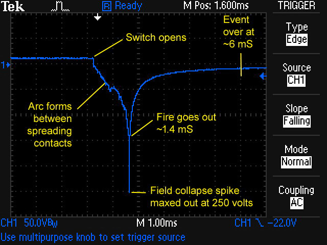

The attached plot was taken from one of those
experiments.
An S701 battery contactor coil collapse
spike was plotted while being controlled by
a toggle switch and NO coil suppression. Note
that the maximum excursion was on the order of
250 volts impresses across the spreading
contacts gap in the switch. An arc formed
between those contacts which persisted for
about 1.4 mS at which point the arc broke
and remaining energy took the transient to
its maximum excursion.
Energy dissipated in this even was on the order
of tens of millijoules. No single event
being hazardous to the switch . . . but hundreds
of events would eventually erode the switch's
contacts.

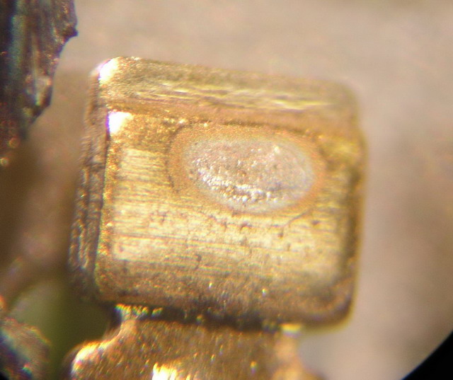

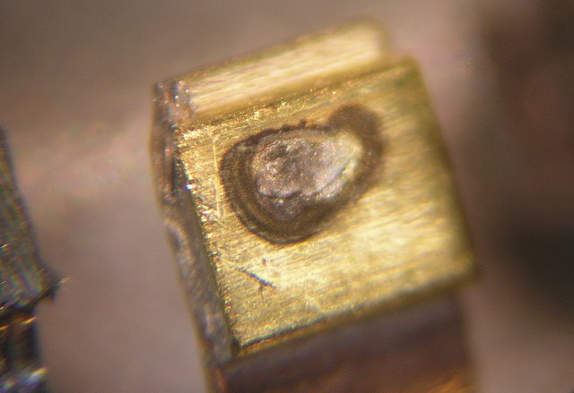

Two other images illustrate a study I did
at Beech on another contact failure investigation.
You can see the difference in burning and metal
transfer of controlling contacts with no
transient suppression on the loading device.

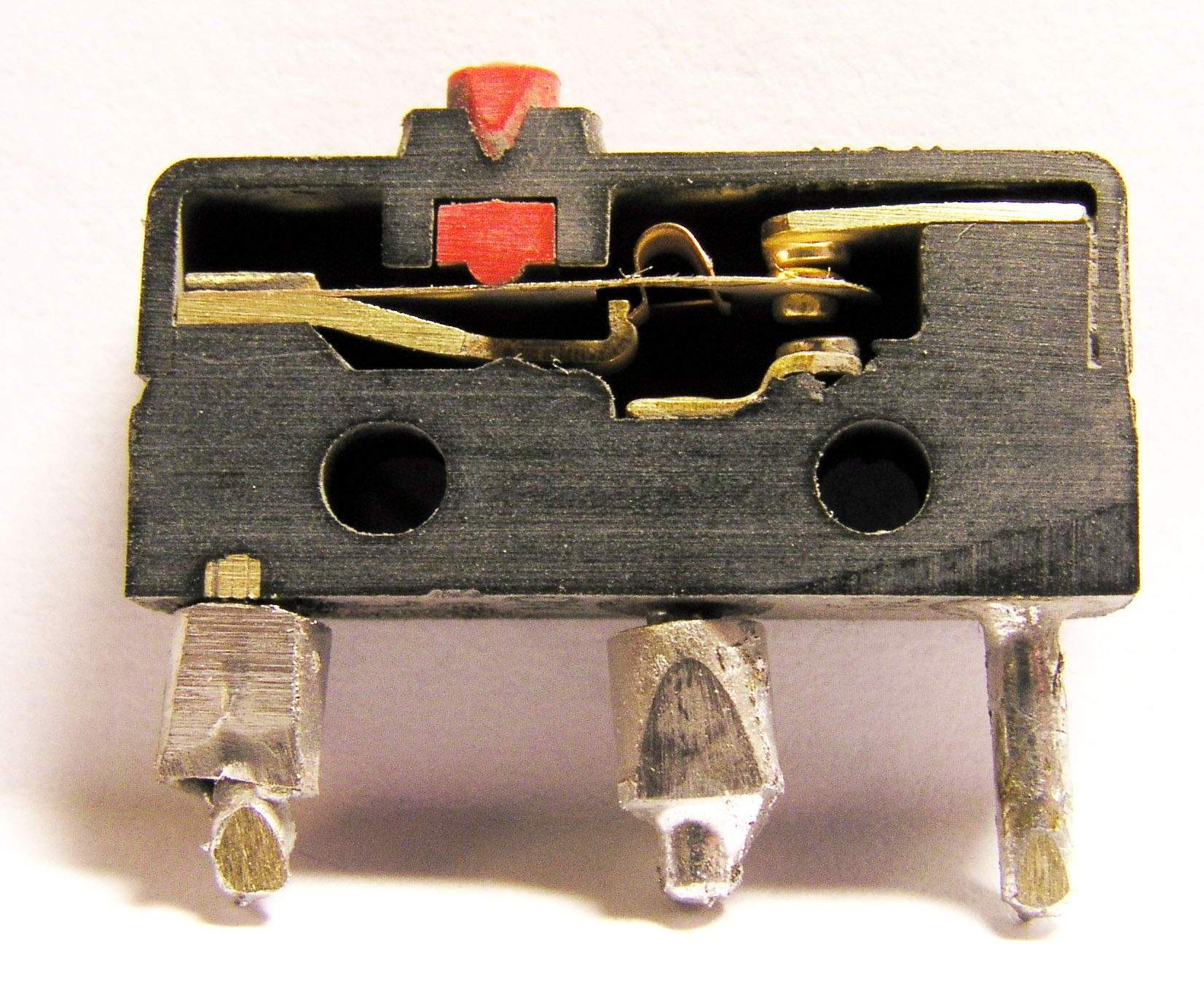

term. I recall a demonstration I did many moons
ago where I switched a 1.5 volt flashlight cell
across a 1 ohms resistor.
Approx 1+ amps of current flow. I did this with
a sub-miniature, 'micro' switch with the side
sanded off so that one might observe the inner
workings.
While watching the contacts under a microscope
in a dark room, I could see a tiny arc between
the spreading contacts. The color of the arc
was blue . . . HOT. This suggests that for
even the smallest energy levels, the potential
for erosion of metal off the contact surfaces
is not zero; hence wear is not zero either.
