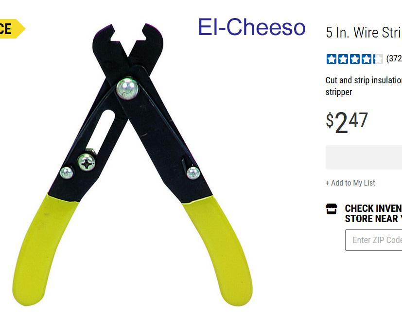

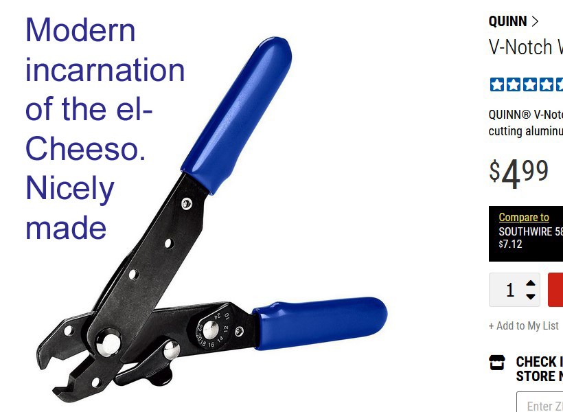

Was in Harbor Freight yesterday and spotted an el cheapo
wire stripper that was interesting. This QUINN product uses
a solid rivet in the pivot point and a handier travel
stop to set wire gage.
Bought one and hauled it home. Does a really nice job
and with the solid shaft, more likely to stay tight
with age/use.
The el-Cheeso design has been around for decades and
I have a few of them . . . which I'm going to pitch
and replace. The $5 HF offer is about 1/2 that of
offers on eBay, et. als.

Yup . . . you noticed! There's a constellation
of variables for achieving consistent stripping
action on the various wire products. This is
what gives rise to the virtual snow storm of
stripping blade choices on pages 7 thru 11 in:
http://aeroelectric.com/Mfgr_Data/Tools/Ideal_Stripmaster/Ideal_Industries-LB-1002-datasheet.pdf
So when evaluating suitability to task for these
v-notch tools, you need to factor in your own
sense of grip calibration. It's not difficult.
But if you try a selection of tools on the wire-of-the-day,
you'll quickly adjust your technique to maximize
results with the tool of choice.
I've used the el-cheeso tools for decades with
satisfactory performance but I really like the
feel and function of the new kid on the block!
It's a low cost experiment . . . recommend interested
builders acquire a pair and spend some time
getting up close and personal with some wire
scraps.
Remember, you're not trying to cut the insulation
down to the wire surface . . . only to 'damage'
it deeply enough to fail cleanly when you tug
on it.
