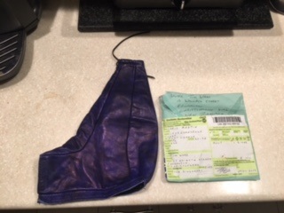

PostPosted: Tue Feb 08, 2022 2:26 pm    Post subject: Control Column Boot Reply with quote
Hi Chris,
Many years ago I persuaded the local leather-man to produce some Control Column Boots for Europa Builders and posted them when flying to Heathrow or LAX.
Now retired, and with the Christchurch earthquake taking out the leather-man’s shop,
I haven’t produced them for awhile. However, I did end up with one, don’t know how, which I can send to you to make a copy and reproduce. Photo below. If you only need one then mission accomplished.
Cheers,
Tim
[img]cid:1B39EEC2-46F3-4097-9480-039140E78C12[/img]

PostPosted: Tue Feb 08, 2022 5:24 pm    Post subject: Control Column Boot Reply with quote
Hi Chris,I shall drop it in the post, no problem. Unpick the thread and get measurements for a leather-man or yourself to copy with your chosen colour, I suggest.
Installation:
Create a fibreglass semi circular (elongated) fence from Tufnell control bearing housing, on the floor of the footwell, about 50mm high. Feed the boot down the control column. It goes over the outside of the fence, stuck down and secured with Velcro.
Also along the outer surfaces of the Tufnell control bearing housing. Tie boot on stick. Complete!

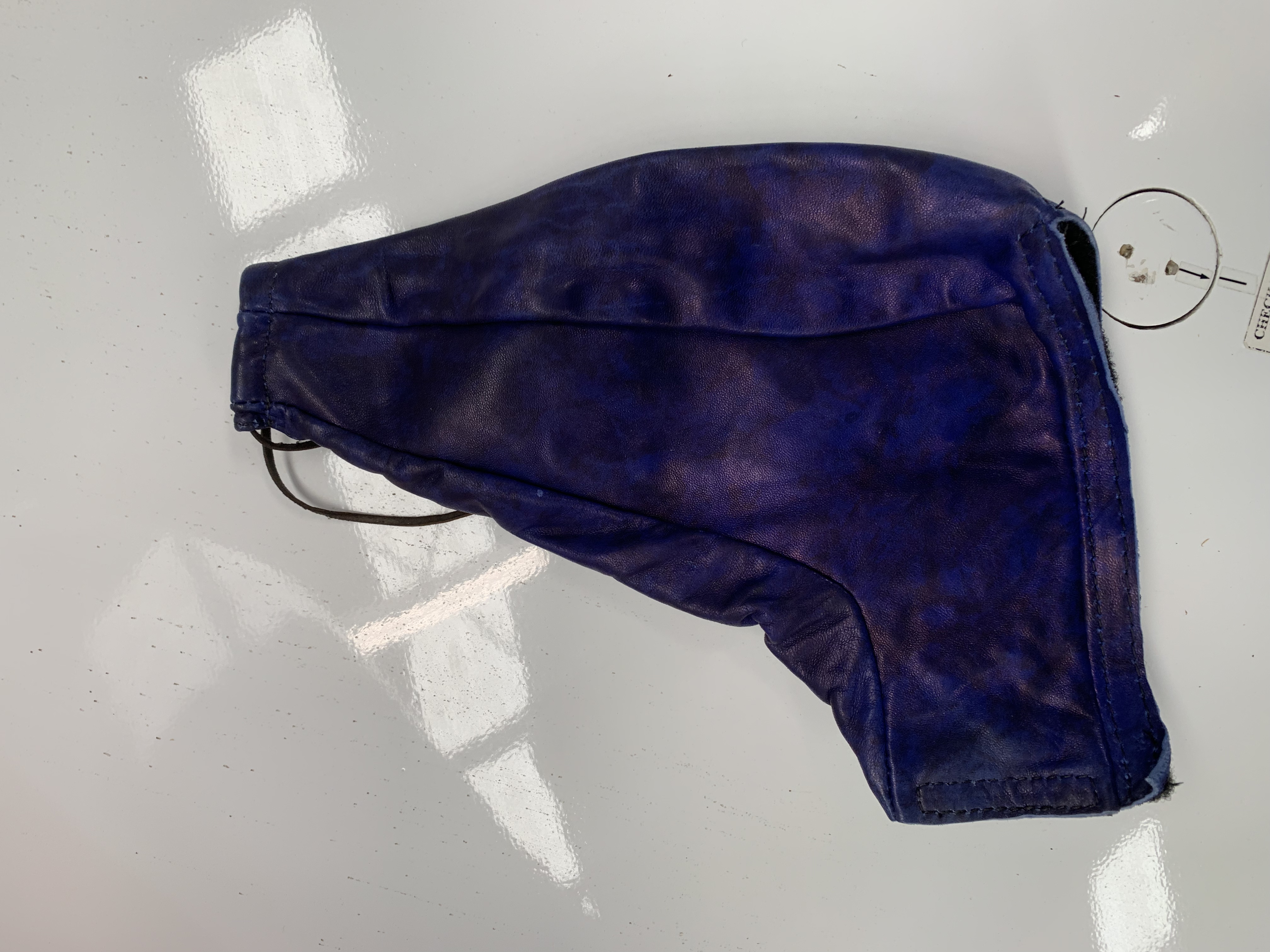

PostPosted: Tue Mar 15, 2022 1:38 pm    Post subject: Re: Control Column Boot Reply with quote
Hi Tim,
I have to report that Lo and Behold I received a little package from the other side of the planet!
Only took 4 weeks so not too bad Smile
I felt so bad at unstitching the boot (it's kind of neat with that smooth New Zealand leather) that made my job hard and somehow created some patterns. I will make a sample and see how it goes.
Chris

ward.t(at)xtra.co.nz
PostPosted: Tue Mar 15, 2022 2:34 pm    Post subject: Control Column Boot Reply with quote
Chris, Pleased it arrived safely. Still have faith in the postal system despite the time factor these days. Good luck in the replication of it, would be interested to hear and see how in turns out. Don’t know where the other one is!

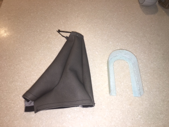

PostPosted: Fri Mar 18, 2022 6:55 am    Post subject: Re: Control Column Boot Reply with quote
Well, a boot (with NZ roots) is born Smile
Not as nice as the leather version from Tim but since I am not a seamster by trade I think I did OK. I bought a Singer Heavy Duty 4411 (not industrial) machine that was relatively inexpensive a while back with hopes of doing my seats (not sure anymore that I want to do something like that but the machine is always handy to have around) and got a walking foot attachment which seems to be useful particularly when sewing the velcros.
I made a fence that I will bond to the floor (avoid doing any layups inside the airplane anymore if I can).
Made it out of the thinnest and most stretchy vinyl fabric I could find. Have not installed it yet but will report when I do.
Thanks for the sample Tim. It really helped getting this done relatively quick.
PostPosted: Fri Mar 18, 2022 11:34 am    Post subject: Control Column Boot Reply with quote
Hi Chris,Well done. Looks good and fibreglass fence essential. Velcro makes it easy to inspect control column universal on annual inspection, by simply shifting boot up the column.

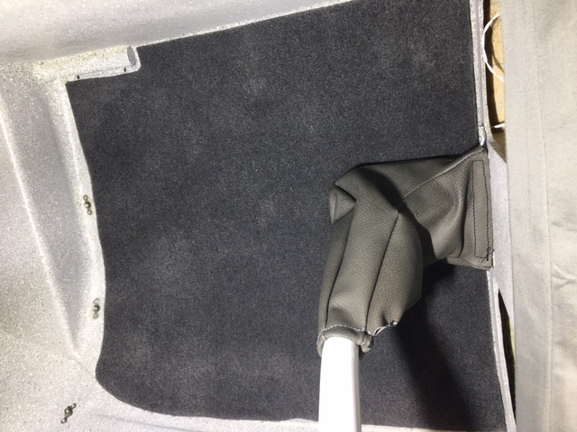

PostPosted: Tue Mar 22, 2022 12:49 pm    Post subject: Re: Control Column Boot Reply with quote
I Think this will be my last update on this. Finished the pilot side and it sure looks good (if you don't get too close to it Smile). I got the boot finished for the copilot side but need to make the fence, attach velcro and bond in place.
