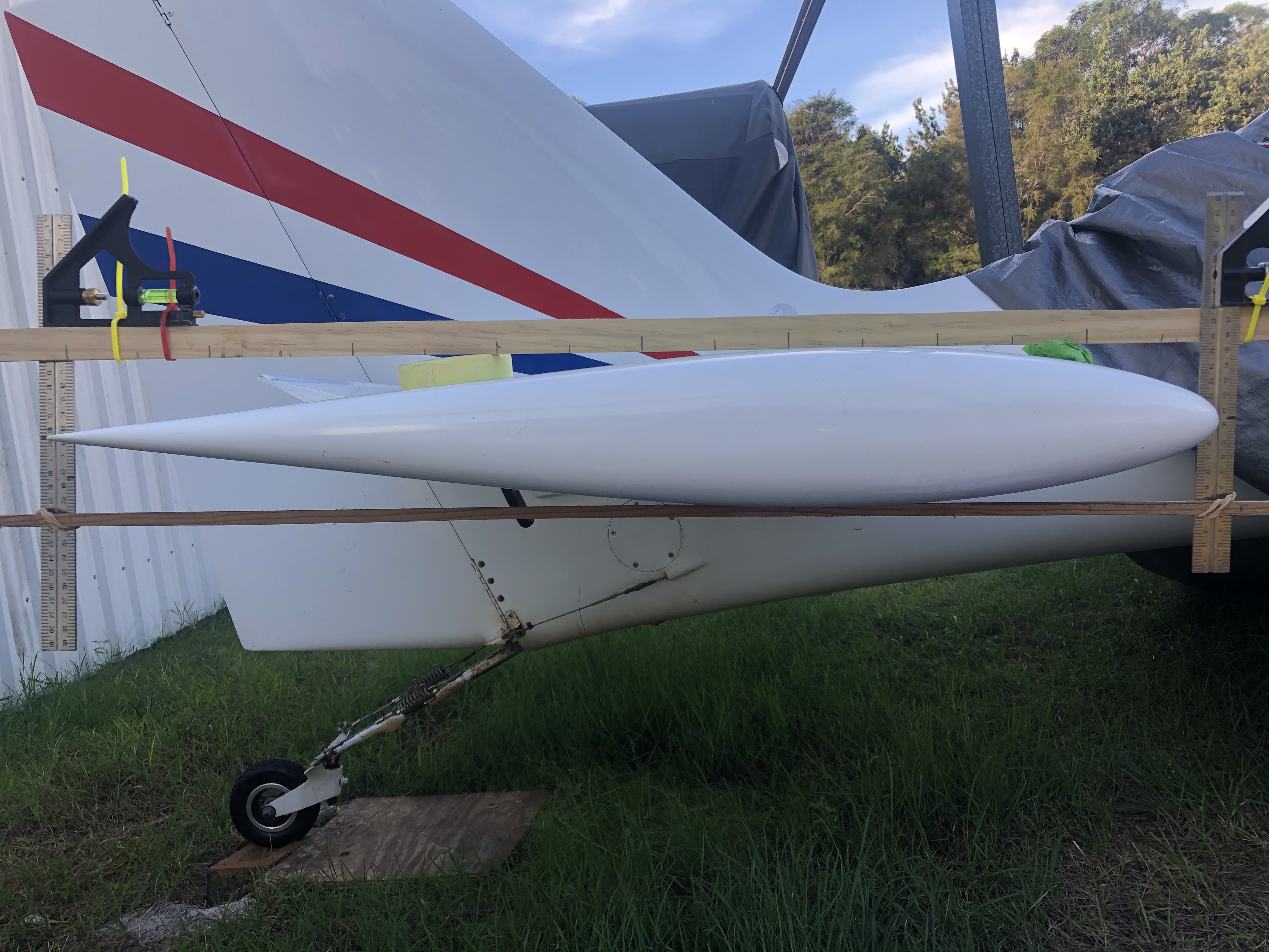

Decided to just go Old School on this one and plot it all out from actuals... Task done :)

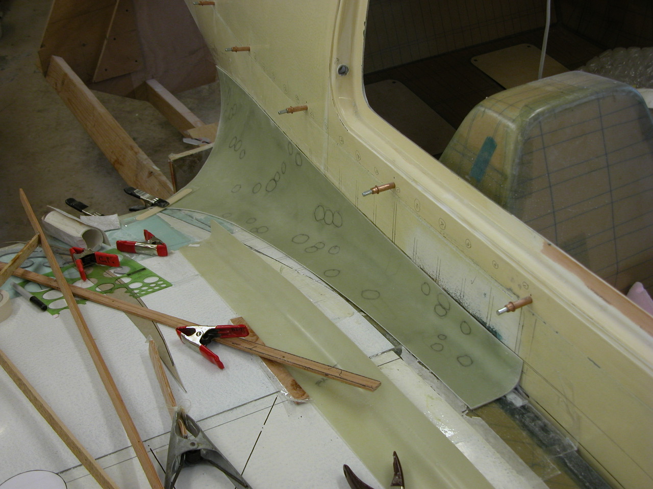

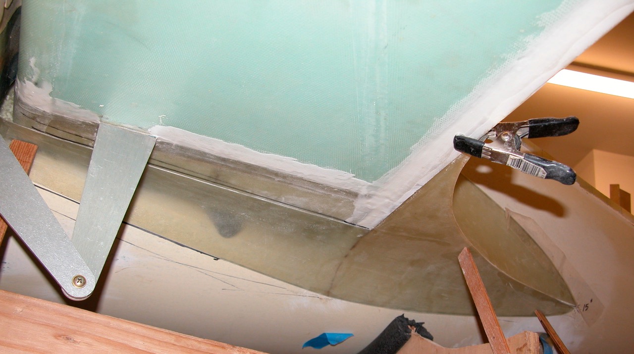

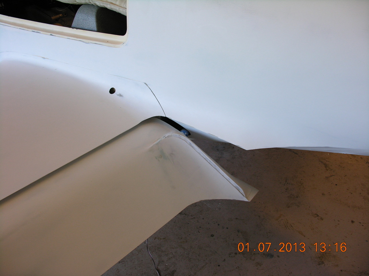

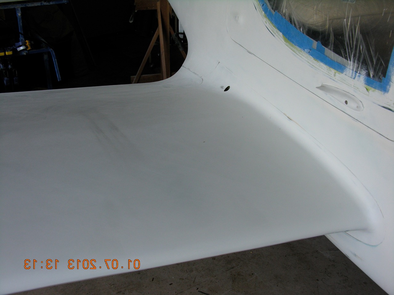

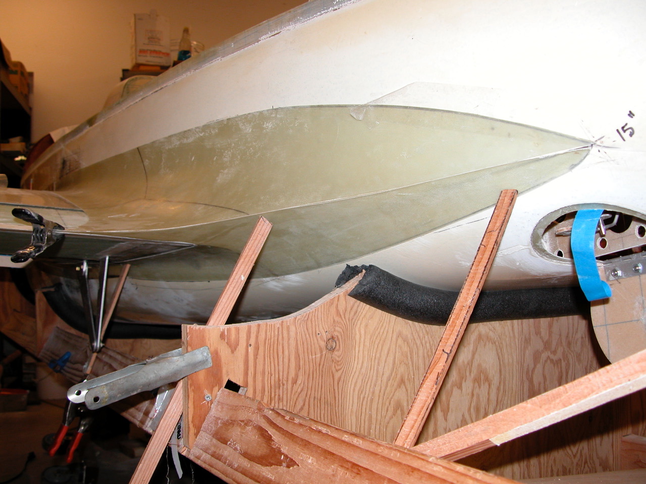

Pete…below are my best efforts in that regard…I too am very curious as to what a rigorous analysis will show...Fred

Indeed Fred, yours looks “spitfire perfect”. Gorgeous!

It will indeed be interesting to see what the CFD results reveal... after years of playing with this stuff its always surprising in some way; the brain thinks the air will flow a particular way and it often does something different!

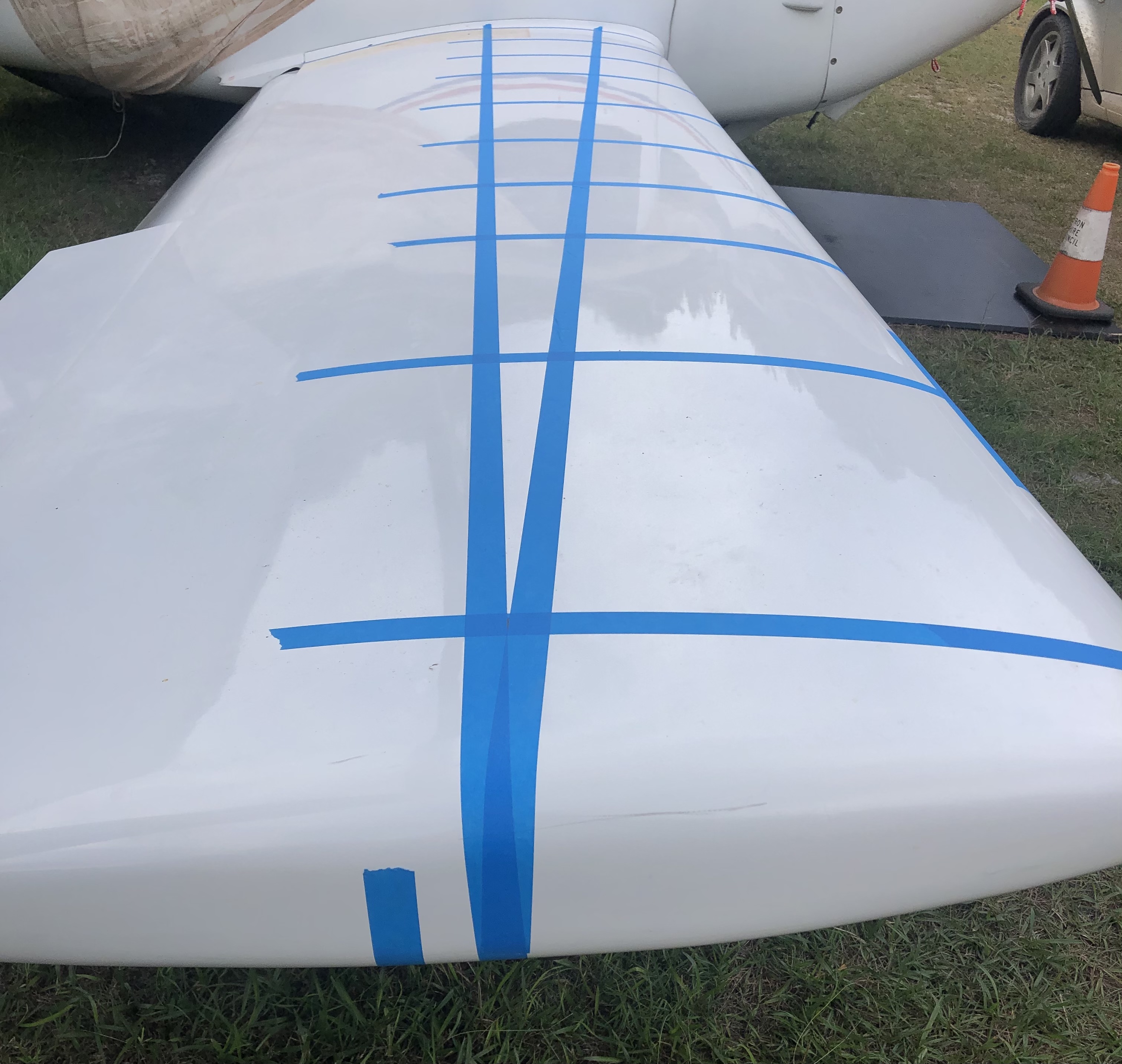

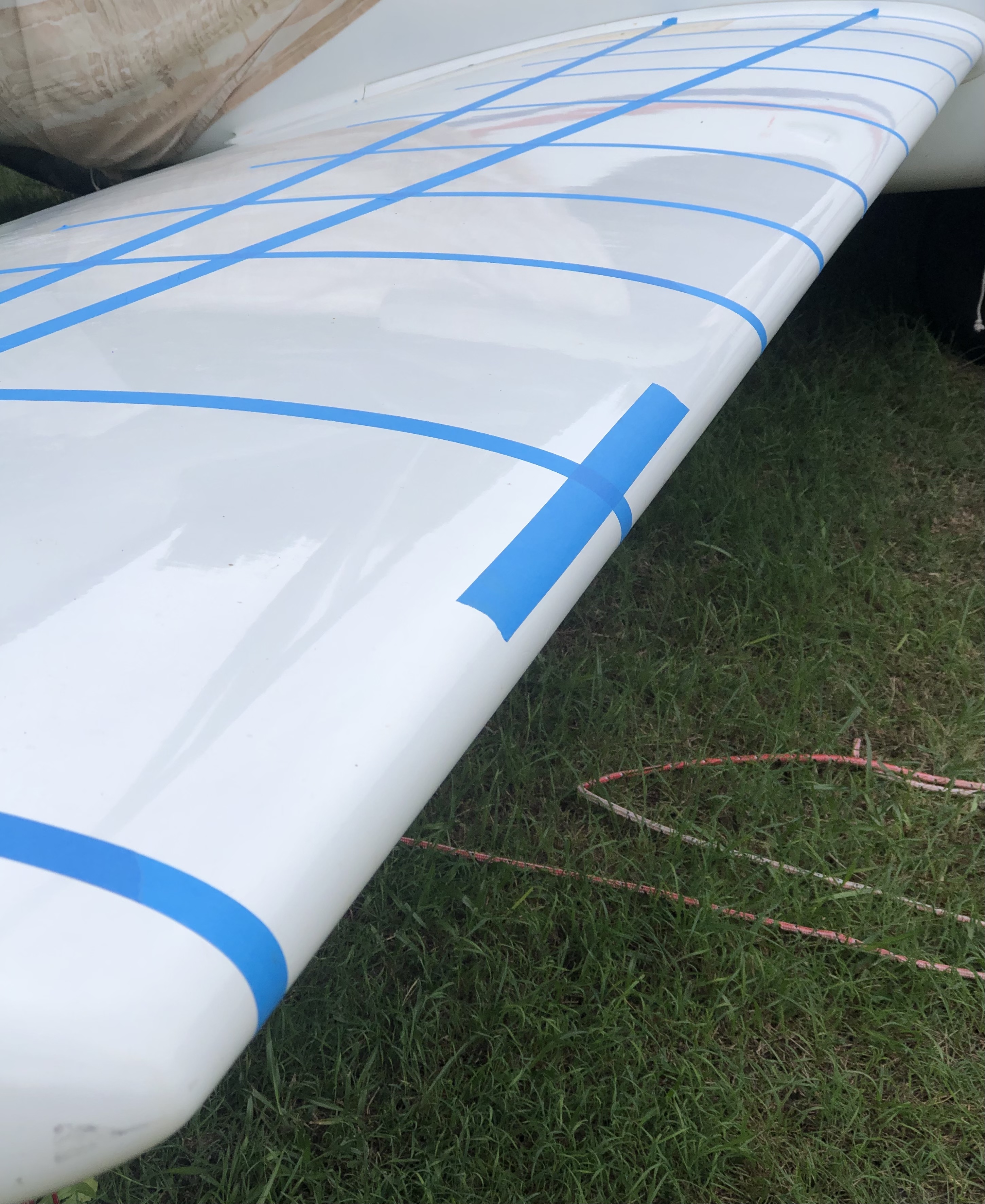

Today involved a more thorough study and data capture session after the mention of alternate stations along the wing; and indeed they were there when searched for! Will be interesting to watch the stall response... the wing root has a slightly alternate upper chord profile; the lower chord profile on this particular aircraft is uniform across it’s span, and no washout.

When we scanned the Europa we used paint that was washed off afterwards. It is commonly used by street artists. An initial attempt without paint led to big gaps in the cloud data.
I like the root fairings, they look a bit like Frans Veldman’s who was highly active in Europa modifications. Whatever happened to Frans?
The tape is probably a better idea, as it limits the data - although there are some coordinates for the sections along the wing - we used them years ago in xfoil.

Interested to know what polar results Xfoil popped out there John! Would still want to cross reference results to those of Ansys Fluent though.
On 3d scanning; shiny surfaces are the devil... dead flat non-reflective surface is going to save a lot of mumbling...water soluble hair spray and talcum powder dust is a magic formula! Plenty of reference dots are required too... washoff flat spray paint costs a bit more :)
