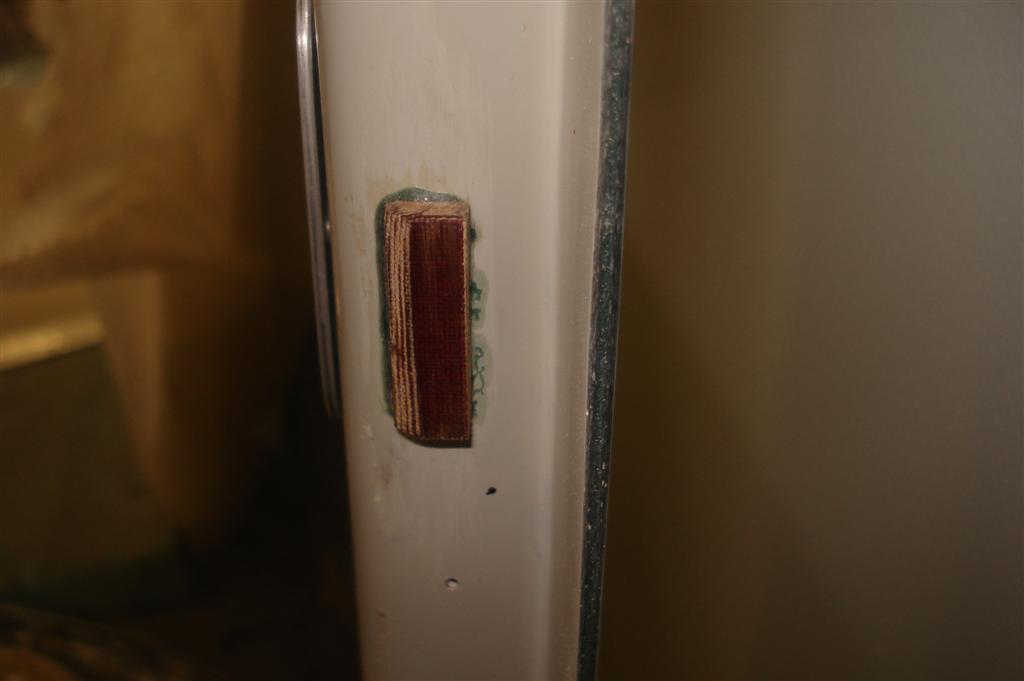

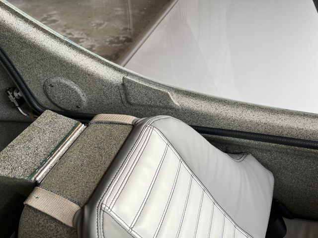

I plan on the passive fixed version for my build, but Troy Manor implemented the center active shoot bolt very successfully on my flying mono. Works great. I believe there are also others, to reduce the door bowing outward at higher cruise speeds- its original intent.
PeteZ

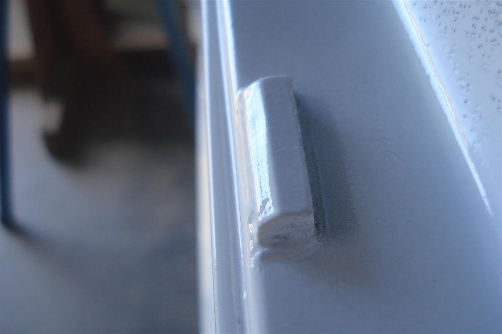

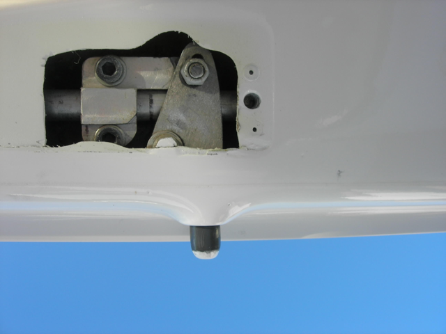

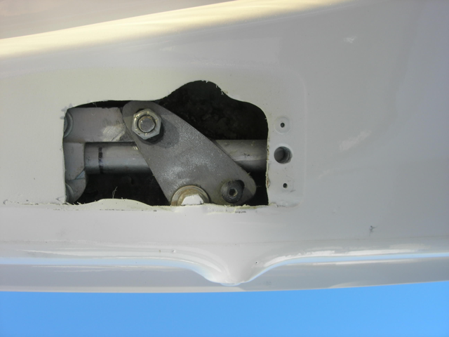

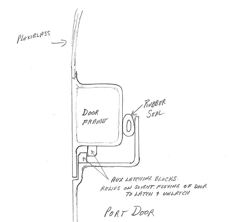

Here are my notes concerning the passive version. I got these many years ago and have thought about installing but have not as yet.
Jim

Thanks Jim, your notes there answered my question regarding Peter's input and how the passive concept works and how the door is opened from the outside in the event of an emergency. I must have a really well constructed build; have not experienced these levels of door flexure. Would appear they are fabricated with not enough layup layers in the first place perhaps?
The passive system is workable however it addresses a separate issue and doesn't meet what I would consider sufficient to mitigate the overall risk in review... Peter are there any drawings available of Troy's mod? The position of the third pin is not at a stress point, so I have no issue cutting into the door or channel and adding additional reinforcing layups; it addresses the overall risk quite well, why has the factory not addressed this earlier?

I love Jim’s solution with the little blocks; as I understand it, not only does it prevent the shoot bolts from engaging unless the door is properly aligned for both front and rear bolts, but it also has the potential for solving the unsightly bulge when the door is locked in place. I definitely will be adding them.
In my case, in order to ensure that the rear shoot bolt is properly aligned, I’ve found it necessary to add a little hand-hold (a scrap of 1/8” Lastafoam w/ a couple of layers of BID) which, when in the right seat, I reach across my chest with my right hand, pull the door inward, while my left hand throws the latch into the forward and locked position…Bob’s your uncle !!
