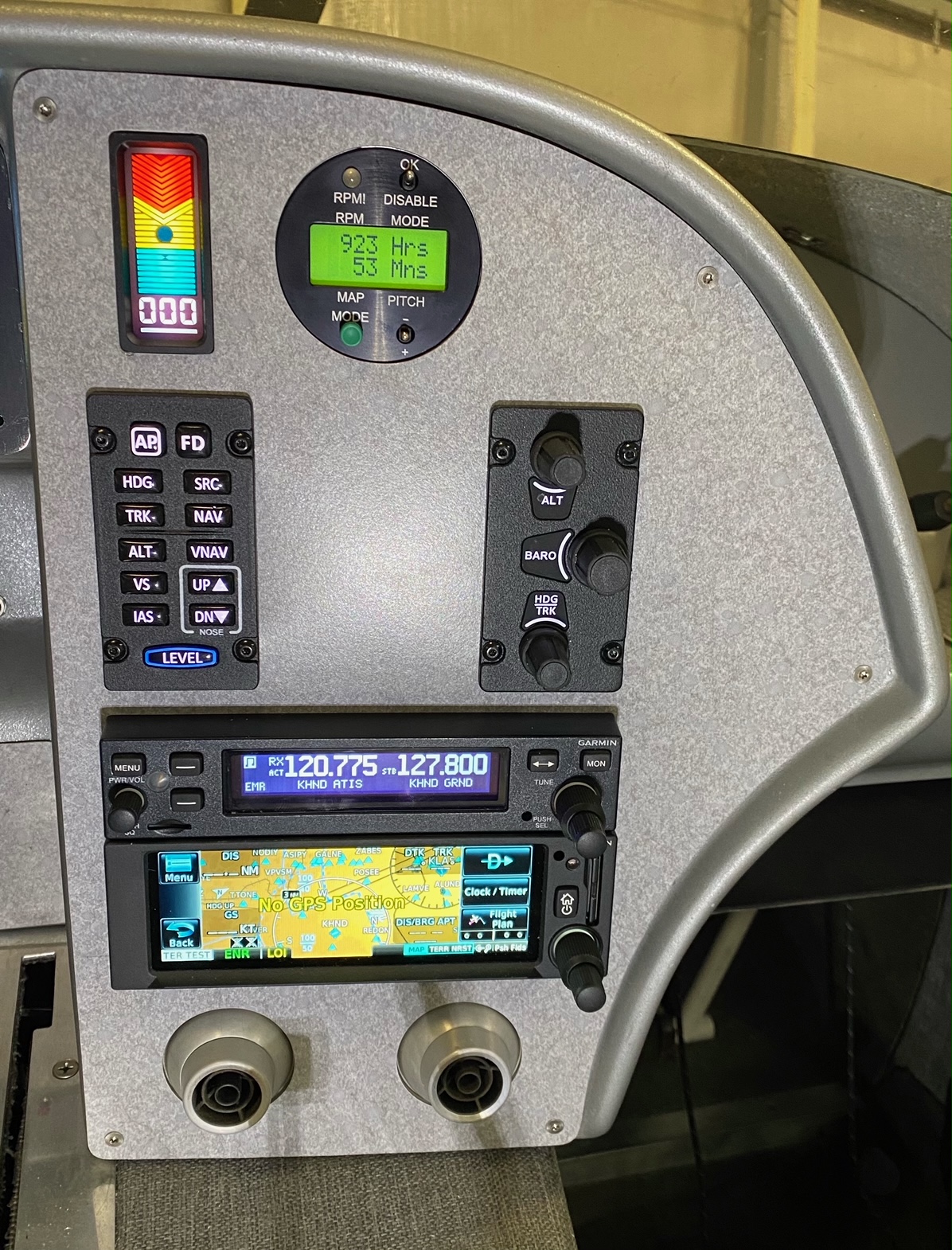

Hello all,
Well, I am get close to finishing my panel upgrade. Center stack is finished which now includes the relocated constant speed controller and the IFR navigator.
The Garmin GPS175 is working nicely, communicating with both my Dynon Skyview 10” display and the recently installed Garmin G5. The G5 serves as a backup to the Dynon.
I was initially concerned that the three boxes wouldn’t play well together as different ARINC 429 setting are specified for each piece of equipment. For ARINC to function properly the transmitting device can have only one protocol set which must be acceptable to the receiving units.
Fortunately, after discussions with Dynon support and testing the G5 on a friend’s plane I was able to confirm they units could in fact be configured to work properly. Essentially, the Dynon needed to be set to “low speed” for data as that is the only speed the G5 can accept. The G5 on the other hand was set to accept GAMA 3 data which the Dynon requires in order to graphically display flight plans, holds, procedure turns, etc. The additional data set contained in GAMA 3 (vs GAMA 1) is extraneous to the G5 as it does not have the capability to display the information and apparently disregards it.
Now, to finish the main panel and put the rest of the plane back together.

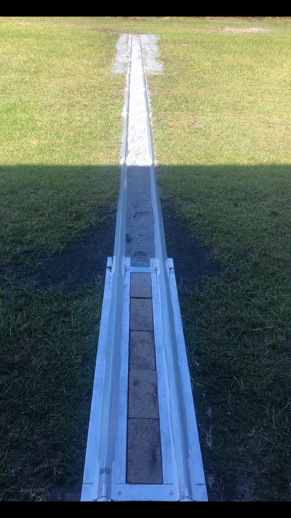

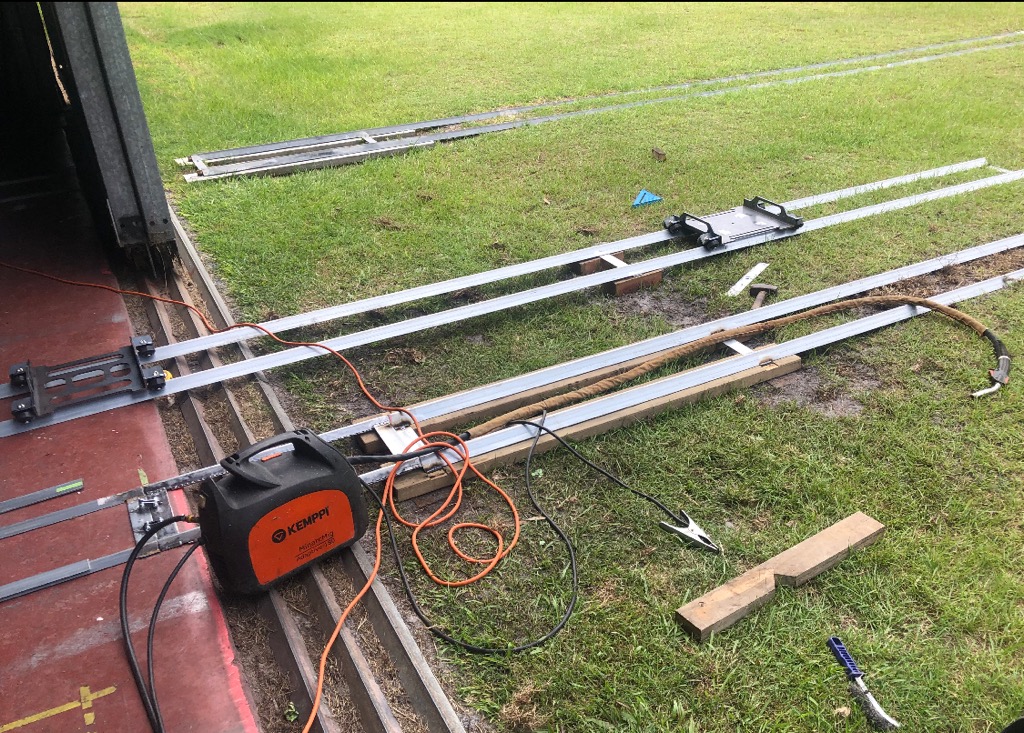

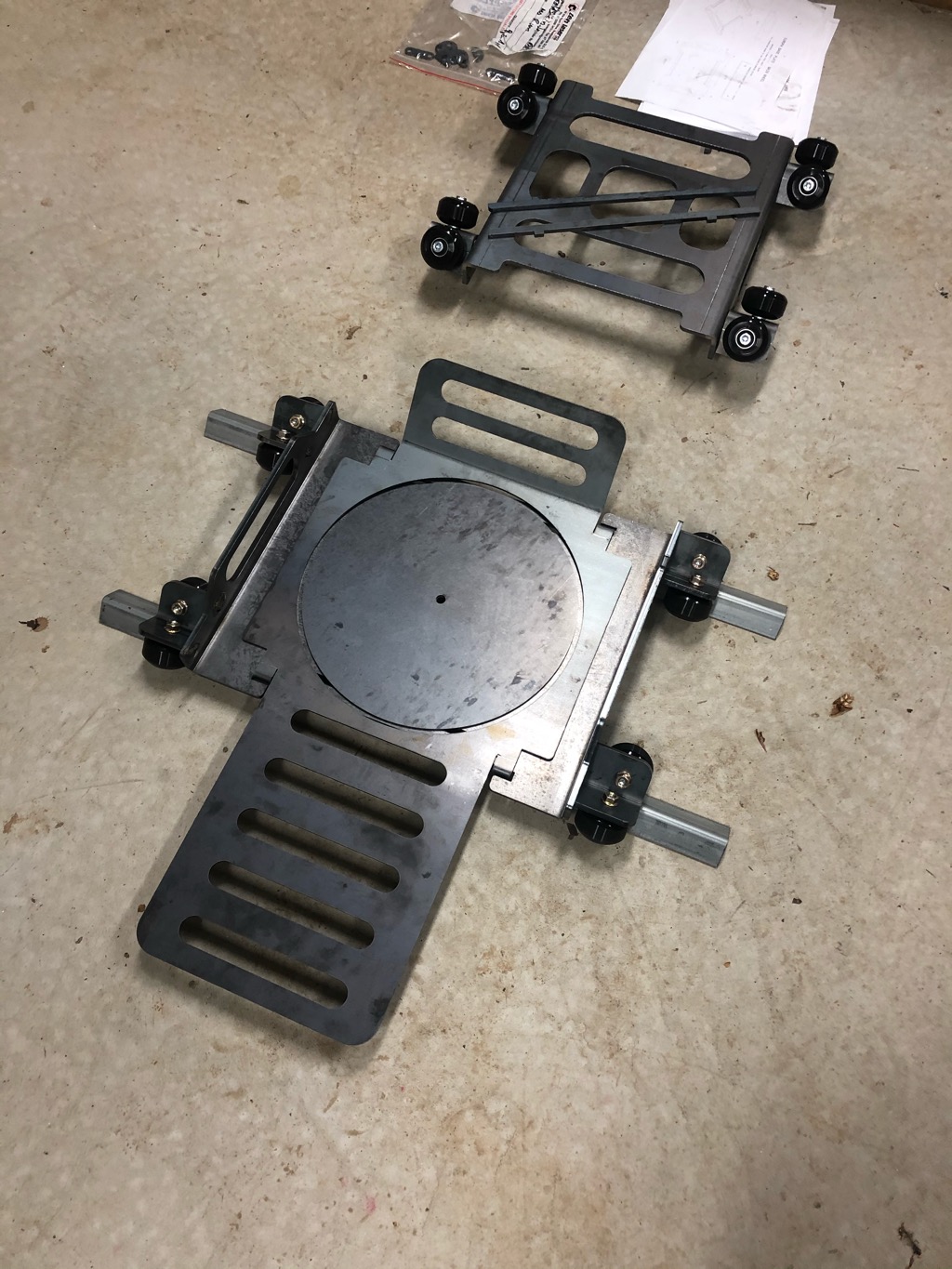

Pulled both float bowls off the 912 to inspect for debri; clean as a whistle and about to give the AC its annuall...
Finished installing the hangar track; works perfectly as planned... my body feels wrecked; discovered I love designing and really hate fabrication 🙂
Going up in the sky tomorrow 🙂🙂
