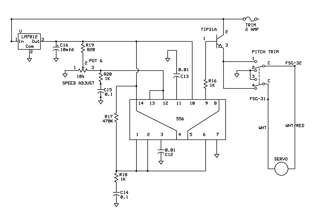

Van's RV-12 elevator trim servo speed is controlled by a PWM circuit.
The theory is that the trim motor sees full voltage and therefore its torque is not reduced.
Is that true?
Some RV-12 owners have trouble adjusting the trim servo motor speed. The motor either runs too fast or not at all.

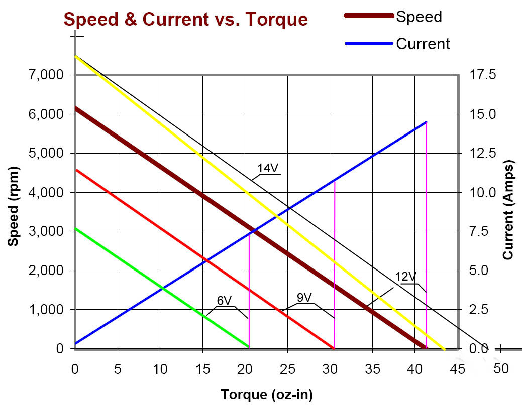

There's a hangar full of bad science out
there about motor performance but here's a
place to start:
The attached curve is an EXEMPLAR performance
plot for a PM motor. Note that TORQUE is
directly proportional to CURRENT. RPM is
proportional to VOLTAGE. Hence, assuming that
the motor is operating within design limits,
a slowing motor is starved for VOLTAGE. In
the case of a trim system, torque loads are
not a function of trim speed . . . so if
speed regulation is poor, it's a prime notice
that VOLTAGE regulation is poor . . .series
resistors turn a constant voltage source
into a wet noodle.
Note that there is ONE plot for torque vs.
current that's true for ALL voltages. No
load RPM and STALL current are proportional
to voltage (note 6v stall is 1/2 that of
12v stall).
ACTIVE voltage regulators incorporated as
suggested in the drawing are CONSTANT
VOLTAGE sources irrespective of load.
Motors do not automatically 'draw more
current' as their driving voltage is reduced.
Using a series resistor to control speed
makes speed regulation so poor that it SEEMS
as if motor current is being modulated with
speed . . . not so.
out of that stuff?"
 Filesize:  143.44 KB
 Viewed:  3615 Time(s)
PostPosted: Thu Feb 10, 2022 5:51 am    Post subject: PWM ELEVATOR TRIM SERVO SPEED CONTROL Reply with quote
speed . . . not so.
I've had some direct questions on this
topic . . . perhaps I went too far into
the weeds with the physics and offered
insufficient practical approach to
individual solutions.
If anyone is having trouble managing
their trim system performance, please
have them join us here on the List or
drop me a line personally. I've
worked trim systems on everything from
C182 to Hawker 4000 and most of those
in between. There ARE proven solutions
but they may require tailoring to a
builder's specific situation.
It CAN be fixed.

user9253
Joined: 28 Mar 2008
Posts: 1978
Location: Riley TWP Michigan
PostPosted: Thu Feb 10, 2022 7:11 am    Post subject: Re: PWM ELEVATOR TRIM SERVO SPEED CONTROL Reply with quote
Bob, thanks for the information. If I ever redesign my trim circuit, it will contain a LM317.
You asked about the RV-12 trim circuit. Attached is a schematic of the original trim circuit.
Van's has completely changed it in later models. But they still use PWM.
 Filesize:  18.23 KB
 Viewed:  3596 Time(s)
Joe Gores
