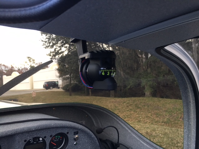

1.- Although I have an AV-30 and plenty of GPSs I thought that the nice Sirs compass I got with the kit could not go to waste and installed it. Kind of compliments my old fashioned looking round gage panel Smile

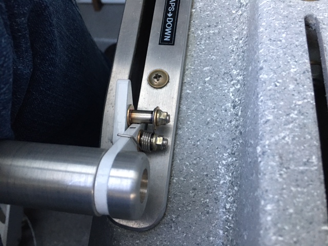

2.- Since I intend to fly this airplane from grass often, I installed the gear down latch spring modification. Tested it yesterday and it works nice. Much better than the latch with no spring.
