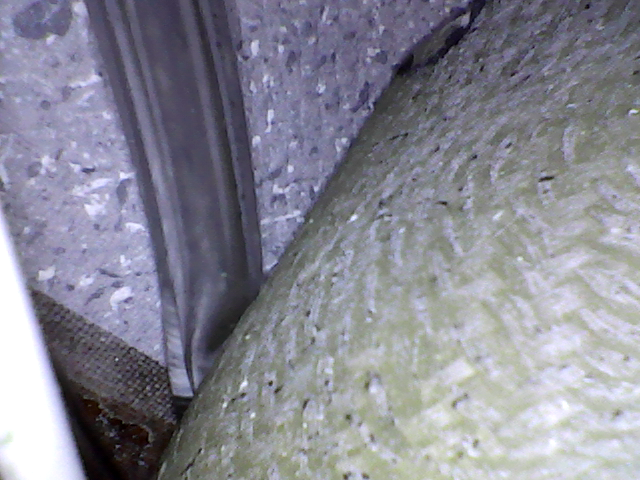

This week I finished making all the connections to my new engine monitor. Got around 4 hours on my new engine (not without some teething problems) and this morning I had a great flight with everything finally working OK.

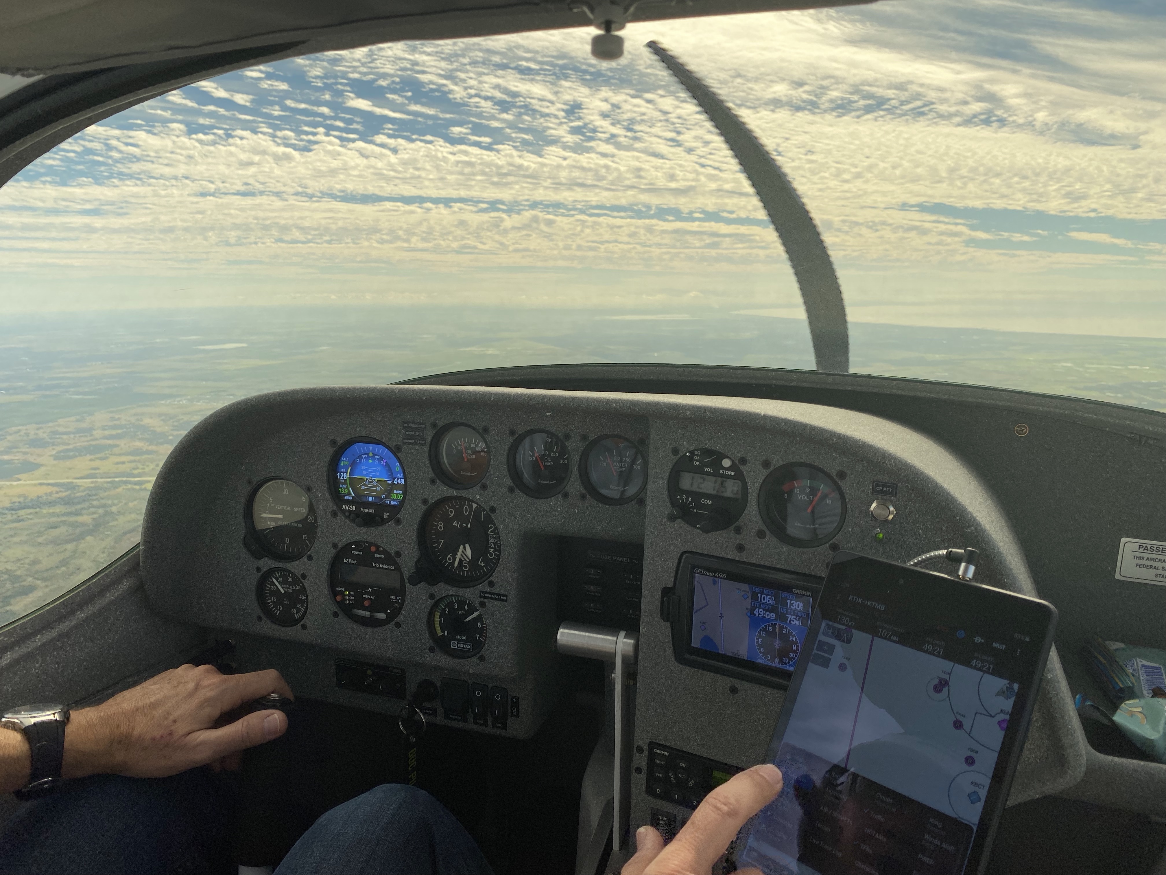

One thing I have to say, I take my hat off for those who have a fancy loaded panel. Mine is simple and although I designed to be easy to remove (about 10 minutes), it's still a challenge to reinstall without having all interconnect wires bunch up and bind (a couple of flights ago took off with no ASIs due to a pinched tube, end result was the best landing I ever performed in the monowheel Smile).
My panel is almost all round gages with instruments mounted form the back which makes it difficult to create an opening to inspect the wiring once the module is in place). I think next time I will consciously install some items with ease of removal once the module is in place to be able to create access and make sure no wiring or tubing is binding.
Here I include a picture of my panel (before the MGL EMS-1 engine monitor) while enroute to Miami and also included a selfie of me and my wife on that same trip (do I look serious or what?). Also a picture of the pinched tube I took with my borescope. I rerouted some items to prevent that pinch point but still....
