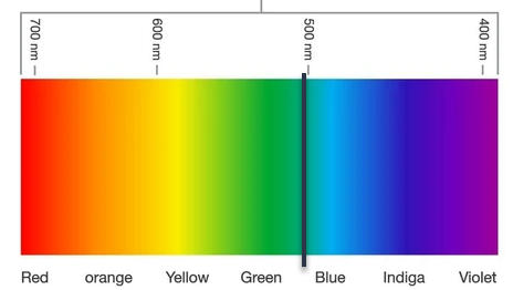

For very low levels of intensity (scotopic vision), the sensitivity of the eye is mediated by rods, not cones, and shifts toward the [url=https://en.wikipedia.org/wiki/Violet_(color)]violet[/url], peaking around 507 nm for young eyes; the sensitivity is equivalent to 1699 lm/W[9] or 1700 lm/W[10] at this peak. (wikipedia)
For low light illumination ideally we would illuminate with a source of 507 nm.
[img]cid:ii_kz2z4pkr1[/img]
...Chris

Cool White: White was preferred by 2 of the experts, the 3rd chose green 1st and white 2nd. Cool white encompasses the scotopic (night vision)sensitivity peak of 507nm while providing the benefit of full color readability on maps etc. The Air Force has established cool white as a MILSPEC for ambient cockpit lighting due to emergency procedure concerns. Dimmed down low everyone said that cool white would be fine for night vision.
Green lights: Scotopic (night vision) is most sensitive to light of 507nm wavelength which is an aqua green. This means that with green light you can dim the lights to a greater degree while still perceiving objects. Practically this means better night vision, maintaining pupil dilation and reduced reflections in our cockpit.
Red/orange: The old red goggle adage has lost its fame. Yes red minimizes the bleaching of rodopsin which is important for night vision. But Red lighting is another matter because we lose red on charts etc. Green minimizes rodopsin bleaching while maximizing sensitivity.
Blue: This was unanimously the worse color choice. Blue also messes with reds/orange making them shades of grey. But Blues greatest detractor is that as the shortest wavelength of visible light it is easiest to refract. This means those with corneal scars from PRK/LASIK or scratches on glasses will aggravate glare under blue light. This also means the possibility of increased reflections as we need to have them turned up alittle higher than the other colors or white.
