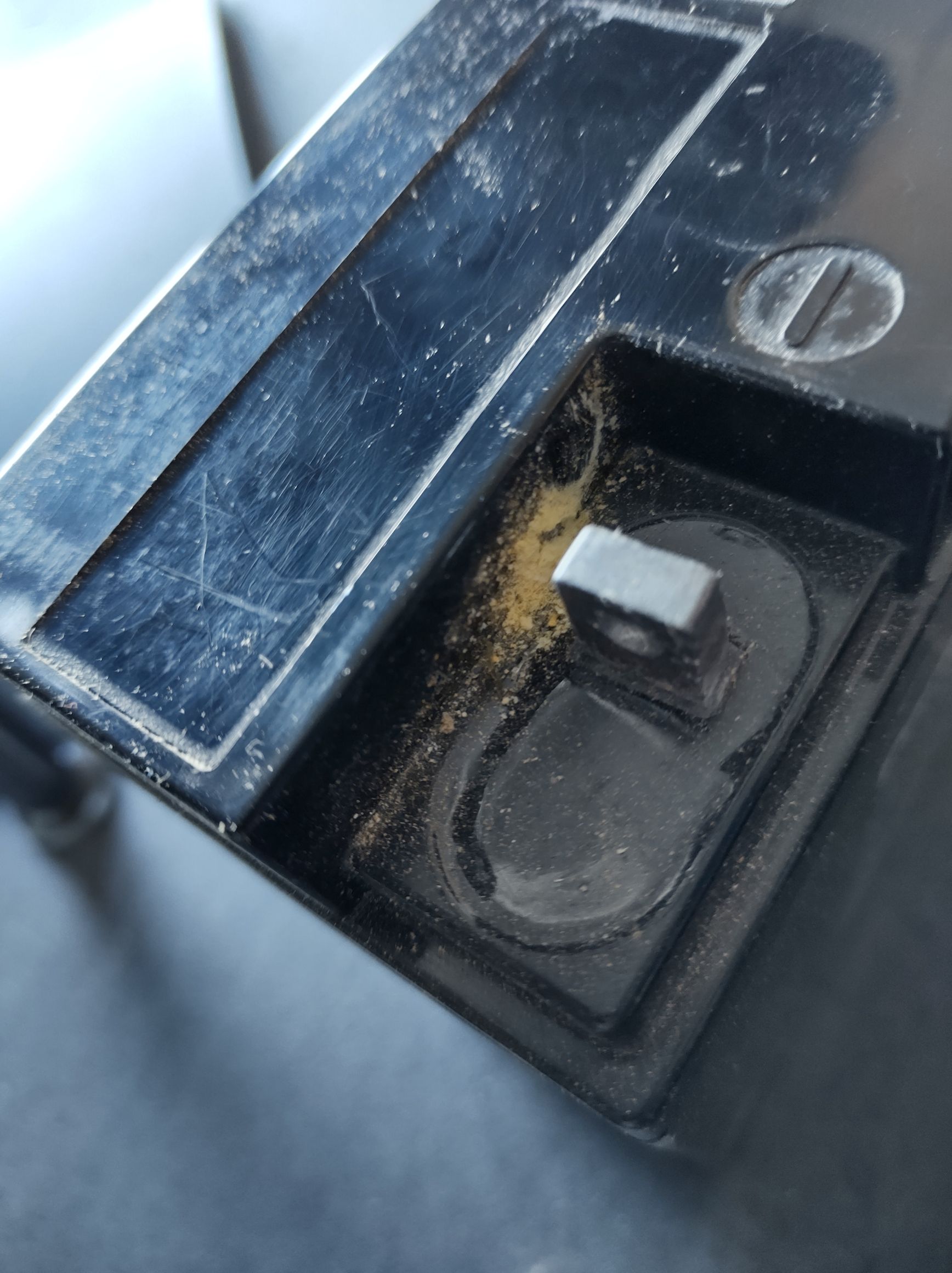

PostPosted: Thu Jan 20, 2022 2:09 am    Post subject: Residue on negative battery pole Reply with quote
Had a look at the battery today (currently pretty cold and cranking not to flashy) and did see some residue on the negative battery pole, this is a Panasonic LC-XC1222P any idea what this is coming from and what to do/check next?

PostPosted: Thu Jan 20, 2022 6:44 am    Post subject: Residue on negative battery pole Reply with quote
Is it green?

PostPosted: Thu Jan 20, 2022 6:53 am    Post subject: Residue on negative battery pole Reply with quote
Hi Sebastien,
don't ask me I have a red-green deficiency, so my green is different from yours Sad I would tend more to a yellow, did you have a look at the picture in the link?
BTW just made a capacity test (start voltage 13.05, start Amps 3.54, stop voltage 10.75 volt with 3.1 A) after 4h 48 minutes

PostPosted: Thu Jan 20, 2022 7:06 am    Post subject: Residue on negative battery pole Reply with quote
Sorry Werner, I had not seen the attachment. It looks yellow to me as well so I'm not sure what it is. My best guess is that the battery is leaking fumes or battery acid and that's the result but I've never seen that colour before.

PostPosted: Thu Jan 20, 2022 7:35 am    Post subject: Residue on negative battery pole Reply with quote

Honestly, it just looks like dirt, to me. Wipe it off & see if you see any cracks/voids in the plastic or the sealant around the terminal. I'd have expected any corrosion to start at the terminal itself, and taper away from it; it looks like that stuff is in the inside corner of the case material.
Charlie

PostPosted: Thu Jan 20, 2022 9:25 am    Post subject: Residue on negative battery pole Reply with quote
Charlie
Agreed. The seal between battery posts and interior chemistry
is usually pretty good in AGM batteries. Also, the
stuff is a strange color for battery corrosion product.
Normally a compromised seal causes corrosion to
encircle the whole post
https://mechanicbase.com/wp-content/uploads/2019/07/battery-terminal-corrosion.jpg
if the products of oxidation are just from battery
internal chemistry, the color is dingy white. If
the corrosion has spread to include some terminal
materials or wire, you'll get some blue-green
stuff too.
One good check is to pour a bit of water saturated
with some baking soda on it. If you get a good 'fizz'
then there's products of electrolyte corrosion in the
residue . . . otherwise it's something else.
According to an 'old' data sheet on this product . . .
http://aeroelectric.com/Mfgr_Data/Batteries/Panasonic/lc-x1220p.pdf
the battery should support a 3a load for something on the
order of 6 hours. How old is the battery? If it seemed
weak cranking the engine, then it may well be demonstrating
high resistance and reduced capacity.
If you can get your hands on a 'real' battery tester
like this
https://www.harborfreight.com/500-amp-carbon-pile-load-tester-91129.html
make sure the battery fully charged (on maintainer until
the charge light goes out), then load the battery down
to 9 Volts and hold it there for 15 seconds (the
harbor freight tester has a handy timer for this purpose).
This battery will produce a 15 seconds crank at better than
500A when new, 300 or less along with your flagging cap-check
suggests nearing end of life.
out of that stuff?"

PostPosted: Mon Jan 24, 2022 3:25 pm    Post subject: Residue on negative battery pole Reply with quote
SO it took me some time over the weekend to react sorry.
Charlie
I cleaned it off and checked under a magnifying glass but can not see any cracks/voids, the same stuff was as well on the screw and the cable shoe. Looks yellow like sulfur.

had to buy baking soda first and did try it out seems no reaction at all got a brownish paste.

Panasonic dropped many of their types, looks like they get out of VLRA business.
The LC-XC1222 is flagged as end of life   (XC was their notation for Cycle long life type)
with that same form factor only the
LC-P1220 15mOhm
LC-PD1217 17mOhm
are available
I found as well two interesting documents, a VRLA white paper about internal resistance and VRLA Handbook with all current models.
found them here (scroll down) https://industry.panasonic.eu/products/energy-building/batteries/battery-cells/secondary-batteries-rechargeable-batteries/valve-regulated-lead-acid-batteries
On the US site I found two different 17Ah batteries (all flaged as discontinued):
Cycle and trickle use LC-RD1217P  12mOhm
Long life trickle use LC-PD1217       17mOhm
Looks I should search for a cycle use battery as that one has the lower internal resistance
Or swap to an Odysee as they claim 7mOhm for the same form factor

Living in Switzerland it's not so easy to get such a unit (all this high amp testers are 500-1000 $!!) I did source a 100A one (see link below), so will test soon (ordered via a friend in the US that 500A "clearance" model for the future Smile
https://www.harborfreight.com/100a-612v-battery-load-tester-61747.html for 2.5x the price Sad
It's strange, so far these batteries lasted always around 5 years, this one is not yet a year old Sad
  like this
business.
LC-P1220 15mOhm
LC-PD1217 17mOhm
are available
discontinued):

Thanks Charlie,
I can find similar Amazon offers down to 40 Euros, the poles look a bit
less solid then on the Panasonic once, they are as well available
17/20/22Ah from different brands the housing looks similar for each of
them would be nice if one could get more technical details.
Pansonic did offer two different lines where one was with less internal
resistance then the other, The PC680 is available for around 125 Euro.
What just did make me wonder I had in 17.5 years used 3 batteries
(17/20/22Ah they all lasted well, this last one lasted just 10 months,
no idea why....
Cheers Werner (the 100A tester will be in 2morrow)
