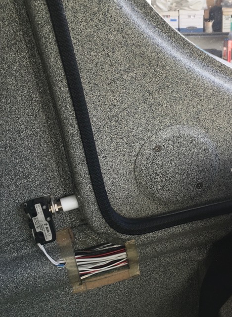

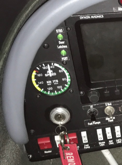

I must say that I get much reassurance from my grab-pads, microswitches, and 2 green LEDs on the panel to avoid this particular calamity:
[img]cid:F6F3343D-667A-4028-AD3B-DC7A265CE89F[/img]
[img]cid:C6285661-48FA-4173-83F2-96F9F32DD99F[/img]
[img]cid:4987561C-F556-453A-BB2D-3F753B03BAD5[/img]
