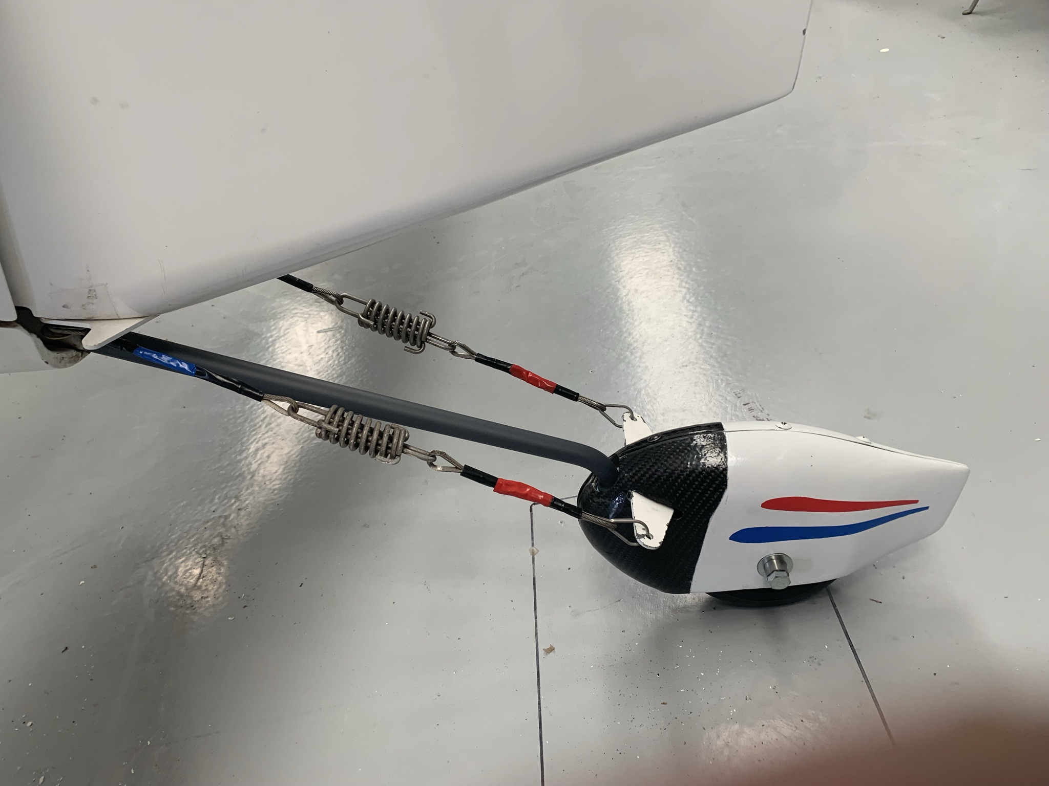

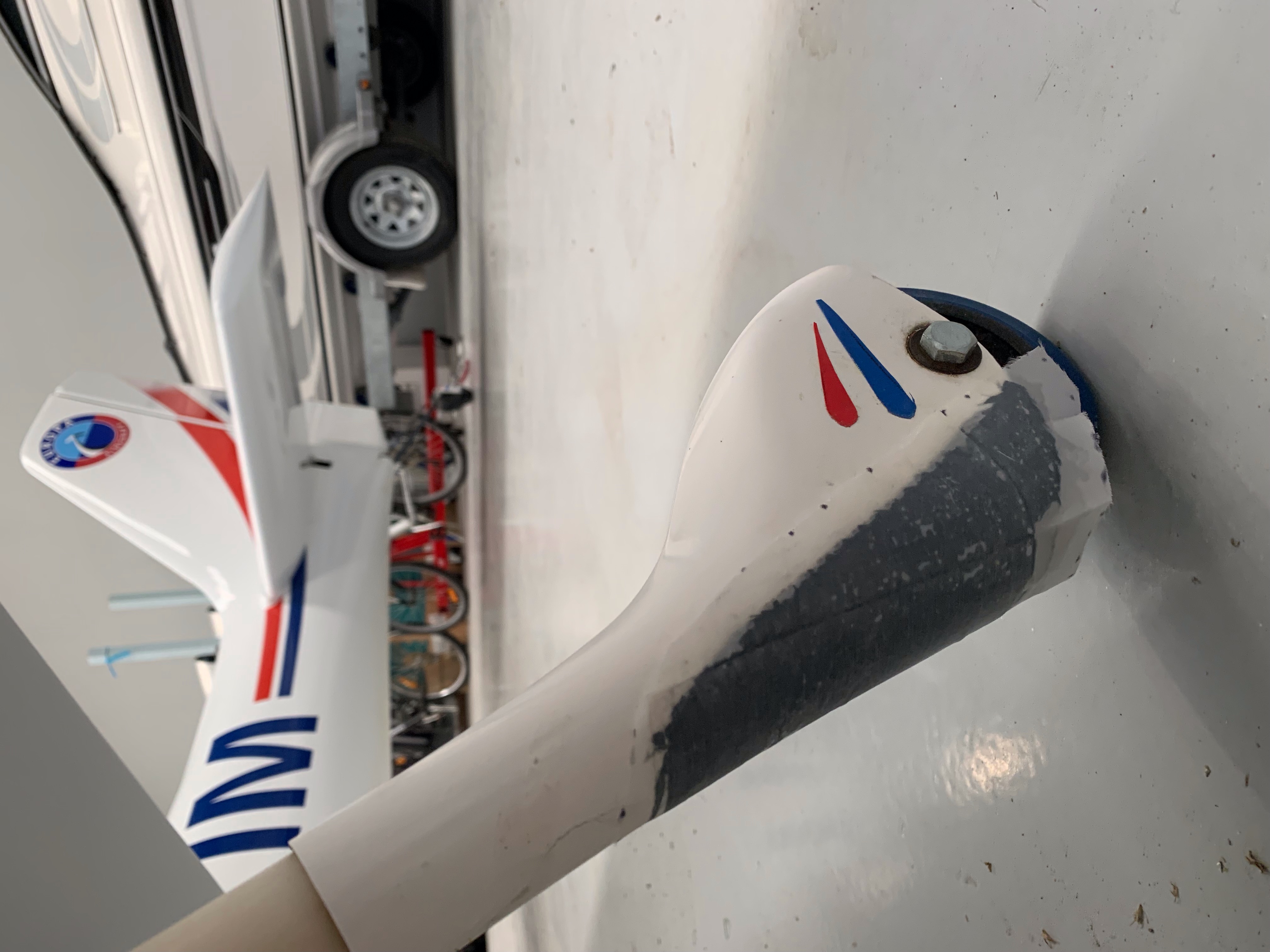

In the last month I worked on the speed kit fairings for the outriggers and tailwheel.
They needed protection to withstand the loose stones from a paved tarmac, particularly the tailwheel fairing, which gets substantially damaged due to being in direct line with the main wheel. Using carbon fibre I did two layups, using peel ply, and then a coating of UV West System epoxy. Photo of outrigger show peel ply stage before trimming.

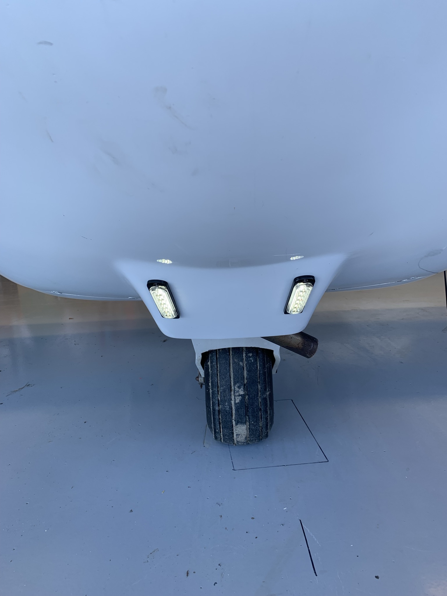

Also installed flashing LED Landing lights on the bottom engine cowl.
See photos. Hi So far, so good.
