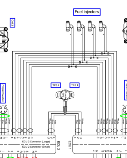

cluros(at)gmail.com
PostPosted: Sun Dec 26, 2021 1:55 pm    Post subject: ULPower Alternator/Regulator Reply with quote
On Sun, Dec 26, 2021 at 1:37 PM Robert L. Nuckolls, III <nuckolls.bob(at)aeroelectric.com (nuckolls.bob(at)aeroelectric.com)> wrote:
>From their website, all the UL 350 engines are listed as having integrated PMA charging systems with external R/R. All listed at 30 amp total and requiring 15 amps for the engine ignition and fuel pumps, leaving15 amps for Avionics.
  Okay, thanks . . . is there a recommended system
  wiring diagram I can access?
  out of that stuff?"
UL350_Electrical_System.pdf
Download
 Filename:  UL350_Electrical_System.pdf
 Filesize:  385.81 KB
 Downloaded:  464 Time(s)
user9253
Joined: 28 Mar 2008
Posts: 1978
Location: Riley TWP Michigan
PostPosted: Sun Dec 26, 2021 5:28 pm    Post subject: Re: ULPower Alternator/Regulator Reply with quote
If that 40 amp fuse blows, the engine quits. Remove it.
Repurpose that 40 amp fuse to protect the electrical system from a shorted
alternator or its "B" lead. Or use a fuselink.
Good workmanship will prevent the engine busbar from shorting out.
Relocate the engine Fuses. They should be between the busbar and the switches.
The 60 amp fuse is not needed. Eliminate it.
I suggest that you use battery contactor in series with the aircraft main power bus
(not to be confused with the engine bus).
There should be a fuse between the engine busbar and the start push button.
Joe Gores

On 12/27/2021 6:53 PM, Sebastien wrote:
There are two documents mentioned in this discussion Charlie. One is the ULPower diagram I attached to the thread, the other is a document that I cannot share at this time. I was reviewing this document and found several problems with it and was trying to help them correct these problems by pointing them to the installation instructions from ULPower. Unfortunately while these instructions are much better than their current architecture, I'm still finding them problematic for their own reasons as Joe and Bob have pointed out. I have also pointed them to the AEC and Z101b.
They seem receptive to suggestions but the aircraft is already built. I'm not sure how far they are willing to redo the electrical system. As it stands there are 3 circuit protective devices, one solenoid, and one switch between the battery and the EDC. The alternator power goes through 2 extra protective devices and an additional solenoid before getting to the EDC for a whopping total of 8 points of failure in series between alternator and engine but only 5 from the battery.
On Mon, Dec 27, 2021 at 4:35 PM Charlie England <ceengland7(at)gmail.com (ceengland7(at)gmail.com)> wrote:
--> AeroElectric-List message posted by: Charlie England <ceengland7(at)gmail.com (ceengland7(at)gmail.com)>
On 12/27/2021 6:22 PM, Sebastien wrote:
> No, it was sent to me by a member of our local Recreational
> Aircraft Association and was created by a friend of his for his Zenith
> 750.
I thought we were talking about ULPower's diagram in their installation
manual. Are we talking about some individual's self-created diagram?
Ah; got it now. If it's a dual ECU, the factory diagram has its own issues, that while they may not be single points of outright failure, they could cause serious issues with engine operation. For instance, it looks like a failed injector current sink (switches, labeled A, B, a, & z)  in either ECU could cause the injector to stay open.
[img]cid:part1.nZY0Ilt8.ek2QY5wG(at)gmail.com[/img] Virus-free. www.avast.com [url=#DAB4FAD8-2DD7-40BB-A1B8-4E2AA1F9FDF2] [/url]
 Filesize:  80.27 KB
 Viewed:  11990 Time(s)

PostPosted: Mon Dec 27, 2021 5:32 pm    Post subject: ULPower Alternator/Regulator Reply with quote
In this particular case it's a single ECU installation. Single battery and alernator as well.
On Mon, Dec 27, 2021, 20:25 Charlie England <ceengland7(at)gmail.com (ceengland7(at)gmail.com)> wrote:
> 750.
Virus-free. www.avast.com [url=#m_-8456691566823616747_DAB4FAD8-2DD7-40BB-A1B8-4E2AA1F9FDF2] [/url]
 Filesize:  80.27 KB
 Filesize:  80.27 KB

PostPosted: Mon Dec 27, 2021 5:48 pm    Post subject: ULPower Alternator/Regulator Reply with quote
I've found that a failed open injector in flight is of little concern.
At high power settings it may not even be noticed.  At mid power levels
it might run a little rough. Close the throttle too far and it merely
encourages you to not reduce power too much until you have to.  Most
injectors are sized to run fairly high duty cycles at full power.
Ken
> Zenith
> > 750.
> installation
<https://www.avast.com/sig-email?utm_medium=email&utm_source=link&utm_campaign=sig-email&utm_content=emailclient&utm_term=icon>
<https://www.avast.com/sig-email?utm_medium=email&utm_source=link&utm_campaign=sig-email&utm_content=emailclient&utm_term=link>
<#DAB4FAD8-2DD7-40BB-A1B8-4E2AA1F9FDF2>
