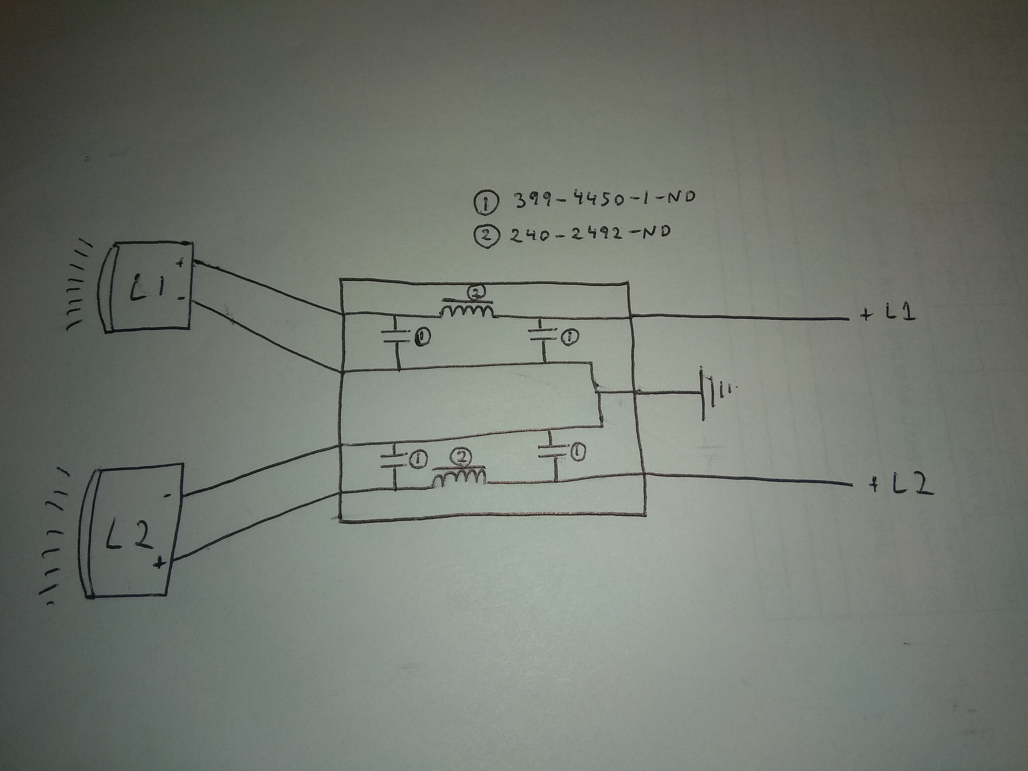

Another thing is we ordered about twice as many lights as needed and picked the ones with the lowest noise.

cluros(at)gmail.com
PostPosted: Fri Dec 17, 2021 5:04 pm    Post subject: Static On GTN-650 Reply with quote
We had the same problem with our amazon lights making noise in the intercom. Better headsets helped, finding one wiring problem in the intercom wiring helped, but the biggest fix was adding some noise filters to the lights. Here's the little filter box I made. It's not a great diagram, the box around the electronics is not wiring, it's a box.

eschlanser
Joined: 08 Apr 2010
Posts: 60
PostPosted: Mon Dec 20, 2021 9:31 am    Post subject: Re: Static On GTN-650 Reply with quote
[/quote]
Can anyone help me understand what the component symbols and numbers in the diagram refer to? I understand that they refer to components in the diagram, but what are they? I could not find them in review of electrical component symbols and the associated numbers.
A picture of the completed device would help a DIY builder understand it. if its not too much trouble.
As the OP asked, if anyone is aware of a reference to a commercially available device, it would be appreciated.
I'm a little surprised that the GTN 650 would be susceptible to such interference. I wonder if the Garmin help technicians have anything to say about it? Many years ago, my little GPS 92 would go blank whenever I tuned the nav radio to our home field VOR frequency. Astonishingly, the Garmin help tech denied such a thing could be happening.
Thanks,Eric
