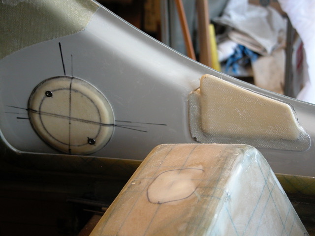

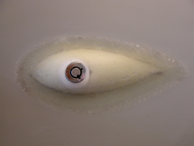

Has anyone got a clever solution for securing the aircraft doors - for example in a strange airport  overnight?
Will,
Under some guidance from a locksmith, I’ve installed those cylindrical key locks often seen on vending machines.
If you’re interested, I’ll pull the interior cover plates and take some photos of the catch which prevents retraction of the shoot bolt.
Fred
[img]cid:17d810223bb3fc2b3d81[/img]
[img]cid:17d810223bb3aa429fb2[/img]
