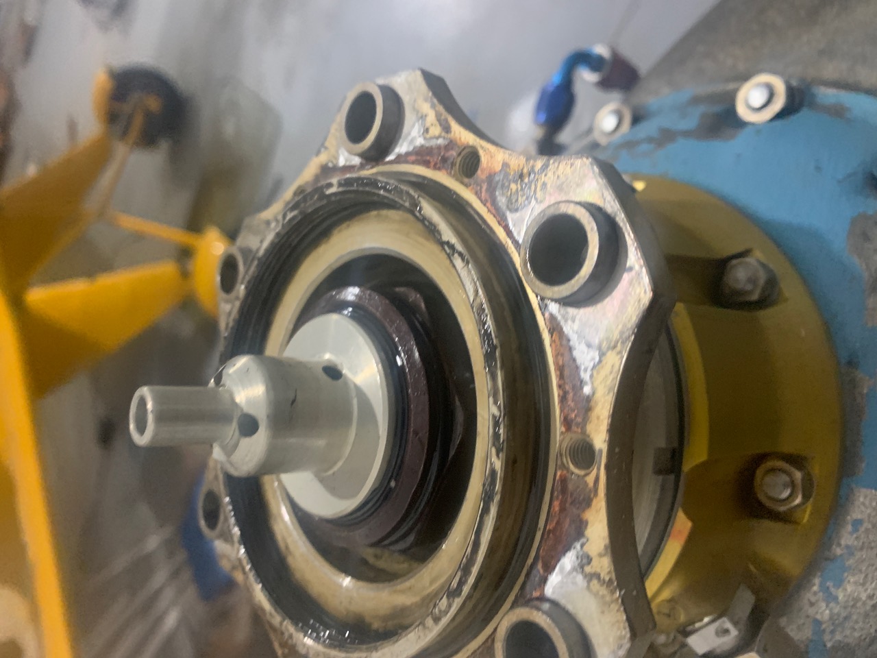

I have a great deal of reference information on LOM engines and props, but I can find nothing at all about the constant speed prop adaptor shown in the picture below. I assume the gold part contains high pressure seals and passes oil into the crankshaft, then through the aluminum turning and into the prop.
Does anyone have any information on this assembly? I need to convert the engine to a fixed pitch wooden prop and a drawing would help me do that with more confidence.

My challenge is how to remove the prop hub and the gold colored seal assembly. There appear to be no drawings available for that. The problem with working on props is that without a drawing is that you can't tell whether something isn't supposed to come off that way or just needs a bigger hammer Smile Steve-- Stephen BeaverTel: 614-937 4189

Yes, I see the problem now Forgot that my engine arrived with the gold coloured hub attached
If you do get it off what will you replace it with?

The forward nose bearing case from a 332A or AK Steve-- Stephen BeaverTel: 614-937 4189
