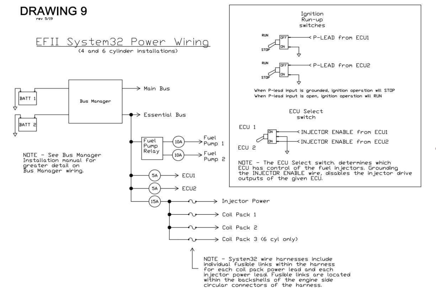

It *might* work, if you could dial the pressure up to electronic injection levels. The pump is possibly capable of that much pressure; but I just don't know if Andair would configure it that way. There's also the issue of additive pressure, though I suppose that if you kept the bypass regulator between the 2nd pump & the engine, it would probably work. I'd want test data; either my own or the pump mfgr's before installing that kind of setup.
I just downloaded the System32 install manual and scrolled down to the power wiring page. I tried to find the Bus Manager install manual (ref by the NOTE on this page), but couldn't find it on their web site. Comments are based on what I can see, with available docs from the mfgr that I could find.
Looking at the diagram, I see three (3) (scratch that; at least 6; likely quite a few more if I could see inside the box) single points of failure, on this one page, any one of which *would* stop the engine. Depending on how you count failures, I can see closer to a dozen. All of those failure modes are hardware related; they don't count control logic (inside the 'black boxes'), which I can't see. Now some of them are quite unlikely, but some have a much higher probability of occurring, and there are relatively simple fixes for all of them. (Doing FMEA doesn't really look at probabilities; it looks at Effects.) I keep coming back to the mantra of: if it's nearly impossible to make redundant (like the wing spar, or only one throttle body on the engine), I'll evaluate and likely accept the risk, but if it's relatively easy to provide a backup for flight critical items, I'm going to find a way to do it.
Please believe me when I say I'm truly not trying to be insulting, but I would not want to fly in a plane wired like that. There's just not a diplomatic way to tell someone that an easily corrected thing could kill them if not corrected. If I haven't offended you System32 users too much and you're interested, we can discuss some of the failure modes and ideas to fix them.
Charlie

The fuel pump symptoms you describe are totally normal. If you run both pumps, they will each require their own full rated current while running. Total fuel pressure shouldn't change more than a few PSI if the regulator is sized properly. Excess fuel is bypassed by the regulator back to the tank. Upside is that if one pump fails during a critical phase of flight, fuel delivery doesn't even 'hiccup'.
Auto-switching of the pumps: If that's totally inside your 'black box', do you *know* that black box doesn't have a single-point-of-failure inside? Knowing means having the schematic for the guts of the black box, and a full understanding of the circuit.
If you're using B&C regulators, I believe that the regulator is powered via pin 6 ('bus'). The various pins and their functions are described in their manual, here. Not sure why they labeled pin 3 as 'OV' since the manual says overvoltage is sensed at the supply pin (6). Pin 3 is a 'remote sense' line that the regulator uses to accurately measure bus voltage so it can set proper voltage, and does the secondary job of detecting *under* (low) voltage.
I can't specifically address the EFII system, but coil packs typically consume fairly low current, compared to the injectors. Injectors can have relatively high inrush current each time they fire.
This: "They have the coil packs and the injectors all being fed by 1 15 amp fuse." just *screams* SINGLE POINT OF FAILURE at me. I could be wrong, but I'd want to be absolutely certain about it. Play what if. Short one wire to ground or short one coil internally to ground, etc, somewhere downstream of that fuse. What happens to the engine?
Charlie

On Wed, Nov 10, 2021 at 7:11 AM Charlie England <ceengland7(at)gmail.com (ceengland7(at)gmail.com)> wrote:
Charlie
On Tue, Nov 9, 2021 at 8:48 PM melstien <michael(at)elstien.us (michael(at)elstien.us)> wrote:
--> AeroElectric-List message posted by: "melstien" <michael(at)elstien.us (michael(at)elstien.us)>
Hello John,
Yes, I like to keep track of my changes so I try to add revision tags. I don't always remember.
I will take a look at the failure modes and probably better align this to the Z101 and also try to organize it so it makes physical sense. That will also allow me to see where all my connection points should be. Currently it is just electrically correct (or will be if people suggest good changes)
I will add separate filed switches on the alternators. I was not sure and that was one of my questions.
The 40 Amp AC will be an experiment. I do not plan to add it to the alternator load except during level flight at altitude and near an airport. AC is a luxury. The Earthex batteries can draw at least 100 amps continuously so I think they will pick up any sag and my IBBS batteries on critical avionics are also meant to do that as well.
Engine Bus answers:
6 Cylinder as opposed to a 4 cylinder
Yes, everything will have its own power lead and the coil packs will have a fusable link and a breaker
Injectors will have a fusible link only
I planned to not have the pump on automatice failover but to run them both during takeoff, landing and fuel tank switch-overs but Robert at FLYEFII did not suggest that. he thought it might cause cavitation on the inlet. My testing using my actual fuel lines and pressure regulator indicated that running both at the same time more than doubled the current draw (4.9 amps per pump solo) and the fule flow increased marginally. I think they were both fighting each other to supply pressure at the pump outlet and it was still only going through qty 1 -3/8 inch hose.
I had thought about splicing each injector wire and coil pack power feed into 2 wires and feeding them off Engine Bus A and engine Bus B all with diode isolation.  The schematic looked cool but it introduced to many connections points which would probably have increased failures.
FLYEFII suggests a 10 Amp fuse for the for the pumps and my load testing indicates they only use 4.9 when run separately. I can review the wires size I used and see if it will support a 12 or 15 amp breaker.
FlyEFII did not state what the coil pack would need when powered separately. They have the coil packs and the injectors all being fed by 1 15 amp fuse. I suspect that the coil packs will still need a 15 amp fuse per coil pack because they all charge at different times, so splitting them into 3 does not reduce the peak current, just the frequency it occurs. (I am a Mech Engineer so I am looking for guidance on that.) I have reached out to FLY EFII and requested guidance.
FlyEFII informed me that the system at high RPM will consume 11 AMPs. That is all I have to go on. to meet my 1 hour of reserve, I can always move up the ETX 1200 battery. Its the same form factor and will carry an 18 amp load for 80 minutes. If that is not enough there is always the ETX1600 (120Amp/hours). Even two of the 1200's weight less than 1 PC680. Money is just the issue. Not a place to skimp.
Regarding the coil packs, cylinder 1-4 are spread across coil packs A and B so they are redundant.   If you lose A or B you still have 1 working plug per cylinder 1-4. FLY EFII added the 3rd coil pack and both plugs for cylinders 5 and 6 are on the same pack. I have informed FLYEFII that I would suggest a different arrangement so both plugs were not on the same coil pack. I do know of a person who lost coil pack C and the engine ran without too much vibration, but I need to check into that story.
I have 2 LR3Ds and the higher output backup alternator. I just noticed they come with an amber light. I will ties these outputs into my EFIS but a good light is also nice. I Prefer LED for lower heat and better vibration and longer life.
OV Sense, so this is the contact that senses the buss voltage and is used to increase or decrease the voltage ouput? I have them both going to the Main Bus, but maybe the backup should go to the engine bus. There is a possibility the main bus has power but the engine bus does not. Your thoughts?
I reviewed your diagram and it is really what I intended mine to be, only with the second battery.
Thanks for the feedback. I appreciate it.
