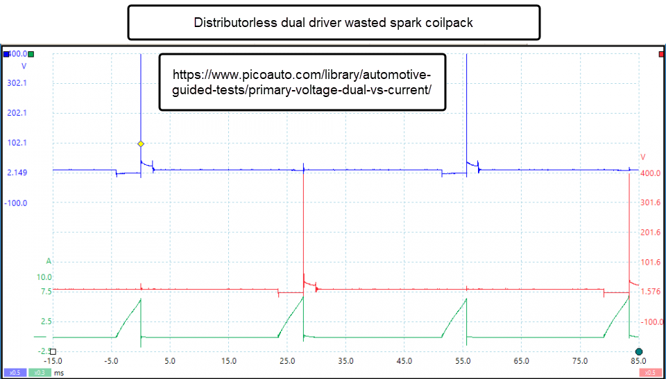

    * To my knowledge, the four-cylinder coilpacks ramp up from 0 to 6.5A in a sawtooth 4.3 mS wide twice per rev for an average current draw of 1.1A at 2,400 RPM. Disclaimer: The sawtooth height (current) and width (time) did not come from SDS but the resulting current draw calculation matches what SDS says per coilpack "a little over 1A at 2,400 RPM". I imagine the six-cylinder coilpacks will simply draw 50% more average current because they operate 50% more cylinders. (FlyEFII System 32 is different because it uses three four-cylinder coilpacks in six-cylinder applications whereas SDS uses two six-cylinder coilpacks.)

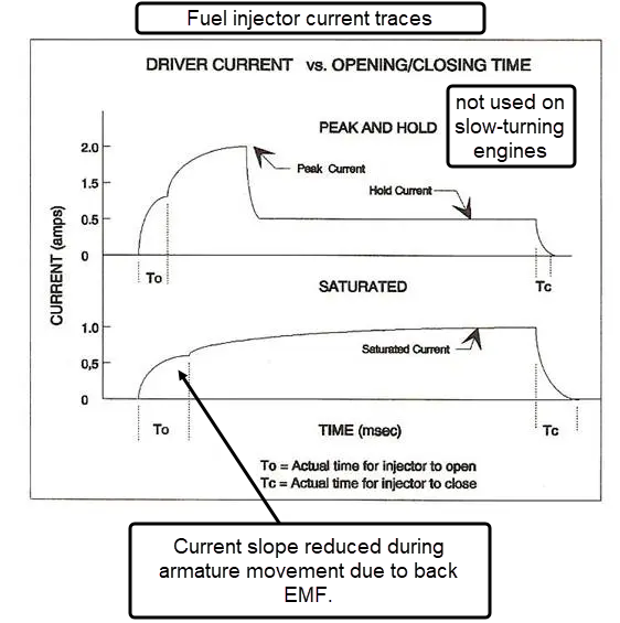

    * Ref attached oscilloscope images.

A magnetic solenoid is an inductor and in an inductor current lags voltage. This applies to the single-coil and no-current-regulating-driver solenoids we comonly use like relays, contactors, saturated-core fuel injecors, and also to inductive coilpacks.
Some solenoids that do have an inrush current:
    *Dual-coil solenoids that reduce current after the armature moves and closes the magnetic air gap. This because the solenoid produces more force when the air gap is closed so it can be held closed with less current. Ref for instance Bob Nuckolls "Let's Talk About Starter Solenoids": http://www.aeroelectric.com/articles/strtctr.pdf
    * Peak-hold fuel injectors that use current regulating drivers to overdrive the solenoid to make it close faster then back off the current once the injector is open aka solenoid air cap closed.
    * Contactors and relays that have peak-hold current drivers built in. I have not seen these recommended by Aeroelectric Connection but they do exist.
    * Alternating current solenoids that have a moving armature have an inrush current because inductance increases when the air gap closes. But we are talking about direct current in OBAM aircraft.
I doubt peak-hold injectors are used on direct-drive aircraft engines because the advantage is increased dynamic range (due to faster opening and closing times) of fuel delivery from idle to full power high RPM and 2,700 is not high RPM. The saturated-core fuel injectors that came with my SDS system have 14.5 Ohm coils and the peak-hold injectors I remember from the 1990s were 2.5 Ohms so that is a way to tell the difference.
