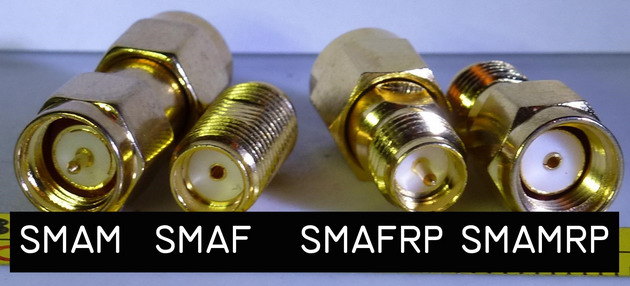

Here's a cheap experiment with a high order
probability for success:
https://tinyurl.com/4jffpbd3
There are numerous examples of this type of
antenna. Magnet mount(I presume you have
steel roof too).
5' cable built in. Note connector style.
There are 4 variations on a theme for
SMA connectors. It's likely that this antenna
will mate with one of the jacks on your router
but not a 100% bet. You might search around
eBay for one that DOES mate . . . or get an
adapter.
This is not a free lunch endeavor. Energy
that USED to circulate around the interior
will be approximately halved. One half
being conducted outside. Radiation patterns
are a toss up too. But the outside
performance WILL be improved.
