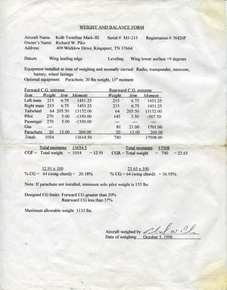

Something doesn't sound right. I have done a lot of mods to my MKIII but nothing to move the weight fore or aft much, I have a 582 and need no ballast.
I assume you are using the Kolb forms on page 41, 42 & 43 of "The Yellow Book"? If not, PM me, I'll email them to you. FWIW, here is my W&B:

PostPosted: Wed Oct 06, 2021 3:57 am    Post subject: Mark III weight and balance Reply with quote
My "yellow book" is a small book of builders plans, no w&b info.I've got a blue book though that doesn't have any forms, but does tell me that 25-35% is the range at 9 degrees, and 66" is the average chord, so I just worked off of that.
My measurements for the main arm and tail arm are pretty much identical to yours (I figured the tail wheel was 1/2" farther back)
Have you ever measured weights fully loaded, with the pilot and all?
Rather than estimating moments for the pilot/gas/parachute, I just went the route of weighing the entire craft with me in it.
I did also weigh it without me, and did some reverse calculations to come up with the pilot/passenger arm measurement, and I decided that it's actually a positive 0.15" for myself instead of the -5" that you used.  That's a change of about 3% forward with no passenger, and nearly 10% with a passenger also - not saying that yours is wrong at all, but if I used that number, I wouldn't have nearly as much weight on the floor either.

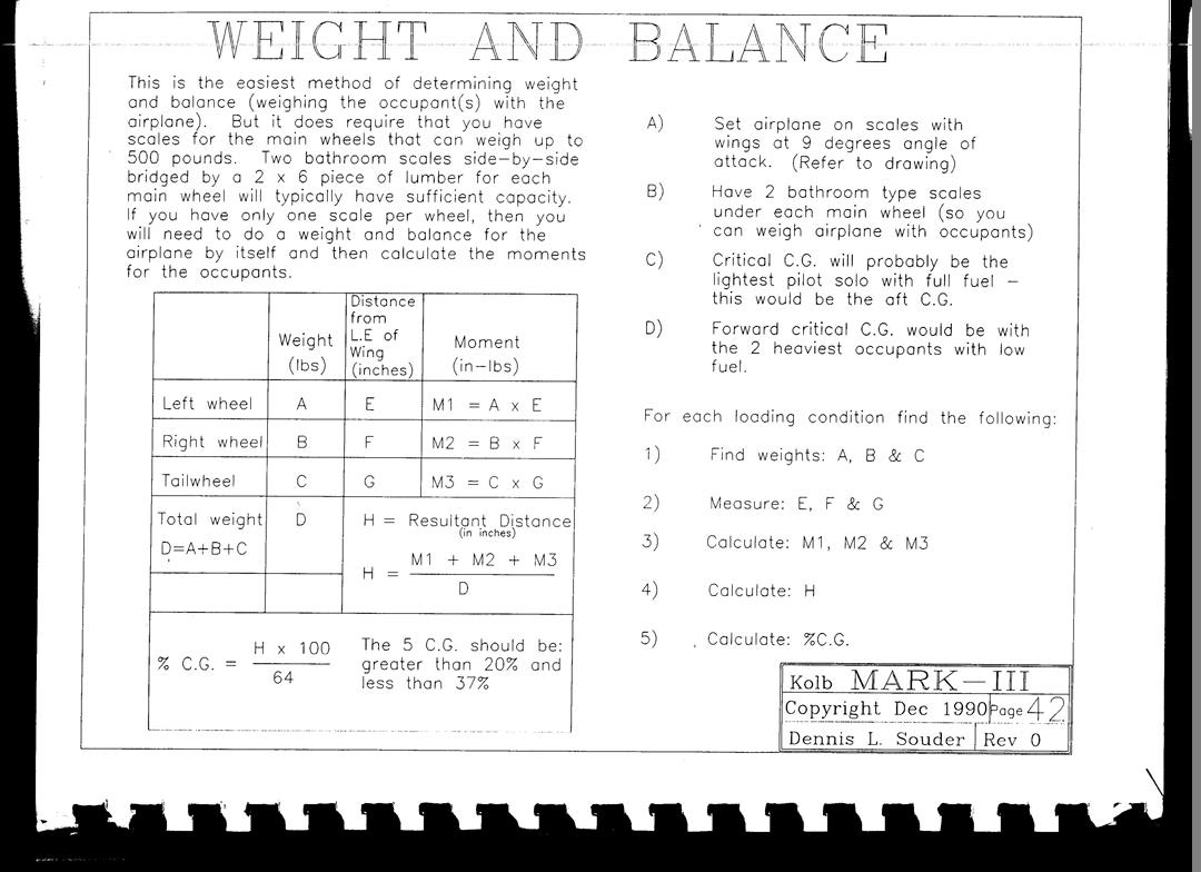

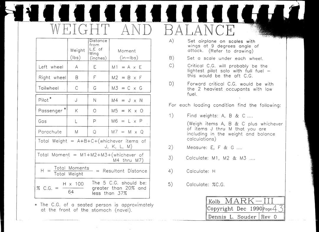

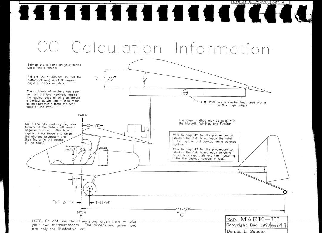

Here are the forms:
You don't have to actually sit in the airplane or have your pax sit in it; figure out where the bellybutton is going to be and compute the weight from the datum to that point.

PostPosted: Wed Oct 06, 2021 4:44 am    Post subject: Mark III weight and balance Reply with quote
Thanks for the pages!I understand that the navel is generally thought to be the cg of the seated person, but that's got to vary by person/build/weight as well.  Seems to me that simply weighing all together takes out that variable (though of course you don't want to weigh the craft again for every new passenger, so an average is probably a good idea)

PostPosted: Wed Oct 06, 2021 8:35 am    Post subject: Mark III weight and balance Reply with quote
On thing I haven't seen mentioned, does the original poster have the aircraft setup according to level flight? What I mean is most tailwheel airplanes need to have the tail raised to a certain position for level flight when using the scales to determine w&b. If the scale is on the floor instead of raised up, it would show more weight on the tail which would make it seem more ballast is needed up front. That leveling process should be spelled out on the w&b sheet in the drawings. If the OP doesn't have the drawing maybe someone can take a photo of that page. Just a thought.

PostPosted: Wed Oct 06, 2021 9:14 am    Post subject: Mark III weight and balance Reply with quote
Yeah, I've got a block under the tailwheel to bring the bottom of the wing up to 9 degrees, as specified in the manual.
