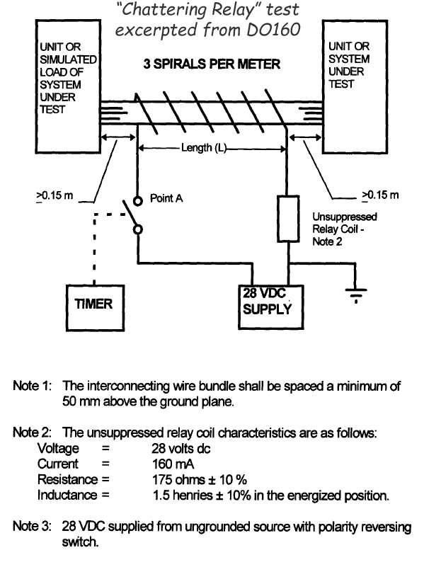

In fact, legacy DO160 qualification testing used
to include what was commonly called a 'chattering
relay' noise test illustrated here. The "timer"
switch was simply the normally closed contacts
of the test fixture relay, I.e. a 'buzzer'.

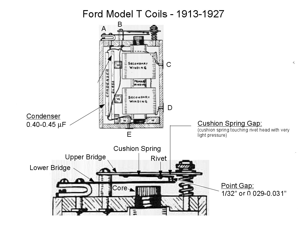

The Model-T spark coil was another 'buzzer' where
the buzzer coil shared a core with a bazillion
turns of fine wire where one could exploit very
high voltage transients that would jump the
gap in a spark plug.

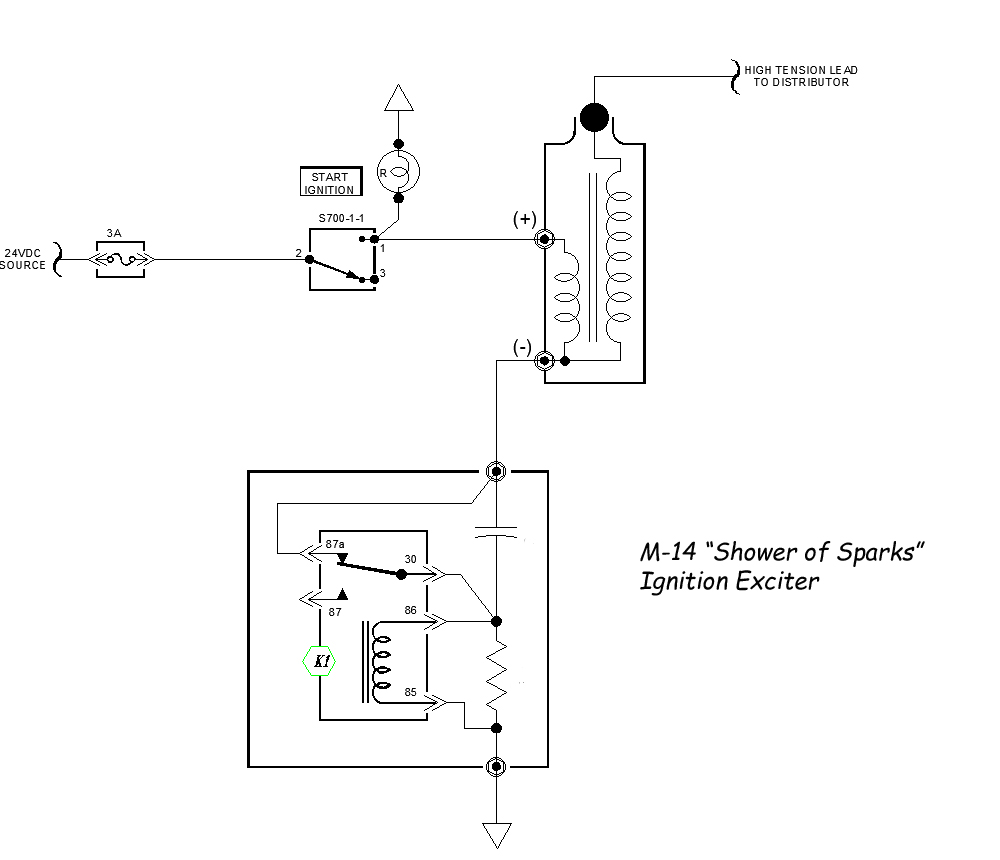

A modern exploitation of the same phenomenon
is illustrated in a 'shower of sparks' starting
ignition for an M14 radial engine I crafted for
a YAK driver.
