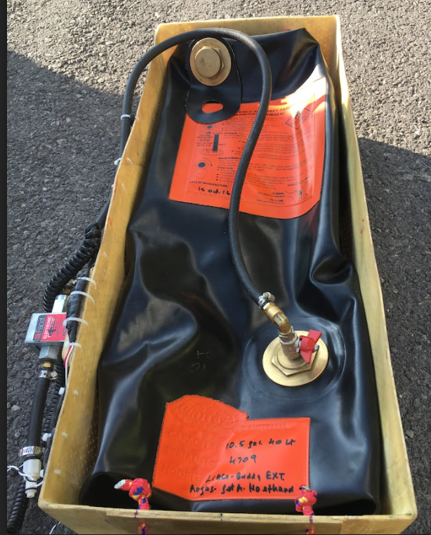

I have a turtlepac bladder with a facet pump which connects to the breather fitting.
[img]cid:ii_ku5h44tf0[/img]

Many have considered an idea a couple of us had and implemented for the Europa Aux Tank.
The Europa Aux tank install is standard, but the bulb and siphon is dropped in favor of a pump in my shop normally.  But not all.
We felt that impatiently waiting for the fuel in both the reserve side and aux tank to lower simultaneously was not for us Type A types.
Erich Trombley and Richard Kundle used a Piersburg pump so they’d have a spare to transfer the fuel.
Others simply used a Facet pump similar to the 912 pump.
I’ve put a power source in the pax headrest and a hand switch (like a remote starter switch) to hold.  I normally used a cigarette lighter fixture in the headrest and the switch plugged in.  The Facet pumps about 30GPH or ½ a US gallon in 30 seconds.  I have had bad experiences with Aux tanks that have panel mounted fuel switches as once the main is full and you forgot the switch was on, the remaining fuel still in the aux tank will overfill the main tank and vent overboard.  So, the fuel switch needed some sort of stop.  Installing a fuel shutoff switch in the tank wasn’t a fun time I wanted to commit to.  Timers work OK but again, aren’t full proof.  The hand switch was irritating enough to remember it was on and was cheap, easy to use and easy to remove when not needed.
Flight technique:
                Takeoff and climb, level off and cruise until the fuel quantity drops to about the 10 gallons remaining line, then turn on the pump and transfer the gas for about 5 minutes or 2.5 gallons. Good in-flight test for checking transfer and planning.
Cruise a while longer and pump some more.  (With a sight gauge I prefer my clients to burn down until the sight gauge is down to the arm rest, then squeeze the trigger for a while to transfer the rest.
Another technique is to change out the fuel selector.  Andair has a nice 4 way valve (Left,Right,Aux, Off).  Andy will re-label it Off-Main-Reserve-Aux.  Plumb the Aux tank into the selector.  Consider a small Facet pump to reduce the suction needed of the 914 or 912 pumps.  Install a marine style fuel gauge in the aux tank if you want to monitor the fuel transferred.
Flight Technique:
                Takeoff, climb, level off.
                Turn on the Aux fuel tank pump to prime the system.  The bulb may work also to prime the aux to the selector.
                Engine Aux pump to on.  (This helps ensure that there is sufficient draw for the fuel transfer.)
                Fuel Selector to Aux.
                Monitor fuel level and some use clear fuel line to continue to monitor the fuel transfer.
                Turn off the Aux pump as the suction should keep a good fuel draw.
Last type of tank was a Turtle fuel pack in the baggage bay or pax seat.  Again, plumb it into either a 4 way fuel valve, or plumb it into your main tank via the vent as you would the Europa Aux tank.
Pax seat is a good place to put a nice 10 gallon or so tank.  Put in tie downs for sure.  I always liked the rectangular racing type 10 gallon type and modify the clips on the seat belt bolts and add a couple of points to the seat.  Hook into the main tank or your new fuel selector and use a fuel pump as siphon from a lower seat position won’t work quickly enough.
Recompute your weight and balance for loading. The seat tank is best for CG if travelling with baggage.
Just some ideas we have made happen over the years.

William,
I have a long range tank but I have never used the syphon method because I am unable to understand how all the fuel in the long range tank can be used without emptying one side of the main tank too.
In Australia, I mainly find the extra fuel capacity very handy for out and return flights where each leg is over 2 hrs and fuel is not readily available like in other countries.
In one Europa I have, the LR tank plumbs into the existing fuel system and the fuel can be transferred in flight after about 1.5 hrs by means of a fuel pump under the baggage bay area making every litre available from that tank while there is still plenty of fuel in the main tank.
In my other Europa, I don't have the same plumbing so I carry a spare fuel pump with a hose and a piece of aluminium pipe.  The aluminium pipe is inserted into the LR tank and the pump plugs into a power outlet socket and decants the fuel into the main tank via the normal filler neck.  On an out and return flight as just mentioned or a long one way flight, I transfer the fuel either at the destination or a convenient landing spot while we enjoy a cuppa and a sandwich and/or carry out other functions required after being in the air for a considerable period of time.
It works well and I am very pleased I have it.

Aux_fuel_tank_ideas_(1).docx
Download
 Filename:  Aux_fuel_tank_ideas_(1).docx
 Filesize:  470.65 KB
 Downloaded:  382 Time(s)
