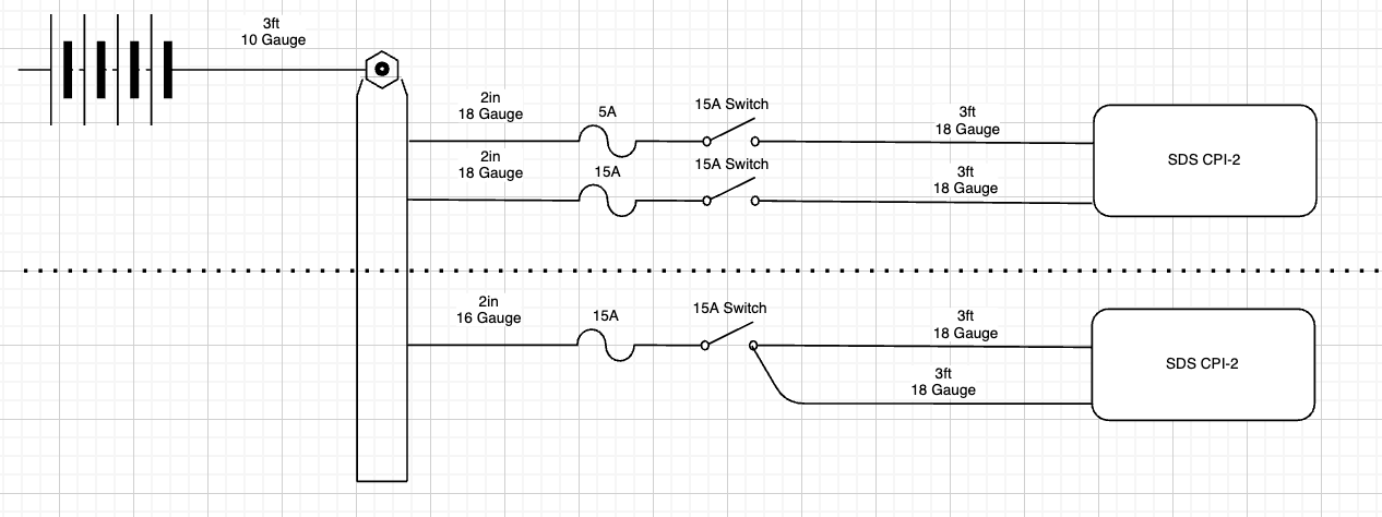

This is how it's designed:
http://www.sdsefi.com/cpi2switches.jpg
There are two wires for normal power, the red coil wire and the purple ECU wire.  For the backup battery both the coil and ECU are powered through a single 18g wire through a fuse:
http://www.sdsefi.com/battbox1.jpg
My current plan is to tie the battery backup to my aux bus which has it's own SD-8 alternator and a small battery.  This conforms to their recommendation of
"Please note, this battery will run a dual system for about 20 minutes at 2500 rpm in the event that the main alternator and main battery go down. If you need more power duration for your typical missions, we suggest you install a larger battery than this one and/or a second backup alternator."
Then, in the system, I would disable the charging circuit as my alternator does that.
1. Don't understand the 2" of wire reference. No practical system will have that. The battery is effectively a rather large 'filter'. If noise from the high-power noise generator (the coils) has to flow all the way back to the battery before traveling down the other power wire to the ECU, the battery can at least partially attenuate some of that noise. And noise isn't the only issue, as has been pointed out in other posts.
The battery is not usually mounted near this stuff, typically you would bring battery power to a bus bar with a large gauge wire, then from that to your breakers and switches then to the device.  In that case, what exactly is the difference between powering each leg through a single switch/breaker or dual switch/breakers assuming that the switches and breakers are within inches of the bus bar. If there is a large difference, how much of it is the short length of shared wire between the bus bar and switch/breaker and how much of it is the fact that you are sharing a switch/breaker?
Perhaps a picture is best.  How much noise rejection difference would one expect in the following:
[img]cid:part1.BBE86B4B.E86D1E95(at)schu.net[/img]
2. My requirement in my system for a separate engine bus, as stated in other posts, has nothing to do with noise, or resistance, or impedance. It's an *operational* requirement for me, to keep fundamental engine control isolated from fundamental airframe electrical control. 'Mag switches' independent of the airframe 'Master switch'. The goal is to mimic as closely as possible the emergency procedures we were all trained to follow when we suspect an electrical issue in flight. The dedicated bus also eliminates multiple potential failure points in the supply path to the engine which are not in the loop in traditional a/c systems (master switch, master contactor, etc).

Ah..the plot thins. Wink
That 2" of #18 is telling you that no more than 2" of the small gauge wire should be between 'unlimited' current and the fuses. That minimizes risk from a shorted wire in the unprotected run to the fuse. The switches *should* be able to be mounted where ever it's convenient, and if the wire run is longer, the wire gets upsized to reduce voltage drop.
Your question about 1 wire for the backup vs 2 for normal operation is a valid one, and should be addressed to SDS, and if you don't get a satisfactory answer, get a 2nd opinion. If the system needs separate wires, why is a single wire safe? If it doesn't need separate wires, then why complicate the wiring? FWIW, the controller I'm personally familiar with (not SDS or the other common Lyc controller) specifies a separate feed for the ECU, and a separate feed for the coils, and a separate feed for the injectors. I know the engineer that designed the system, and I trust his opinion because he's who he is, and because it lines up with my decades of experience in other fields dealing with electrical noise & interference.
BTW, there's been at least one a/c running an electronic controller system that was lost when the master bus went down, taking the engine electrical power with it. Food for thought....

I am mystified by incorporation of a backup battery with
this system. Are we confessing to an inability to craft
a failure tolerant electrical supply to a DUAL electronic
ignition system?
Will the engine run on ONE of the two systems? If
your engine driven supply is compromised, is there
sufficient standby power generation to sustain
flight? This means your design STARTS with a
load analysis of what items are included on the
plan-b actions list.
This was the kind of thinking from which the endurance
bus was crafted about 30 years ago. Question: how much
WELL MAINTAINED BATTERY is needed to keep the airplane
comfortably airborne for a period of time equal to or
greater than design goals?
I had builders crafting systems in LongEz ships
that would exhaust a full tank of fuel during
battery only operations.
Your design goals are your own but the tools
for achieving them are ancient protocol. Know
your energy budget then provide sources to equal
or exceed that budget as determined by
analysis on the bench and confirmed by
demonstration in the air.
If you've got more than one battery on board,
you're overlooking something. If you have two
engine driven power sources, will the smaller
of the two sustain cruising flight while holding
the battery in reserve for descent and approach
to landing? If you're worrying about multiple
failures of critical items, what are the failure
modes and what are probabilities of loosing
two such devices during the consumption of one
tank of fuel?
The elegant system architecture achieves design
goals with a minimum of hardware, cockpit controls,
weight, cost, etc.
Thought problem: Z101 style engine bus. Triple
energy source (60 + 30 alternators) and a
well maintained battery sized to be determined.
Engine bus energy supplied by two delivery pathways.
All functional engine loads supplied by the bus.
No standby battery.
Failure of what system feature would put this
system at risk for unplanned arrival with the
dirt? What are the limiting factors for achieving
design goals (endurance) after having experienced
the failure?
I am concerned with talk of 'noise' in this
ignition/fuel system? Exactly what has been
demonstrated as a noise problem? Is the source
identified? What appliances are victims of this
'noise'? What is being done to bring the
antagonist into a neighborly coexistence with
all players in the electrical sandbox?

Uh, not that I disagree with most of what you wrote, but you quoted my response to the OP, not his posts. Smile I did *speculate* on several different possible reasons that SDS recommended separate feeders for the ECU vs coils and/or injectors.
I do think you need to remember that this:
only applies to mags, or electronic ignition-only systems. The combo of electronic ignition, electronic injectors, and high current fuel pump means that a PC680 equivalent battery is good for about 40 minutes, as long as all other airframe electrical loads are minimal. If there are 5-10 amps of unshed panel loads (not unusual these days), battery-only operation could be as short as 15-20 minutes.
Automotive style injection changes the battery-only operation equations by a bunch.

Let's also recall that the CPI-2 is an ignition-only product. It does not provide fuel injection. The PC680 would run much longer powering just a dual CPI-2 & minimal other loads.  That said, I have two alternators & a single battery (Z101 architecture) in my CPI-2 equipped plane. As long as there is gas to power the engine, the ignition should have electrons. The redundantly-powered engine bus supplies both the primary & backup power feeds to both CPI-2 ECUs & coils.
David Carter

PostPosted: Tue Sep 28, 2021 3:24 pm    Post subject: SDS CPI-2 Circuit Protection Question Reply with quote
How big is 'a bunch'? I'm not suggesting that
anyone strive for multi-hour cruising ops
battery only either. I'm reading a lot of
discussion wrapped in worries with
zero quantitative analysis for meeting an
as yet un-defined design goal. There's
also a sprinkling of worries about multiple
failures which are exceedingly rare.
We had some discussions here on the List
years ago on this same topic. Some of the
participants were really hard over on
keeping BOTH ignitions running when the
engine performance was adequate on one
ignition with a significant savings of
endurance energy.
Those few Ez drivers looking for extra
ordinary battery-only endurance were flying
SD-8 but most LongEz projects needed nose
ballast. So why not make it 'useful lead'
as opposed to 'dead lead'?
Seems the really important question for
a dual alternator system is whether or not
one can sustain flight on the smaller of
the two alternators? Can CRUISING loads
be reduced to a value that CAN be supported?
If you can do that, then combined with a
properly maintained battery you've got
power to burn. Once the airport is in sight,
fire up all the electro-whizzies.
But to validate that plan-b, you need ENERGY
requirements and a checklist of what can be
put in reserve during endurance cruise.
There's a youtube presentation that measures
energy demands for this ignition system. Haven't
found one for the fuel system.
One would to well to know exactly what the
energy demands are for running an engine
fitted with these systems. We have to do
it to TC a spam-can . . . there's a good
reason for that!
David Carter
david(at)carter.net (david(at)carter.net)
On Tue, Sep 28, 2021 at 2:40 PM Charlie England <ceengland7(at)gmail.com (ceengland7(at)gmail.com)> wrote:
   ignition system?
   tank of fuel?
   weight, cost, etc.
   No standby battery.
   the failure?
